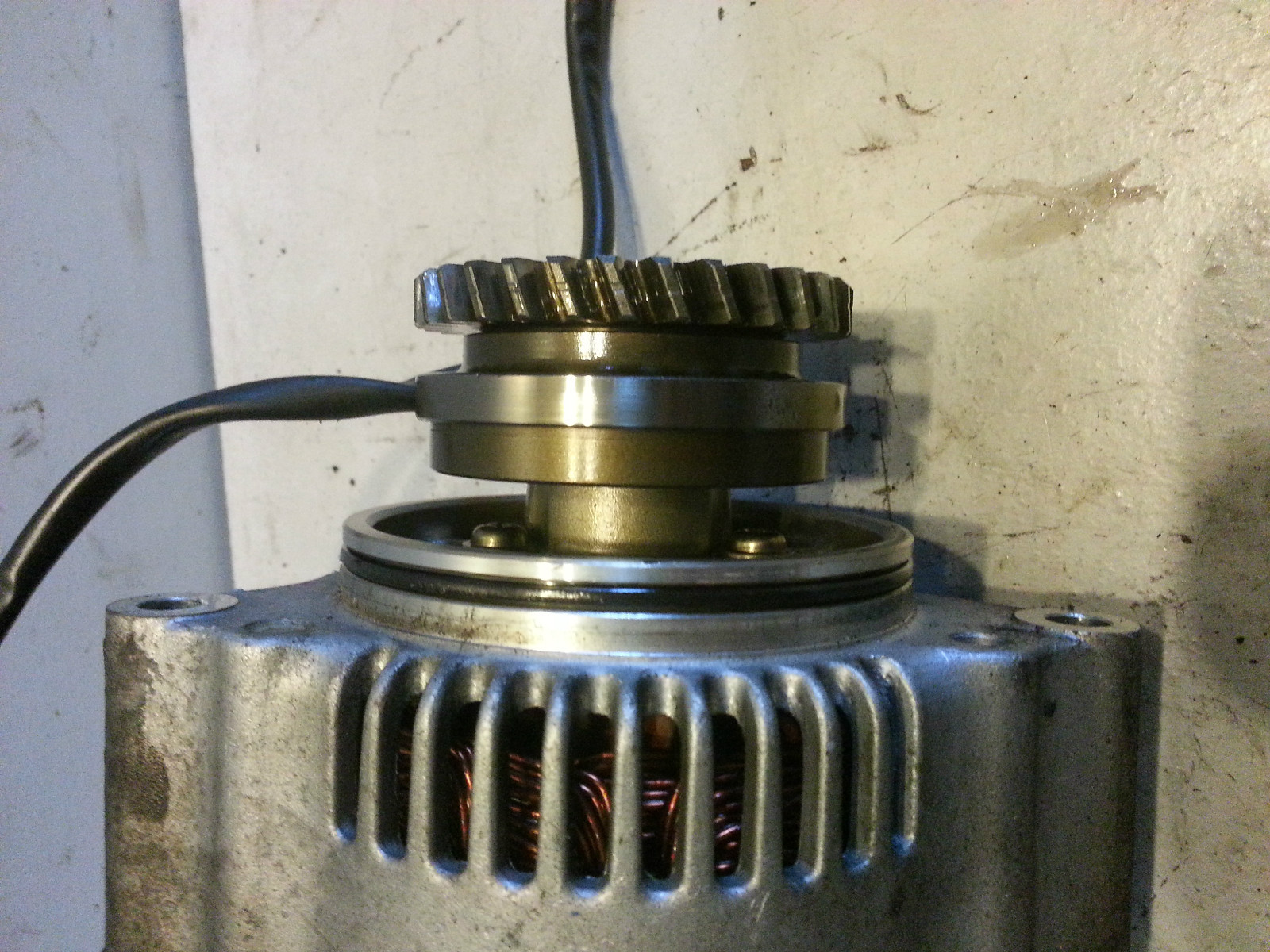

I use a Suzuki charger with a pulley brazed / welded to the output flange.
35A which is almost 500W.
Approx. £25 so cheap and plentiful on the 2nd hand market.
They need two wires one to the battery and one to the ignition supply.

Looks like found a Suzkie alternator as well. This Kubota had no alternator on it. Was not sure if a thread here in electronics was referring to a Suzuki car or motorcycle Alt. A PM from Petenpole seemed to say it was motorcycle. It was he that pointed me to one on EBAY. Money on the way to that seller for that now too.

Mouse..... I assume from another's comments that is a Suzukie motorcycle alt. and not a Suzukie car alt. Took gamble and bought Motorcycle one off ebay, pointed out to me by Petenpol. It's unknown condition.....Mouse wrote:I use a Suzuki charger with a pulley brazed / welded to the output flange.
The one on ebay has a gear attached. Does it pull off or did you cut it off orr?
Also the Katana 600 it comes from runs at a much higher RPM. Did you calculate the size of your pulley to keep the RPM's of the alternator similar?
Looks like an O-Ring on Alt. Does the Alt need a cap made to snap over the end to keep junk and water out?
Is it a Generator or Alternator thus needing something else to wire it up? Dc to Ac converter?

Re: Kubota Charging system from scratch
Yea, its from the larger GSX bikes. All the same as far as I can tell. I should have said but was a bit hung over when I wrote that.coachgeo wrote:Mouse..... I assume from another's comments that is a Suzukie motorcycle alt. and not a Suzukie car alt. Took gamble and bought Motorcycle one off ebay, pointed out to me by Petenpol. It's unknown condition.....
There is a cush-drive under the sprocket and that is held onto the alternator with a nut and taper shaft. See the photos....coachgeo wrote:The one on ebay has a gear attached. Does it pull off or did you cut it off orr?
.coachgeo wrote:Is it a Generator or Alternator thus needing something else to wire it up? Dc to Ac converter?
It is an alternator with integral rectifier and regulator. It is also easy to wire up as the thicker wire goes to the battery and the thinner goes to switched ignition.
I geared mine to somewhere between 2-3:1 because I had pulleys for that. I didn't aim to get it to be spinning as fast it would be in the bike and it worked with no problems. Also note that most petrol bikes don't spend much time at the top of their RPM range so I don't think there is much need to get the extra speed.coachgeo wrote:Also the Katana 600 it comes from runs at a much higher RPM. Did you calculate the size of your pulley to keep the RPM's of the alternatorimilar?
Yea, the oil ring is because the gear end of the alternator is inside the bike engine and needs the seal. I never bothered to waterproof any of it because the alternator is external to the engine and is generally exposed to water / salt and grit as standard. It is however behind the engine which would shield it a bit. The shaft bearing has double lip seals so they will keep the water out.coachgeo wrote:Looks like an O-Ring on Alt. Does the Alt need a cap made to snap over the end to keep junk and water out?
This is the back of the cushdrive and a small pully ( I think from a car alternator) with the centre hole enlarged to fit over the centre.
Then simply braze or weld it on.
Make your own mind up how to tension the belt. This is how I did it on the V twin but on the current Kubota Z482 I use a sliding idler wheel. (Note that the minimum radius a belt will work with is larger for a back side tensioner.)
Just be sure that the pullies are in alignment and there is sufficient adjustment for the belt to wear a bit. I found my local industrial bearing and pulley supplier helped me to select the right belt. I then bought spares from ebay

Well we're rolling now.
Figured out a way to use the Suzuki Alternator on the Kubota. Here's the little monster.
I took the Hub out of the middle of the Suzuki Generator
and turned it down on my lathe to where it is the same size as the bearing hole inside of the idler pulley on the right.
Almost there! Another 7 MM and it will be ready!
It will be an interference fit much like a starter ring gear on a flywheel. That should eliminate the alternator issue.
Best part is it will look like it came from the Factory this way!
I will make a bracket to fit to the underside of the Suzuki Alternator so I can bolt it up to the engine block where the idler pulley was. I want to examine the Idler Belt Pulley Tensioner and see if I can get that spring loaded contraption to work on the alternator without getting in the way. Would be cool to never have to adjust the belt tension until it breaks!!!
If not I'll use the standard slotted bracket for adjusting!
More in a few days!
A little lathe time and it's ready.
I cut down the hub to the exact same outer dimensions of the bearing.
You're going to love this. I was in the shop last night until Midnight working on this build and got up early this morning to fix a Mates Bike Issue. So after he bought lunch, he left and I got back on the Alternator mod. Since I was tired from last night I threw the hub into the freezer in my Motorhome and took a nap on it's couch. Then about an hour later I got up, hung the pulley on a coat hanger, dangled it in front of the blower furnace and heated it up. Got it nice and toasty. Just before the paint burned off the pulley I retrieved the Hub from the freezer and dropped it inside the pulley bearing hole and BINGO!
Let the parts reach room temperature and it is in there to stay. Nothing short of a 40,000 lb press will get it out now.
Front View. (I reinstalled the "C" clip just to see if it would go. So don't worry it's not holding anything together.)
Rear view.
Then bolted it back on the Alternator.
The pulley is as close as I can get it to the Alternator Housing without hitting. Going to need it close because the exhaust port is almost too close to the back of the Alternator. Since I'm putting the Alternator in where the Idler pulley was it needs to be compact.
Got a cool idea on the mounting system that I'll share with the Group once I'm sure it's going to work. It will be slick if it works.
Rear view.

Notch side.
Other side of Caps.
I'm cutting a mounting notch in the alternator for mounting the Alt low and close. And initial mock up shows the Alternator caps it to be a good swap.
One More Thing!
Oh and I wired the Suzuki Alt so it will plug into the Triumph wiring harness when we get to that point.
I'll be running the alternator to my Sub Contractor and get them to test the Katana Alternator to make sure it works. (Same Shop that rebuilt your Rabbit Starter George.)
