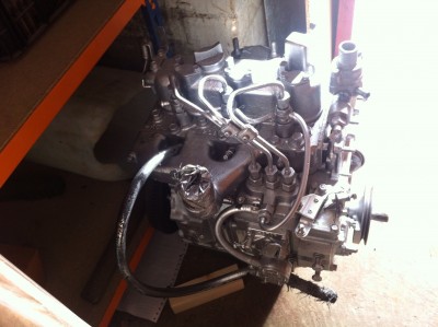

Before I get going on the MK5 I need to tell you about the MK4 , which is hot off the production line!, It ran for the first time on 1st Feb
It's a superdream 250 fitted with a kubota z482 500 cc twin cylinder . It's fitted with an RHB 31 turbocharger and intercooler. Transmission via CVT made by comet extracted for an Axiam micro car. Rear drive via tooth belt and pulley.
I have only driven it around the playground so far and its too early to report on performance . I have a non turbo version to compare it with. More news to follow.
I successfully failed to report the development of MK 4 so I will try harder on the next build MK5 which will start in the next few weeks , to be ready for the big knock event.

Kubota Honda MK 5
MK5 will be a Superdream fitted with a cvt transmission , toothed belt rear drive. The engine is a Kubota 3 cylinder 850cc engine. I have a concern if the total lager overall weight will still make it a good ride ?
I will try and plot its development as it unfolds ......... More to follow........

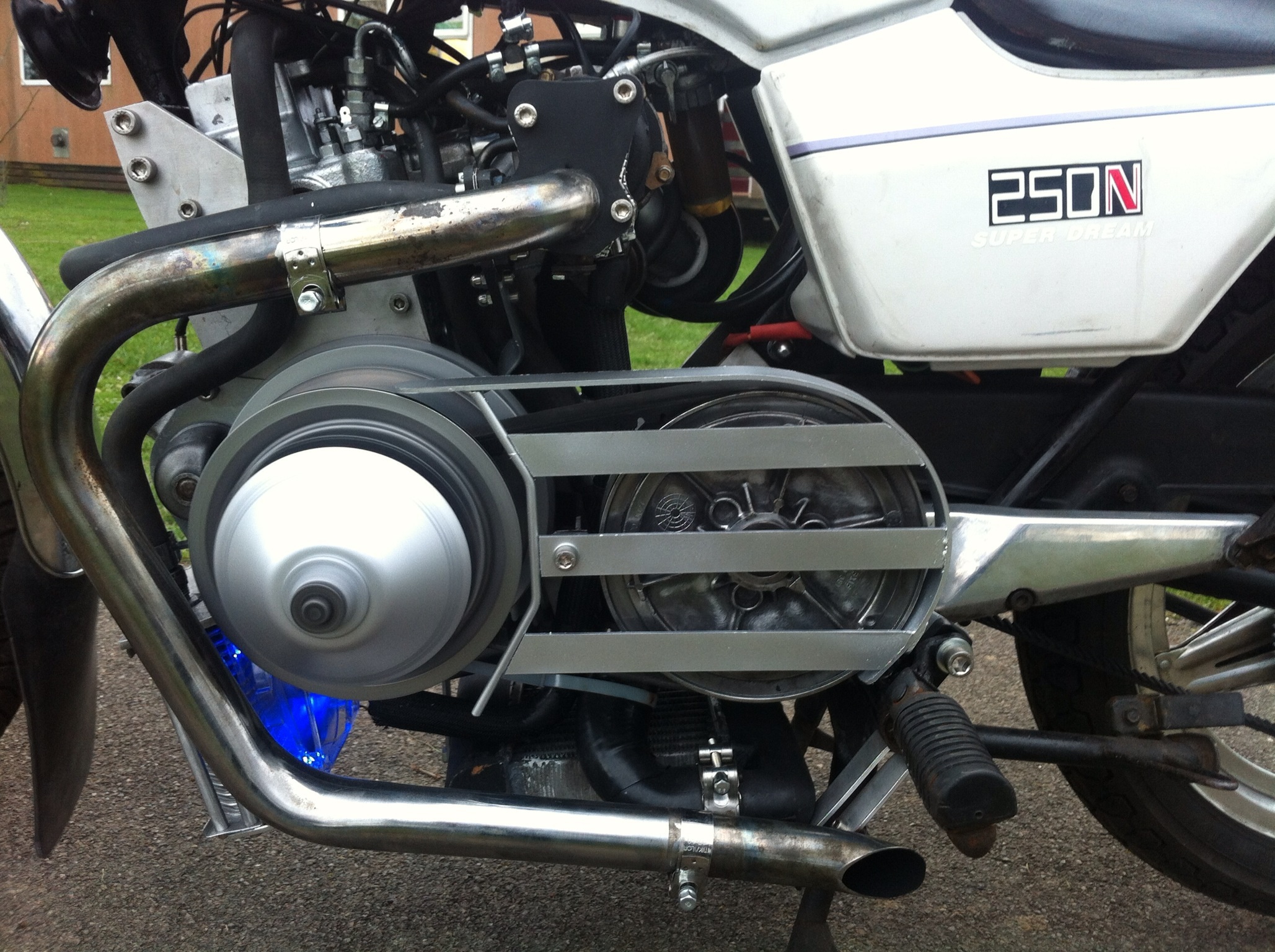

The MkIV looks very organic to me, perhaps even more so because of the exposed CVT. A shame you can't leave it like that or it will wrap your left trouser leg (and you'll be lucky if it's just the leg of your trousers) around itself.
Is there any way for you to design a CVT cover mimicking the optic of the naked CVT as closely as possible? If not from tin, then maybe a cover made from some sturdy yet transparent plastic, acryl, silicon? (All of this, of course, assuming you are building MkV from another Superdream and not from the MkIV.)

HiBlunt Eversmoke wrote:The MkIV looks very organic to me, perhaps even more so because of the exposed CVT. A shame you can't leave it like that or it will wrap your left trouser leg (and you'll be lucky if it's just the leg of your trousers) around itself.
I think your views are spot on, I aim to fabricate something along your lines of thinking tomorrow and will post up the results.
MK5 will made from another Superdream as I would like to make comparisons between a range of version!
Cheers Tim

Yay!
Looking good, both right (love the wood lol) and left side. Now for a cover for the front CVT pulley, you really should think about forming one from transparent acryl, and keep it as form-tight to the pulley as possible, so that will keep the puristic style.

Looks really really good Tim! You could produce theese on mass!
Re: Kubota Superdream Honda MK5 and MK4
Thanks both for the feedback I really appreciate it , and if you hadn't mentioned " an organic look" I wouldn't have thought of using of wood . I could investigate forming a acrylic transparent cover but I'm not a big fan of plastics. I guess if other persons want one it might be worth it . Also I am not sure if it would fit in the vacuum forming machine!
Cheers Tim
Disclaimer
Please note the bling blue lights on the radiator coollng fans are not by design, I forgot to remove them from the fans before fitting them and now I have to drain and remove the radiator to get to them.
Cheers Tim
