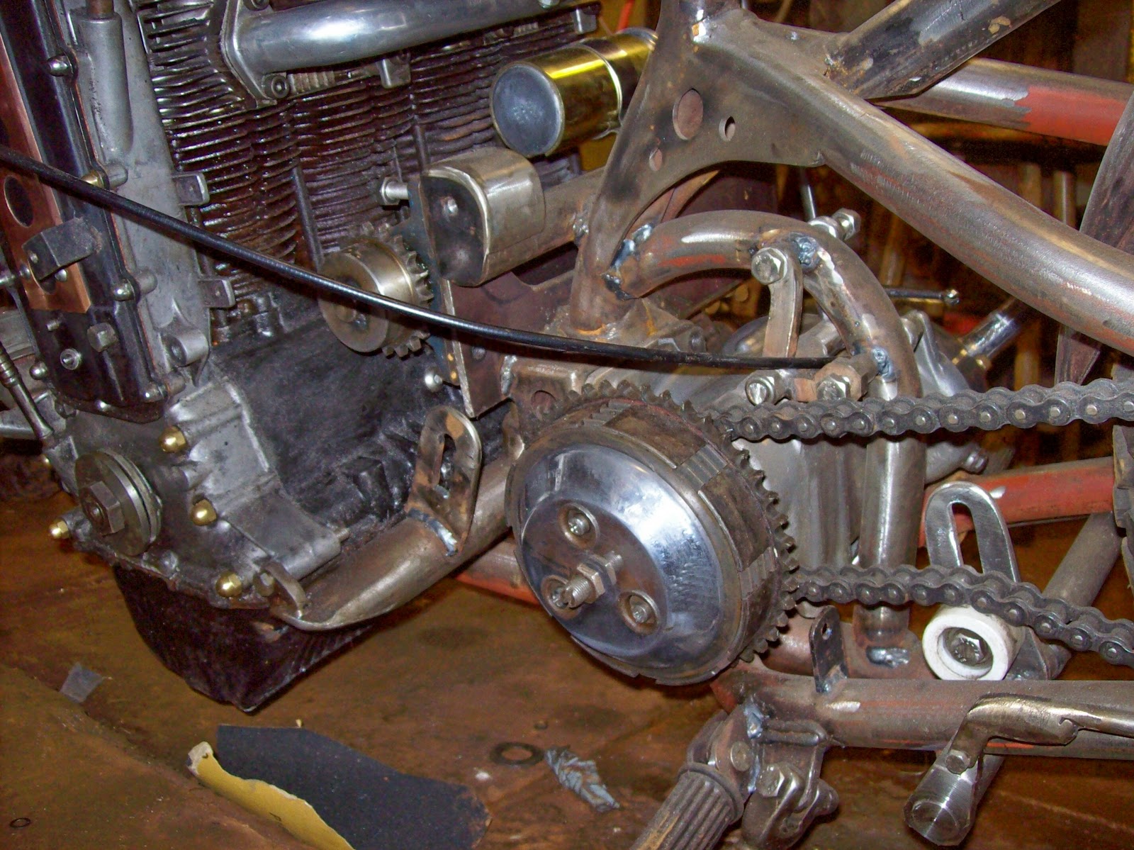

There's always Robbie's transverse NSU. Perhaps a far cry from your planned diesel, but it does provide an example of utilizing a jackshaft.
https://lh4.googleusercontent.com/-Sgni ... 0_1662.jpg
http://4.bp.blogspot.com/-ek-92tTZDUE/T ... 0_1649.jpg
http://1.bp.blogspot.com/-GSG2vjnECx0/T ... 0_1647.jpg
You can join the build (one of 2 I believe) somewhere here in the midst of his blog.
http://fumesngears.blogspot.com/2010/11/nsu-update.html

Thank you for that YouTube link. That engine was mounted lengthwise using some type of shaft setup.
Can anyone tell me with this will (or won't work)? Mount the engine in the frame as it would be mounted in a front wheel drive car (longitudinally) with the transmission attached (either auto or manual). Disable one the half shafts and mount the end of the other in a pillow block bearing so that it is perfectly parallel to the ground. Attach chain to half shaft, and then to some jackshaft arrangement because the engine/transmission will be so wide. Run drive chain to rear wheel. This way I can avoid an expensive transmission that may not be idea for the torque the diesel puts out.

This is from a post I made at the chopper compendium on the "trike building" thread , it will work for a two wheeler as well if you spool the diff and use one side to attach the rear drive sprocket to ! I would recommend outrigger bearings on all 4 sprocket ends !Sporticus wrote:Thank you for that YouTube link. That engine was mounted lengthwise using some type of shaft setup.
Should I be posting this outside the "member introductions" forum? Thanks for any and all advice.
Scott
If you have the complete engine/drive train package from a fwd car you could trike it in a different way by separating the trans from the engine complete with the fly wheel , as you create the frame build a plate to bolt the trans to that incorporates a shaft and bearing the carry the fly wheel and clutch on the one side and a sprocket on the other !
Set the engine in place across the frame . with the engine directly in front of the trans and placed as far forward as you wish you then need a jackshaft to connect the engine to the trans !
To clarify , the trans is moved from the end of the crank to a new position behind the engine with the fly wheel and clutch attached and the fly wheel end now at the timing end of the engine !
Chain drive from the crank to a jack shaft and also from the jack shaft to the trans input shaft !
You can separate the engine and transaxle as far as you wish and use the original irs if you choose but you WILL have to adjust the length of the half shafts (really not that difficult)
If any one has questions I will happily reply !
