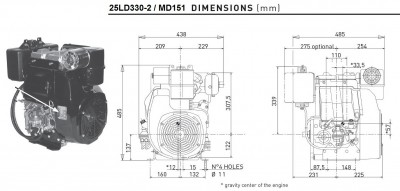

Nowadays it is the same engine as Kohler/Lombardini 25LD330-2 and it is a 650 cc version of the 850 cc version Ruggerini MD191/Lombardini 25LD425-2.

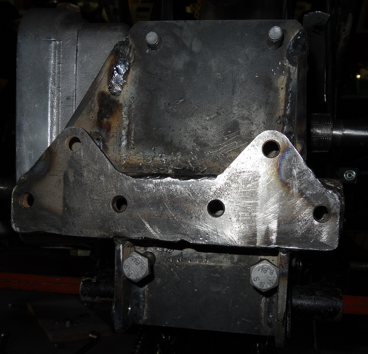

The big challenge is always to align the engine to clutch and to achieve adequate "round-the-engine" clearence.
The following pictures show my mounting fixtures between engine and gearbox, engine and downtube, enginehead and frame..
Square tube  38x40 mm  200 mm long fitted to engine. Later welded to the gearboxplate (5.6 mm thick).<br />The 6 hole engine plate 4 mm thick.

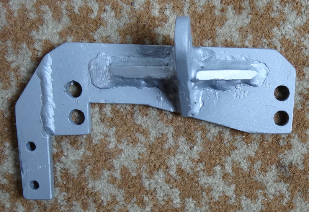

Fixture between gearbox and rear side of engine.<br />Made of 4mm and 5.6 mm steel plate and square tube, weight 2.5 kg

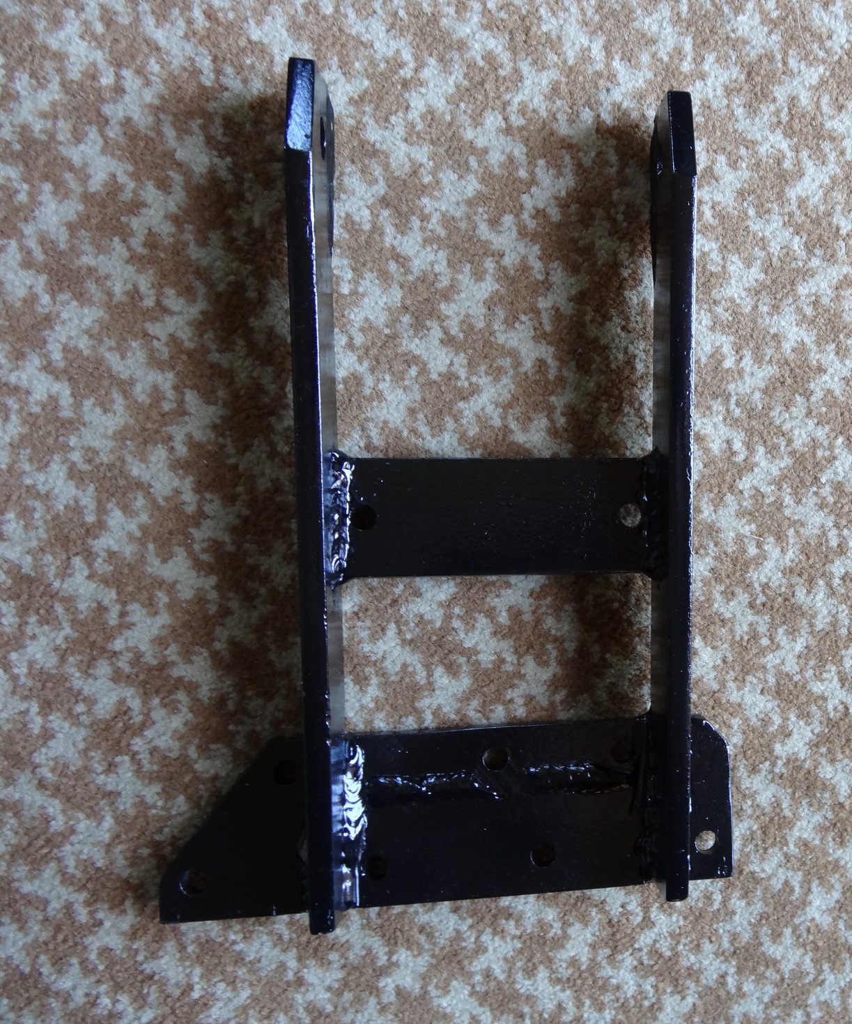

Frontadapter weight 1.9 kg
Engine head adapter. Connects to the Enfield frame with a rod, 25x115x5 mm piece of steel.<br />Made of 5 and 6 mm steel plate pieces, weight 0.4 kg.<br />The leftmost 2 holes are to fit the diesel filter

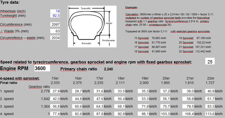

I looked at your shots of the bike on youtube..looks and sounds good..wondered about the shot of the speedo...am I going to get more performance than I am expecting? or is it a slightly optimistic speedo? Mildly concerned as I have an identical bit of kit in a box waiting to fit!
henneberg
Posts: 130
Location: Denmark
Re: Enfield with Ruggerini MD151
Post by henneberg »
Hi,
The speedo is approx. 12 % optimistic. :oops: I am using a 21 teeth gearbox sprocket, which should give approx 108 kmh topspeed, see table below.
The engine doesnt fire optimal at one of the cylinders, so when it is fixed, I presume it will pull to full rev with a 22 teeth gearbox sprocket.

witworth
Posts: 14
Joined: Tue Oct 23, 2012 2:52 pm
Location: Carlisle, Cumbria
Post by witworth »
Thanks. Great spreadsheet. That is a useful top speed which is enough to keep up with traffic. Im going to leave the standard 17T sprocket on for now. Lots of steep hills round here so will wait and see how it gets up them before changing any cogs. I saw that you are using a needle roller bearing in the support housing on the Taurus inner chain case. Wondered where that came from? I got one from HP here in the UK which is a phosphor bronze bush.

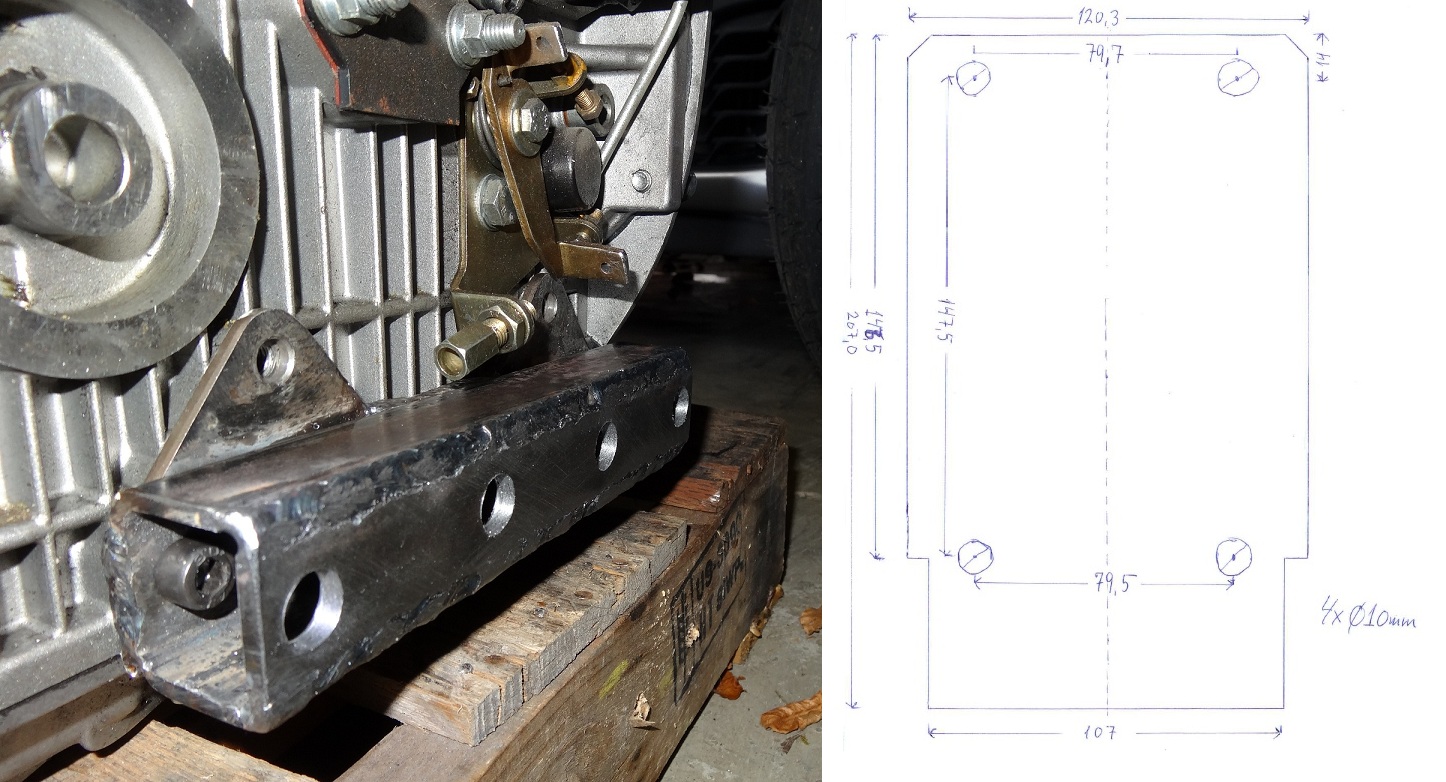

I wanted a better clutch support bearing than the HP bush bearing due to the engines 32 Nm torque.
I tried the bush bearing in my Yanmar build, it went hot and the bronze bush crashed the alu bearing housing !
Here is the bearing housing sketch with an oil seal 20x32x7. For now I have added a HP oil seal on the outside of the chain case !.
The 4 holes need to be drilled for the Allen screws to fit the Taurus inner chain case bush bearing mounting threads.
Link to roller bearing data: http://www.consbrgs.com/details/224/224_1_18.html

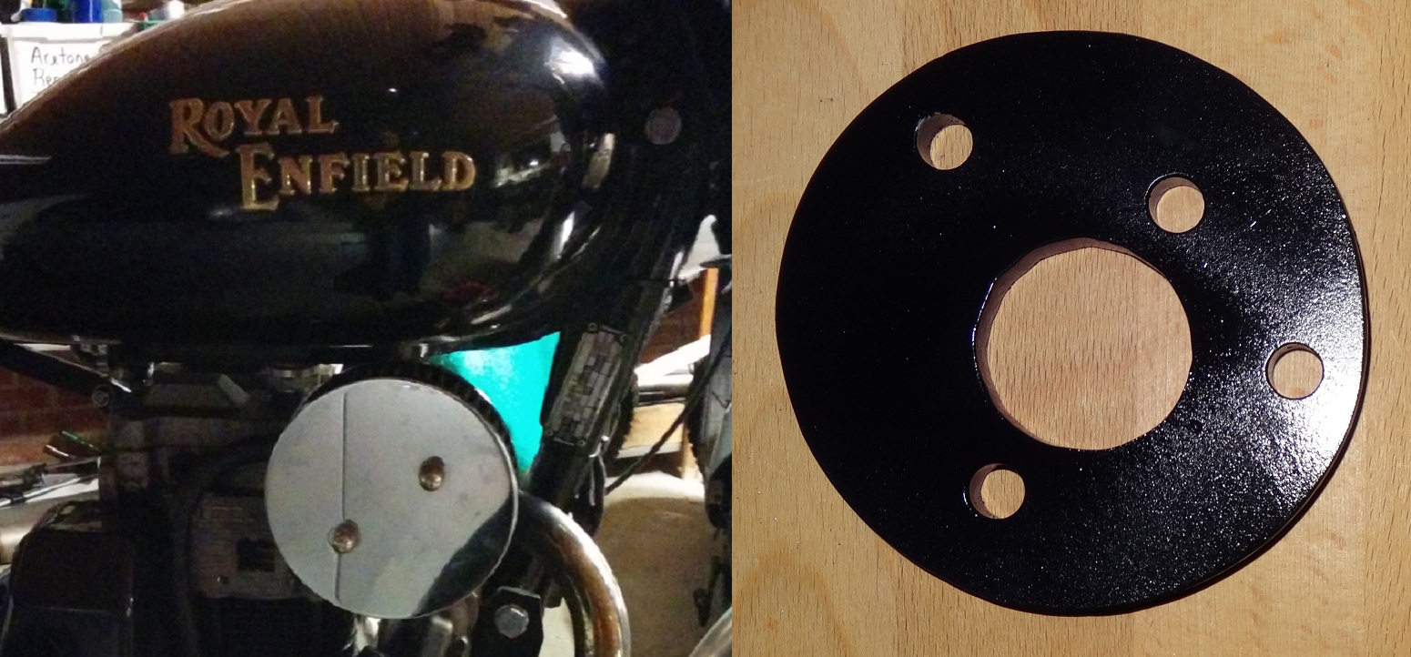

A KN SU airfilter is replacing the industrial filter, using a piece a steel plate "interface" the inlet to the SU filter:
