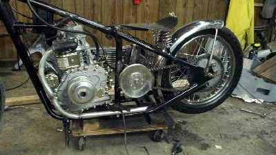

Hey folks, New to the forum here.
First I would like to say I attempted to register here a month ago but that "what bike is commonly used for conversion" question got me hung up. Until today when it hit me.. After seeing a few Royal Enfields I tried that one and here I am.
I started this project a month ago and it started a a 67 triumph bobber rolling chassis. I added motor mounts, jack shaft mounts and spacers, made a seat pan and hinge bracket, made the tank, made the tail/tag bracket, and wired her up.
