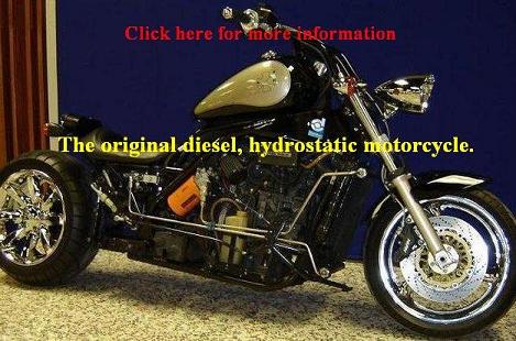

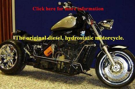

Posts: 2002
Re: Torque converter (car)
another example of hydrostatic
Racoon 2wd mini bike. Similar in concept to Rokon (2wd work horse/tractor..ish minibike on steroids)
http://www.hydraulicinnovations.com/for ... f5c5c&t=18
Same company, Diesel hydrostatic chopper, This video gives a good bit of details (least the opening of the vid says it does)
http://www.youtube.com/watch?v=t6G_YrGugug
Others from Hydraulic Innovations
http://www.hydraulicinnovations.com/for ... ht=chopper
