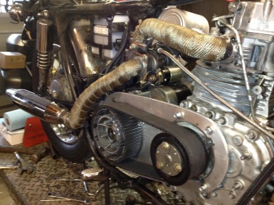

These are pictures of the Red Devil project that I began last spring. https://www.dieselbikeforum.com/view ... f=7&t=2323 After consulting with some of the people on this board I decided to go all in and turbocharge my Yanmar L100/CB350 project called the Red Devil. Before the turbocharging the bike ran pretty solid with a top speed of 55mph. In order to have a more street-able power-band, I retarded the injection timing by about .005" and even though the top speed performance was slightly compromised, it still performed well.
Today I just finished up the turbo installation (RHB31) and took it out for a test ride. Performance was rather anemic with about 50mph being the top speed. It seems to run dramatically smoother but appears to "hit the wall" and not want to push past. Low speed acceleration is rather poor also. I have a fuel stop that limits the amount of fuel you can dump into it past a certain throttle position. However, looking behind me as it struggles to get past 50mph, I assume that it is getting enough fuel by virtue of the fact the it is pumping quite a bit of black smoke at full throttle. Hooking it up to a pressure gauge at the wastegate port indicates that at full throttle (with no load) it is generating about 6-8psi of boost.
I have installed an intake plenum of about 1300cc and the exhaust pipe to the turbo is slightly oversize for the same reason of perhaps smoothing out the pulses. I've included some pictures. I was hoping for at least enough power to make 70mph but instead it appears that I have lost 5mph. I'm hesitant to advance the timing because low rpm knock is un-nerving. Any ideas?

Maybe reducing the diameter of the exhaust pipe going to the turbo slightly might increase the air speed of the exhaust gases acting on the impeller & thus speed it up?
This might make up for the lack of air hitting it, this being a single cylinder engine?
I'd imagine that getting these impellers up to a higher speed & keeping them there through the 4 stroke cycle of a single won't be easy. Perhaps experiment with internal rings of some sort until you strike a balance between air speed & a hole size that doesn't compromise the importance of the exhaust action over all.
That's all I can think of.

I've been going through everything to give me a "seat of the pants comparison." First, I took off the muffler (HD dyna, no restriction), no change. Then I disconnected the wastegate dashpot and checked my boost, up to 7-9psi when maxed out. Next, I disconnected the turbo at the intake manifold, basically running a straight intake. No change.
Honestly my first impression was that it felt like a restricted exhaust. The engine is now significantly quieter because of all this new plumbing. It feels as if the exhaust pressure is simply not overcoming the inertia required to spool up the turbine AND flow the exhaust gases efficiently.
How does one increase the exhaust flow without negating turbo function?

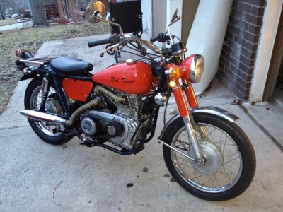

In order to give proper context, this is what the bike looks like. It is not a rat bike.

I'm impressed! Very nice workmanship and attention to detail, fine looking ride! Rats are cool but I like a class act to cruise around on if at all possible. Just shows more respect for the art of mechanical engineering, beyond the simple nuts & bolts of it! In a way our projects are a testimony to all those that went before us that it wasn't all a silly waste of time but rather there's a much larger thing going on, can't explain it. Well done there.

Before I added this turbo, I had the timing retarded slightly to give it better low rpm manners. When I would rev it to the governor in say 3rd or 4th gear it would misfire and pop a little as it topped out. 5th gear would hit 55mph but trying to go beyond that would just produce black smoke and no extra speed. With the turbo installed 3rd or 4th gear revs smoothly (but anemically) with no misfires but shift to 5th and it dogs down, billowing black smoke. When it is putting out 6-8psi of boost it sounds great, like it could rev forever. I think the internal of the engine have no problem dealing with turbocharging. However, it doesn't want to pull in 5th gear nearly as strong as it once did.

Sounds like turbo lag to me, and since its a manual trans. that small engine may never be able to overcome the lag. I would try to reconfigure the turbo with a straight pipe into the intake and straight pipe out the turbine see what happens.
Think of the "turbo manifold" you built as being a paper towel roll then have a 1/2" tube, blow through the 1/2" at a pin wheel it will spin pretty fast, blow through the paper towel roll it will hardly spin because you do not have the ability to produce the cfm it takes. same as your undersized engine isnt producing the cfm it takes to spool the trubo causing lag.

Another thing you may notice is most others with this single cyl. engine and turbo are running a CVT and can keep the rpms close to redline at all times.

That could very well be however; I had it hooked up to a pressure gauge yesterday while riding and testing. At normal light to moderate throttle it was producing at the wastegate port, 2-3psi. Full throttle (in 3rd gear, 40mph) it would produce 7-9psi of boost. Overall however, it's performance was weaker than without the turbo. It won't hardly get out of it's own way in 5th gear.
With my obviously limited knowledge I conclude that 1) everything is hooked up correctly. 2) The compressor side is functioning in the way it should. Am I wrong in assuming that I simply have too much volume in my pre-turbo exhaust pipe therefore (perhaps) creating crazy pressure waves that hinder performance? Should I be looking for more precision in the exhaust volume? Intake (plenum) volume? AND....the big question, where and how would I come up with those numbers?

I have also noticed that the guys with cvt's can simply pin the throttle in the church parking lot and wait for turbo magic. I think that a manual transmission is overall a lot more versatile for real street applications. However there is the challenge. Is there a way to tune these turbo's so I give up some on the top of the rpm range to have more useful power a little lower?
