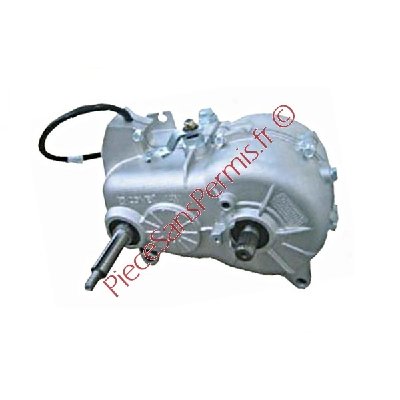

How does the Aixam CVT drive the rear wheels when its actually in the car? Are you going to have a belt drive to the back wheel?
Re: Kubota Honda
The aixam is front wheel drive. It has a gearbox that gives forward and reverse and a small diff to the drive shafts.I believe Tim is removing the gearbox and discarding it and mounting the rear pulley on a jack shaft. Mine is a 3/4" jack shaft. This is mounted on 2 pillow block bearings on a vertical steel plate and the final drive sprocket or pulley can be mounted on this shaft also.
It might be possible to keep the gearbox and lock up the diff and mount a sprocket on a drive shaft output?? but this would depend on available room and these gearboxes aren't known for being reliable :(
The gearbox is mounted vertically. The keyed shaft is on top with the driven pulley and the drive shafts are below.
