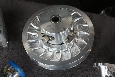

Conventional rubber belt systems use two systems to both load the belt and adjust the ratio. A set of centrifugal weights in the driving sheave forces the driving sheaves together as engine speed rises, tending in increase drive ratio. An helical cam on the driven sheaves tries to reduce the ratio when more torque is taken off the driven sheaves. This also results in higher pinching / gripping forces on the belt, which helps transmit the torque.
All in all the torque-cam system on the driven sheave isn't bad, but the centrifugal element on the driving sheave leaves a bit to be desired.
At low rpm it doesn't apply enough force to grip the belt properly, resulting in belt slip. At high rpms it applies too much grip, resulting in high belt crushing forces & deformation, reducing efficiency.
When used with a high revving petrol engined ski-doo or similar this belt slip is advantageous - rather like slipping the clutch to pull away on a 2-stroke, but used on a diesel application it could be rather frustrating.
It seemed to me that achieving a more optimal belt grip force at various conditions would improve belt life, and possibly reduce the diameters required to transmit the torque, so making things a bit more compact. Getting rid of the centrifugal mechanism would also reduce some of the bulk.

The system I arrived at used a front sheave pair whose separation was fixed by the rider. For "neutral" it was separated so far that the belt would no longer be gripped at all.
The rear sheaves used a set of torque ramps to apply the correct belt clamp force according to the torque load.
So, as the rider closed the front sheaves together the belt would drag slightly and start to apply a small torque to the rear sheave. This small torque would act on the torque ramps, bringing the rear sheaves closer together and starting to both clamp and tension the belt. This increases the grip and the front sheaves, applying more torque, and so it goes on until belt slippage stops and the torque is fully transmitted.
What I don't know is how smoothly this system would "pick-up", but I don't think it should be any more unruly than a conventional centrifugal system that would tend to oscillate.
This system would vary the sheave clamp force according to the belt grip required to transmit the torque at the rear sheaves. It would apply a smaller clamp force for less applied torque, so reducing belt crushing wear & transmission losses.
The actual applied clamp force would have to include a "margin of safety" to account for the larger clamp force required at the front sheaves in low ratios. The ratio would NOT try and change when torque or engine speed was increased or reduced - the ratio would be entirely controlled by the separation of the front sheaves, which is set by the rider.
The torque ramps on the rear sheaves would have both leading and trailing ramps such that when throttling off, the reversal of the appied torque at the driven sheave would still generate a belt clamp load.
The torque ramps would also have a variable angle. As the rear sheaves move closer together, the belt wrap angle increases, so the clamp force (for a given torque) at the rear sheaves can reduce. This requires a steeper ramp angle with less "wedging" effect. As the rear sheaves move further apart and the belt radius and wrap angle decrease, the clamp force required for a given torque increases. This requires a shallow ramp angle with more "wedging" effect.
The blend of applied torque to belt clamp force is a combination of the ramp angles and the diameter at which they act. If they are placed at a larger radius then the use less force to react a given torque so the belt clamp is reduced.

Well guess Im not understanding how CVT works as well as I thought, In particular the Driven/Secondary pulley. http://www.umaine.edu/MechEng/Peterson/ ... report.pdfBertTrack wrote:...Shall i make a vid of that explain the function? (CVtech)
So the Torque ramps are the slope's /Ramps that are cut into a cylinder that is part of one of the sheaves of the Driven/Secondary pulley. They play a part that push the sheves apart by RPM's centrifical forces causing (in this case) rollers to move up the ramp (against spirng forces) which spreads the sheaves? Did I get it?
...BertTrack wrote:...The two sheaves of the secondary can rotate on the radius. One side is directly connected to the output shaft and the other to a helix which increases or decreases the spring force of the secondary.When the pull (of the belt?) on the sheaves increases the spring will tighten up and push the belt up. Causing the ratio to rise. And the rpm of the engine to increase with the same rpm on the output shaft.
helix is the rising circular path of the ramps around the cylinder cut into it of one of the movable sheave's. Like threads in a bolt.
Think Im getting closer to understanding this.

Ah! If you look at your picture.
The rolls are connected to one of the plates. And the helix material to the other.
The power take off will be directly connected to one of the plates.
The two plates can rotate independently from one another until of course the rolls hit the end of the helix part.
As they rotate it will cause the spring on the secondary cvt to tighten or loosen.
A scooter cvt will not vary the secondary spring force. Which will allow the ratio to shift only based upon the rpm of the primary.
Where as with this secondary system the increase in torque needed (headwind) will allow the cvt to downshift and the rpm of the engine to increase while the output rpm doesn't change much.
