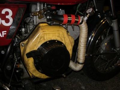

Here's a detail shot of the pump as it arrived:

I've finished the mounting, chain drive, and plumbing for the supercharger, and the results are very promising so far. I haven't regeared it to check the top speed, but the acceleration has seen a huge improvement. It also had the side effect of making the bike quieter by interrupting the intake noise. According to the pressure gauge I've attached, the pump produces from 1 to 3.5 psi of boost, more or less linearly as the engine speed increases. One of my local shops has a dyno in the back, so I will head over there one day soon to compare the power with and without the supercharger attached.

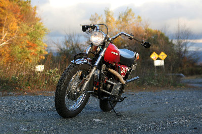

Its been awhile since the last post but here's an update. I've been prepping the bike for another year in Maine, and ran into some issues that needed to be addressed. As the weather got warmer, the supercharger began developing less and less boost. I was hoping I wouldn't have to spring for an intercooler, but I had to bite the bullet. I could not find any off-the-shelf models that would work, so I had a custom one made by Bell Intercoolers.
http://www.bellintercoolers.com/
Their build quality is top notch, and the prices are reasonable. Now, in hot weather the bike consistently makes 2-3 psi of boost when before it made almost none.

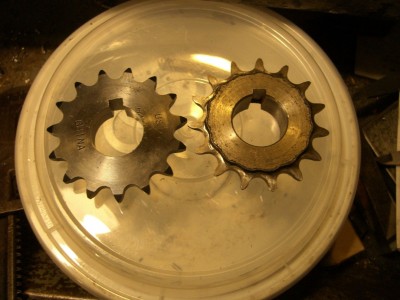

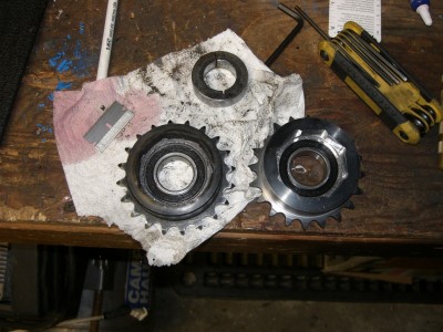

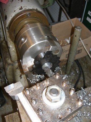

I also had to redesign and strengthen the sprag clutch. The most recent version lasted almost 850 miles before it wore out, so I made a new one with a thicker flange to last longer.

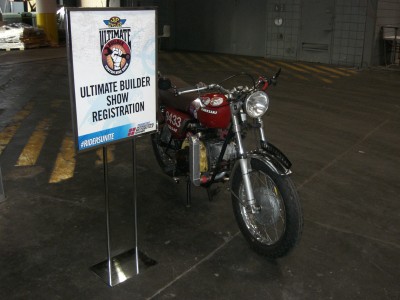

My KZ400 diesel motorcycle was accepted into the Ultimate Builder Competition at the 2014 New York International Motorcycle Show. It was an incredible experience, and I was honored to share floor space with some beautifully-built custom machinery. And surprise, I didn't bring the only diesel to the show! Below are pictures of the spectacular Kubota-powered bobber that took runner-up in the Freestyle category.
