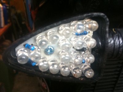

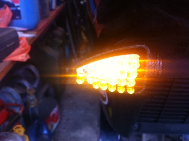

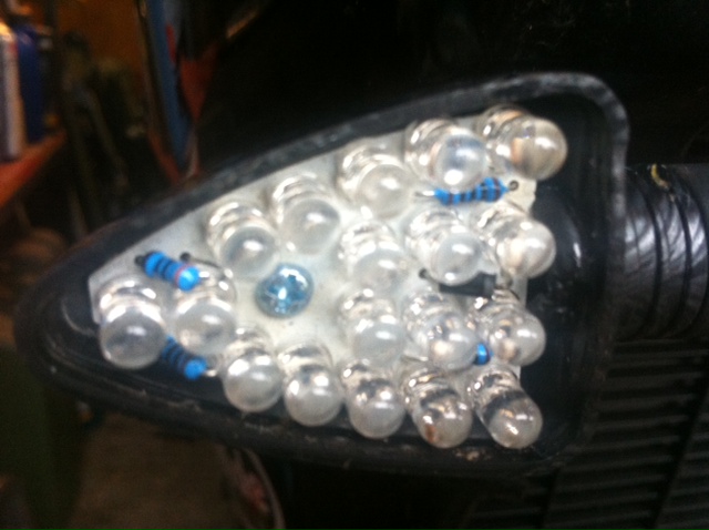

I chose some LED indicators to go on my Tiger but noticed recently about 5 individual LEDs had stopped working on one unit. I popped the circuit board out & saw one LED was loose! Turns out there was some bad soldering in there! I also suspect that the actual solder used was the Lead Free variety (joints not shiny). This stuff doesn't flow right, to my mind, & I suspect that over time, we may see it causing problems on other electrical & electronic parts.
I fixed this indicator with my soldering iron & good, old fashioned, leaded solder

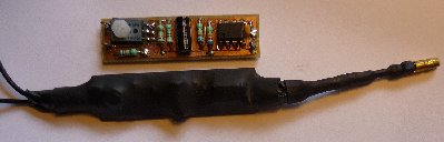

I have made ( with leaded solder wire ) the following small electronic indicator relay to mount inside the handlebar to control the indicators at the ends of the handlebar:
I can provide the schematics in case anyone have interest
