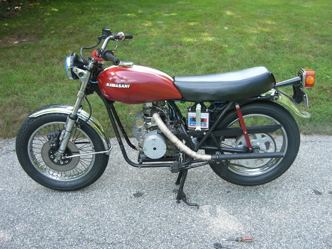

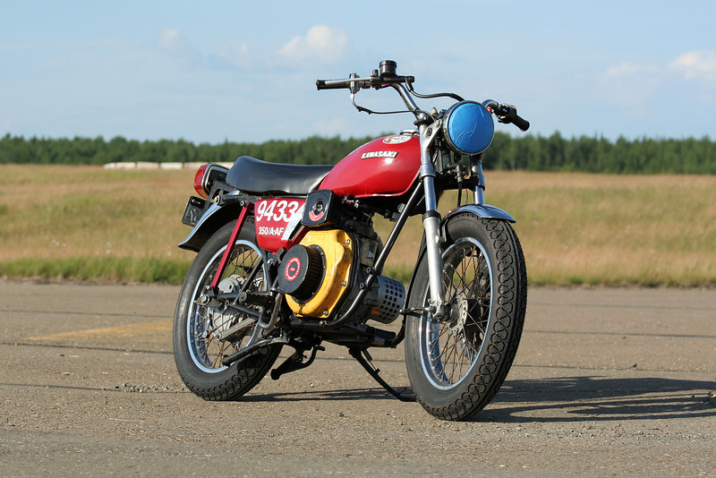

Nobody had set any records in their alternate fuel classes, so I prepped my single-speed Yanmar clone for the job. I figured it would be easy, just show up, race, and get a record, but it took me about 6 months to make it legal for the competition.

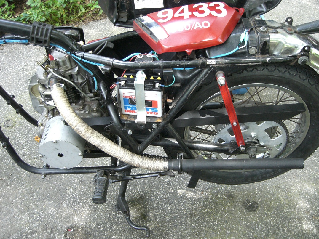

The bike after I upgraded the electricals with a dead man's switch (the lanyard on the left handlebar) and a proper exhaust system to "direct exhaust away from the racing surface". I used unbaffled straight pipes, and definetely noticed a major power increase.
The layout of the drivetrain after major modifications. I replaced the side panels andc converted them to number boards, made struts to replace the rear shocks and mounted a homemade aluminum chain guard (race requirement). I also added a smaller sprocket to up the top speed to 55ish, made a clutch cover, and added a smaller battery tta could be fastened with a metal strap.

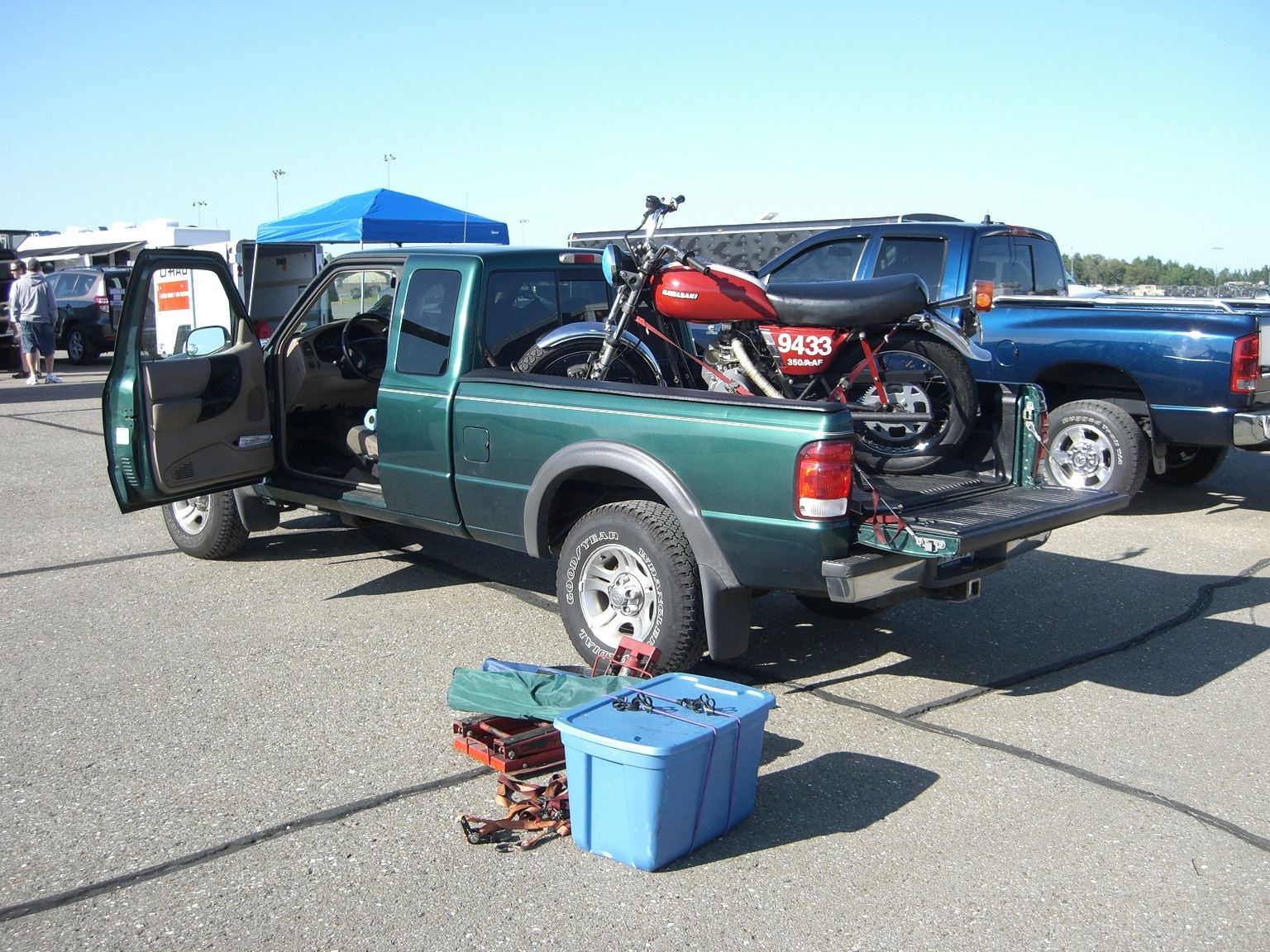

This is more or less the final configuration before I left for Maine

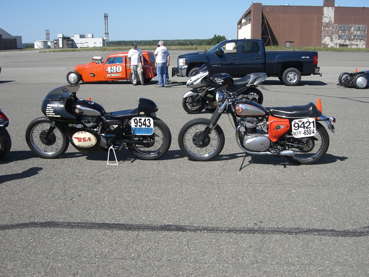

The mighty Ranger and the glorified mini bike at Loring.

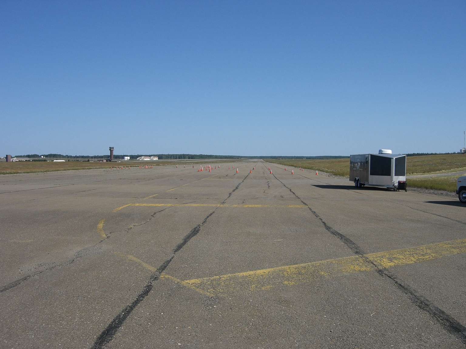

The return lane. This abandoned runway is supposedly the 14th longest in the world. The actual race course, 20 yards east, is 13th longest.

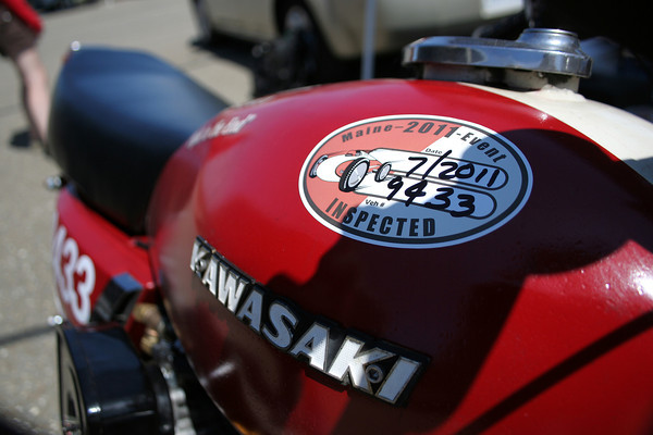

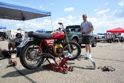

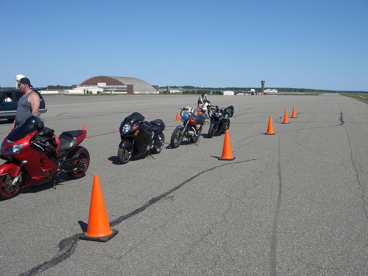

Waiting in Line at Tech Inspection
Not diesel, but beautiful.
PASSED!...with conditions
The didn't like my lock wire job, so I had to redo most of it (all of it, it sucked pretty bad)
Home base for the weekend. Some people brought massive motorhomes and trailers, we had an awning and a pickup bed.

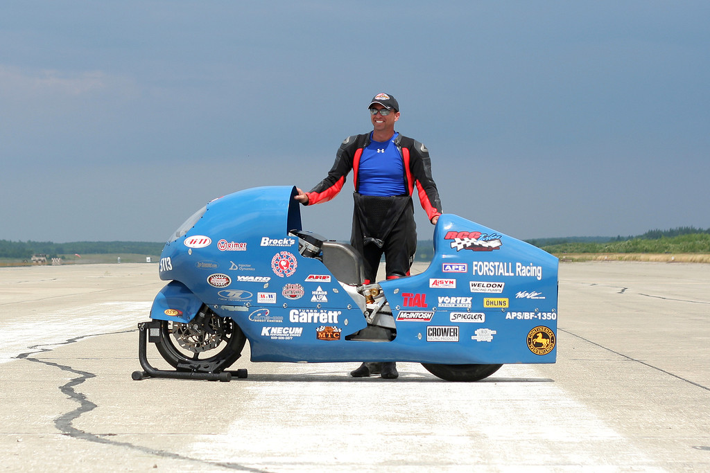

The gratuitous posed shot.

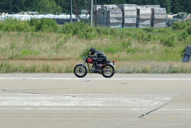

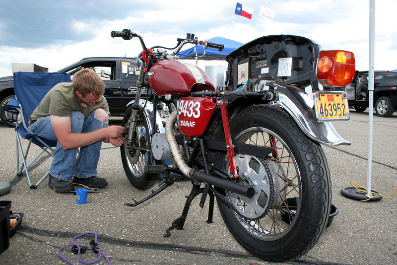

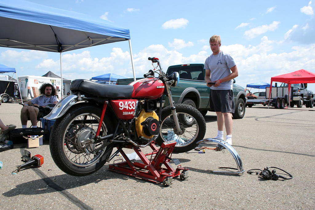

After a disappointing first pass (42 mph) we decided to take the axe to everything not required by the rules. goodbye fender, brakes, taillight, and airbox. All this paid off in the next run, when the bike hit 50.09 mph

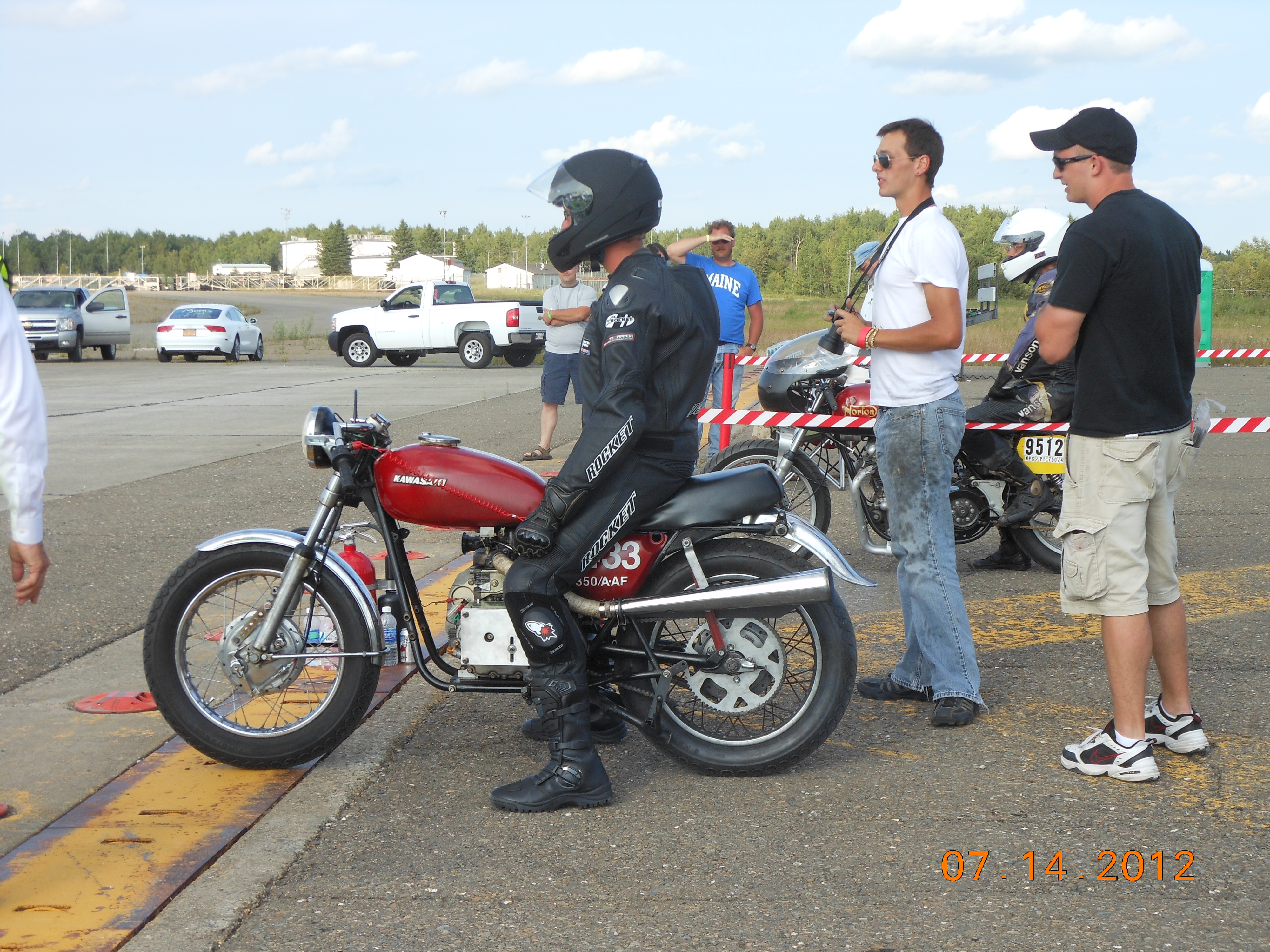

Lean and mean. My top speed, and the new record, is 56.5 mph in my final pass. I think the engine was running somewhere around 3700 rpm, so I should be able to increase that and improve a little next year

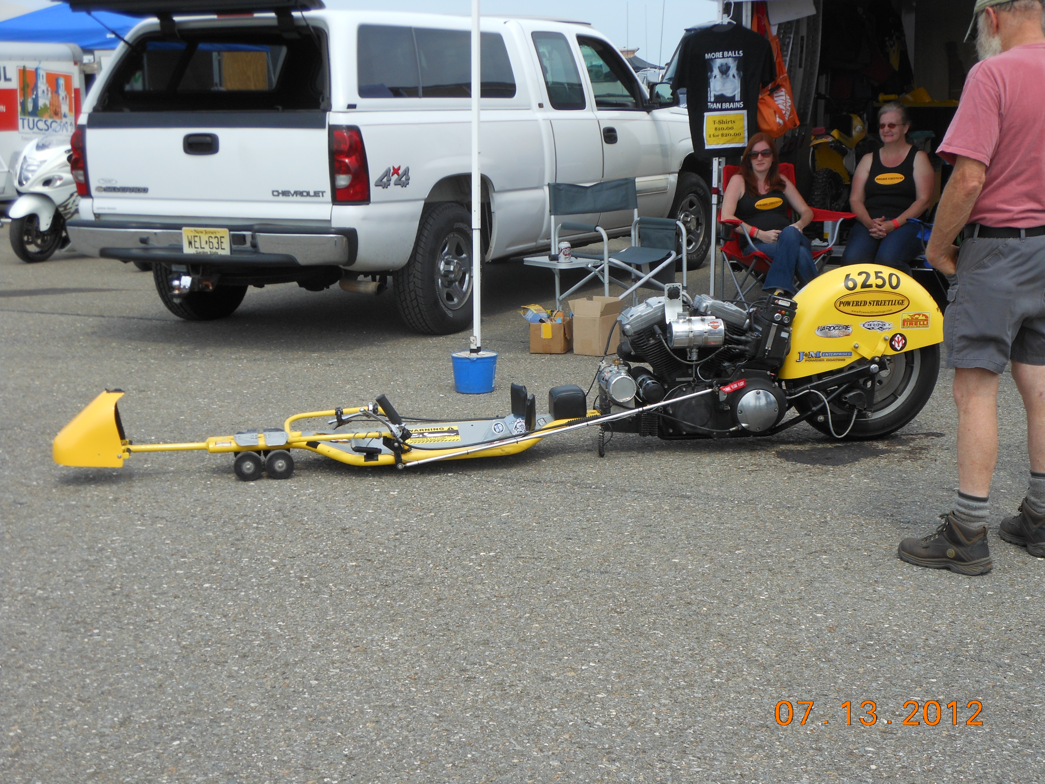

Also not a diesel, but this guy did 311 mph, so he gets a mention.

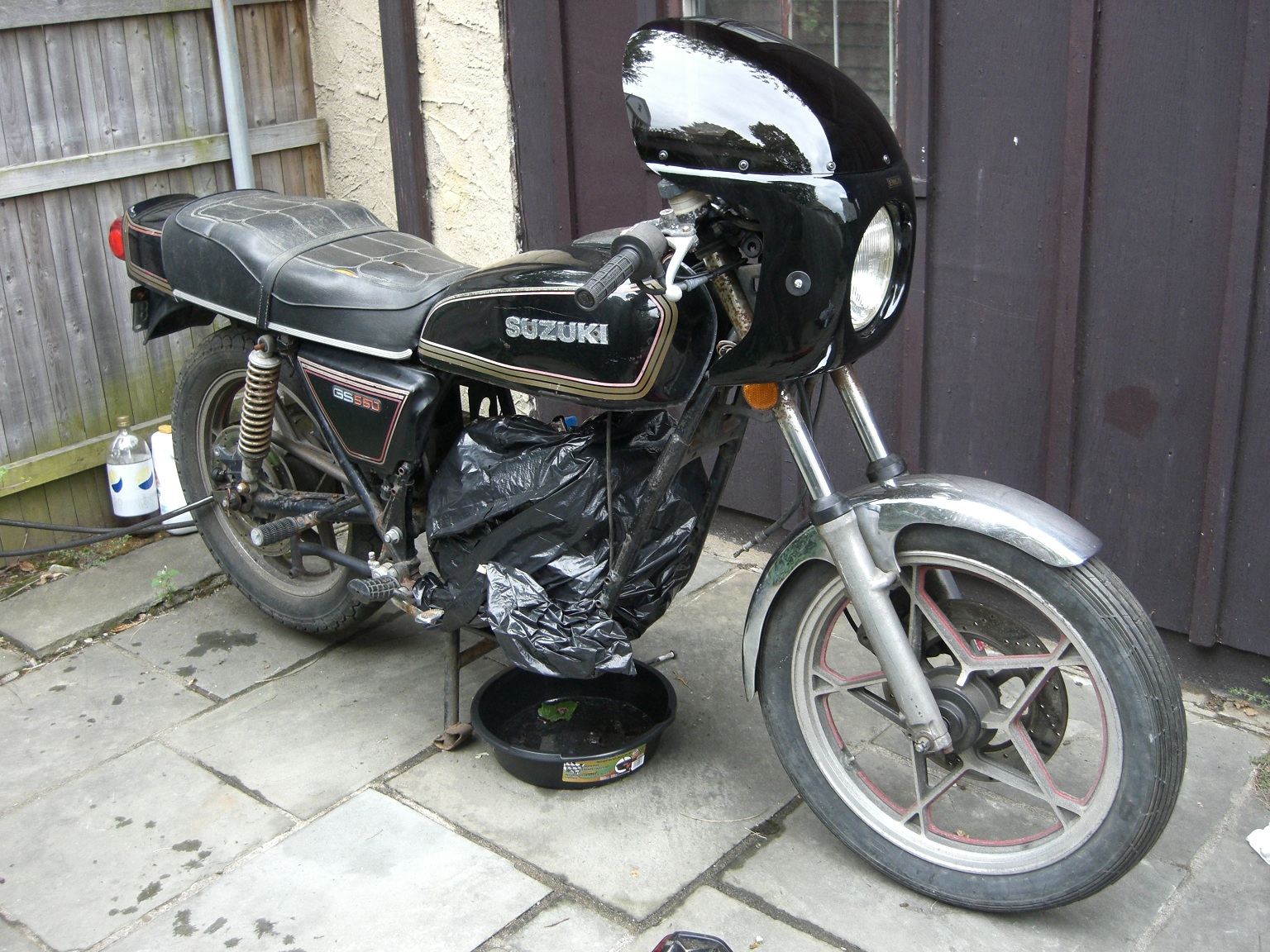

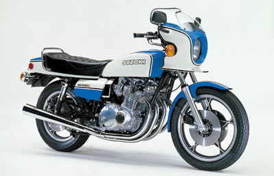

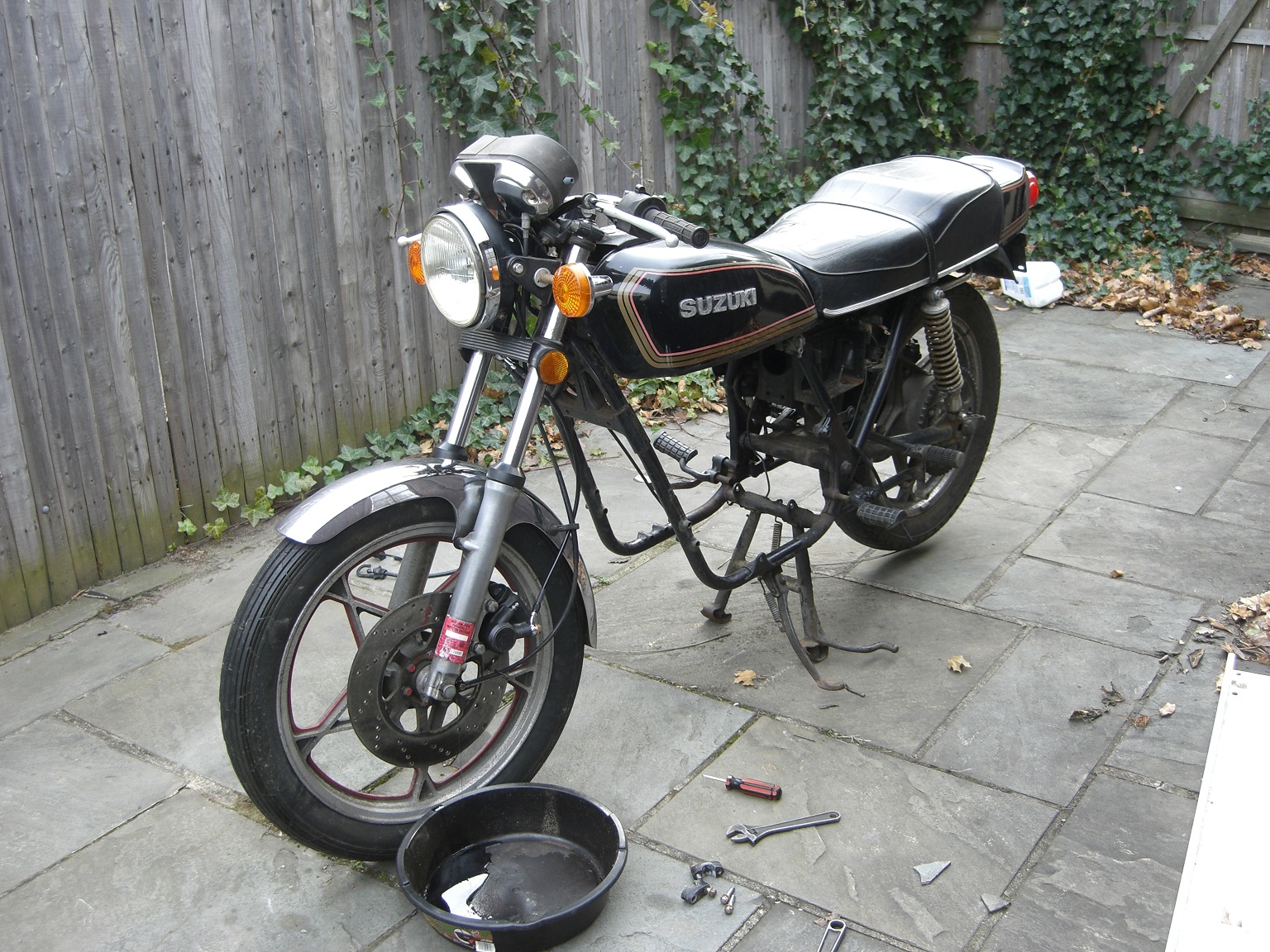

The next class up is partial streamlining, and that allows as much fiberglass as I want, as long as you can see my entire body from the side. I plan on running for the partially streamlined 500cc class next year with this:

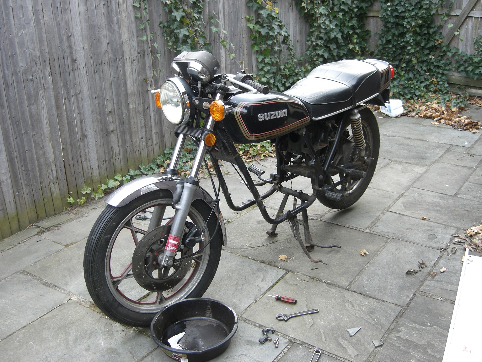

junkyard Suzuki GS550E. I think there is another post for it somewhere on this thread, but the project kinda got put on the back burner for a while. Now that the first one is "done", I think I'll start with this. I already have a little EMGO fairing that I might use.
i originally wanted to put on a 5 speed and stretch the frame, but they have pretty strict standards at the track and i want to keep as much of the original loop as possible. I think i can put on a CVT like Dougy's Harley and only have to modify the right downtube.
This is what it looks like in my head, we'll see if I can come close

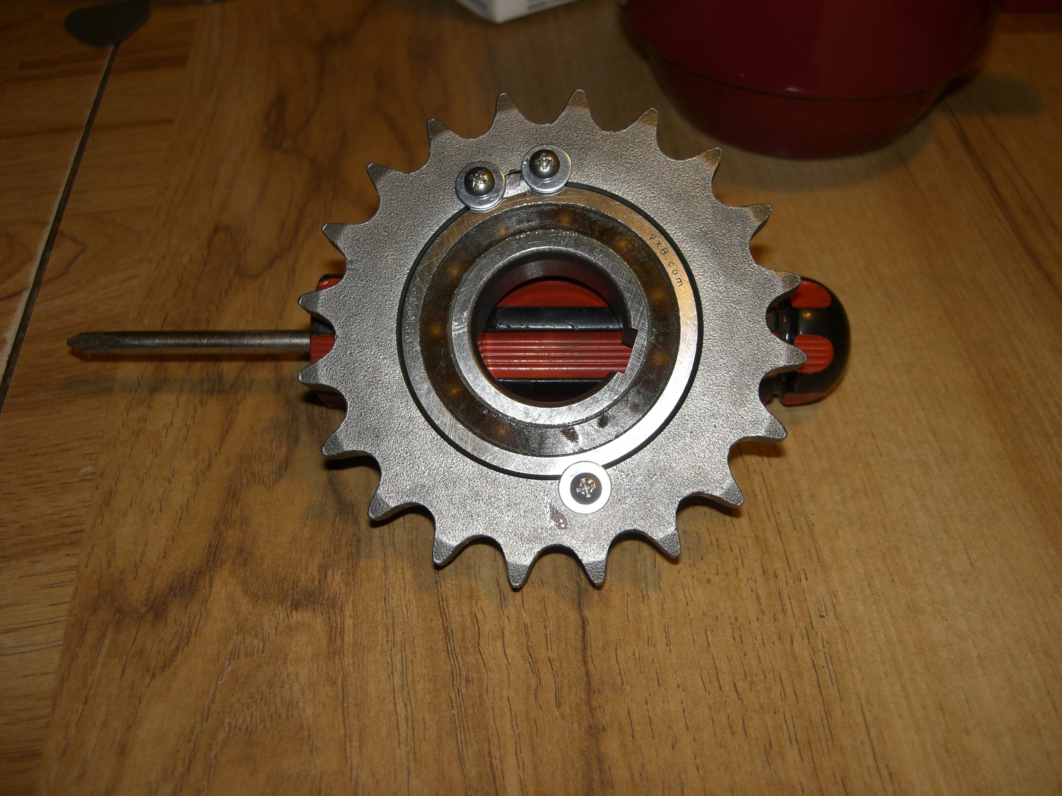

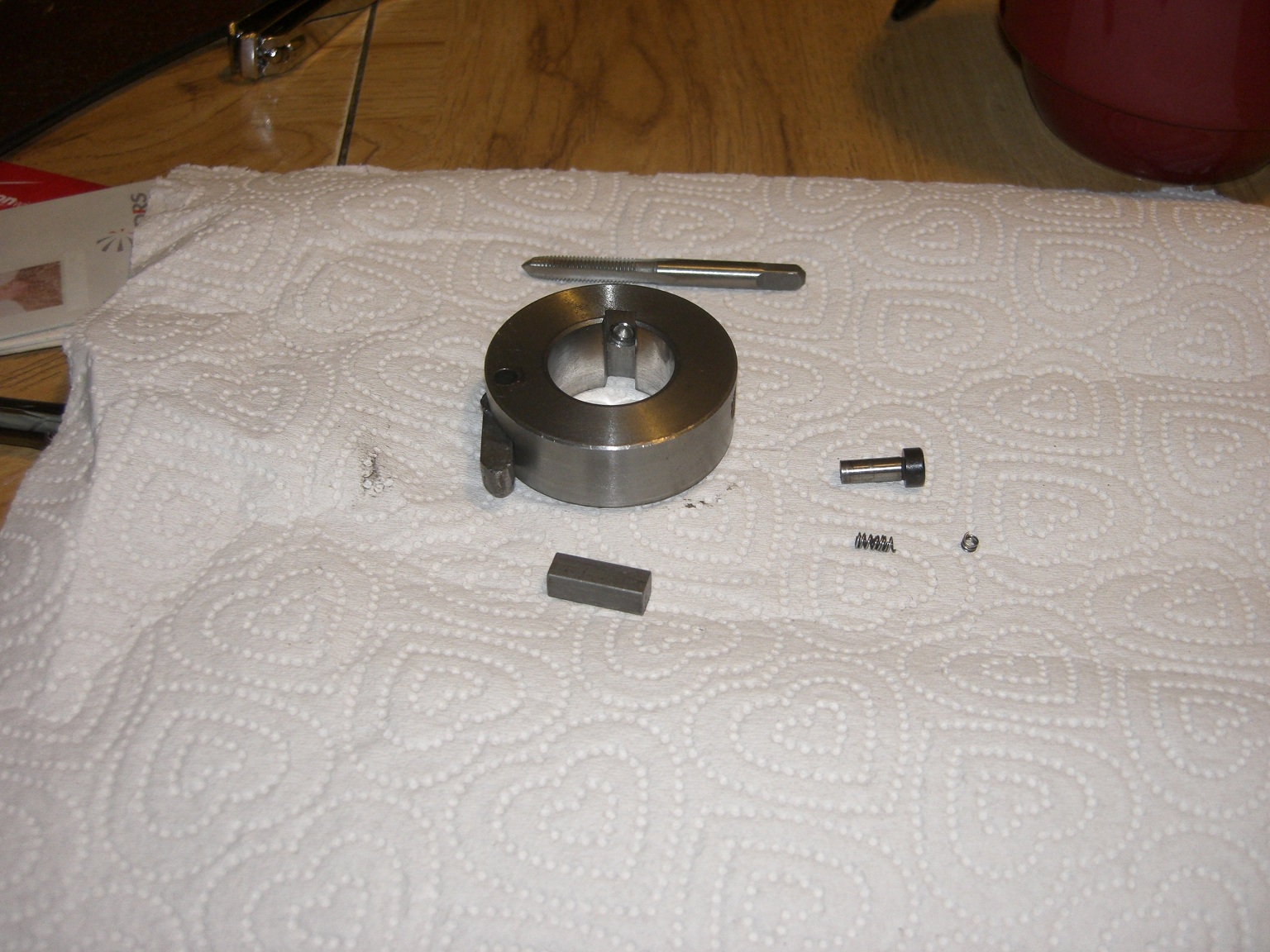

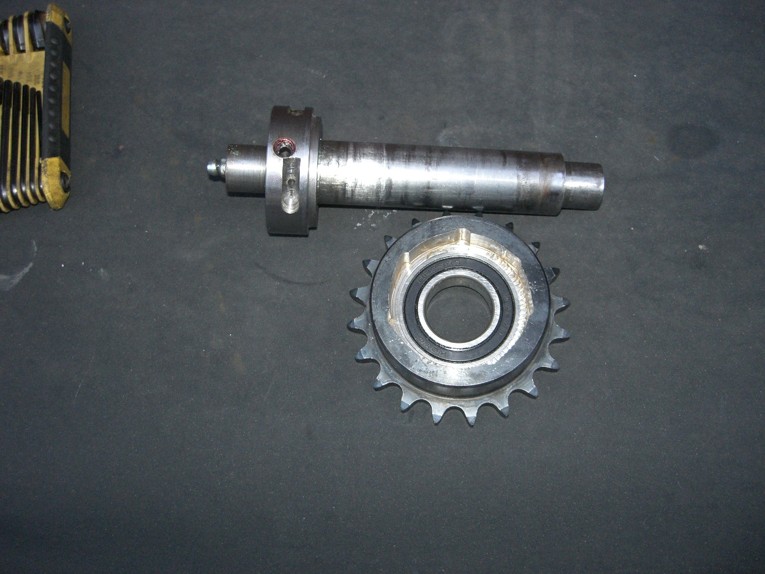

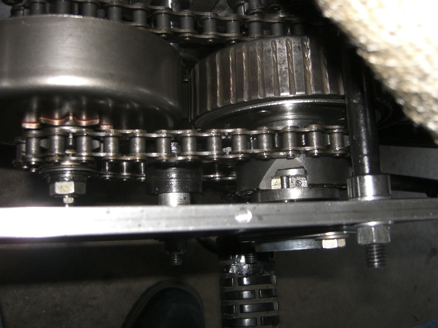

Just a quick status update on the project: I finished the two-speed, and it worked correctly for about 3 days.
Then I discovered that locking sprag bearings fail when they come into contact with grease containing moly, PTFE, or Graphite. Of course it wasn't labeled as containing any of these, but whatever. Long story short, wrecked the bearing, and had to come up with a homemade solution. I made a ratcheting gear on my 100 year old mill:
This worked well, and lasted long enough for me to record a video of the bike running with the new engine mods and exhaust system:
http://www.youtube.com/watch?v=v6N51KyR ... ature=plcp
Unfortunately, the shoulderscrew I used to locate the ratchet pawl failed and sheared off about an hour later. In addition, the return spring collapsed, and in an apparently unrelated event, the fuel cutoff solenoid on the pump failed. Only 3.5 months to go!

Note to self, don't use sintered steel sprockets in the future. Apparently they can't handle shock loads. The pawl punched a chunk of the ratchet sprocket right out during a test ride today. I'll remachine it from carbon steel this weekend.
On the plus side, the stronger pawl hinge bolt that I made was the only part of the assembly to survive

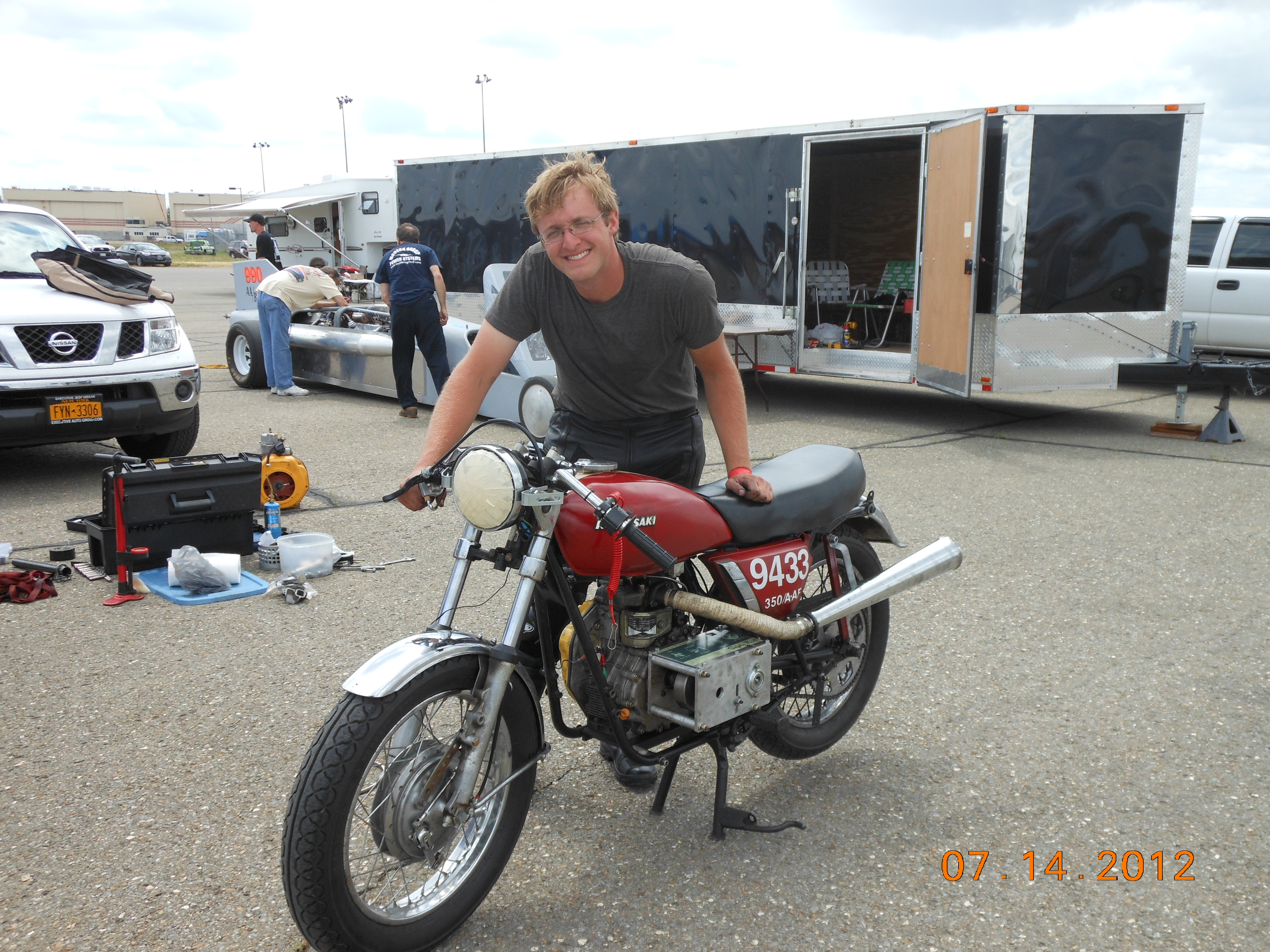

A quick update of my results for Land Speed Racing 2012:
Four New Records Set:
- A-AF/350-4 : 1 mile : 57.3
- A-AF/350-4 : 1.5 mile : 58.2
- APS-AF/350-4 : 1 mile : 59.0
- APS-AF/350-4 : 1.5 mile : 59.2
Engine Modifications:
- Stronger Valve Springs
- Ram Air Intake
- High Level Megaphone Exhaust
- Modified Governor
- Max RPM - 4500
http://www.youtube.com/watch?v=W3sX9x9A ... ature=plcp

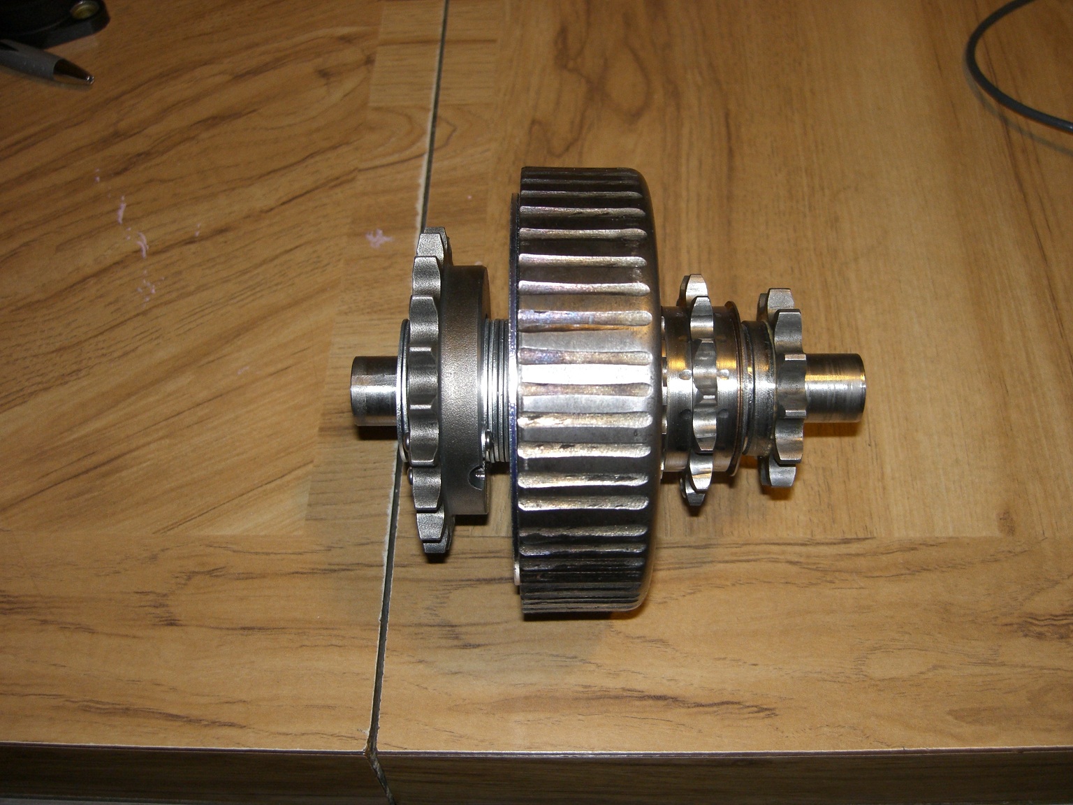

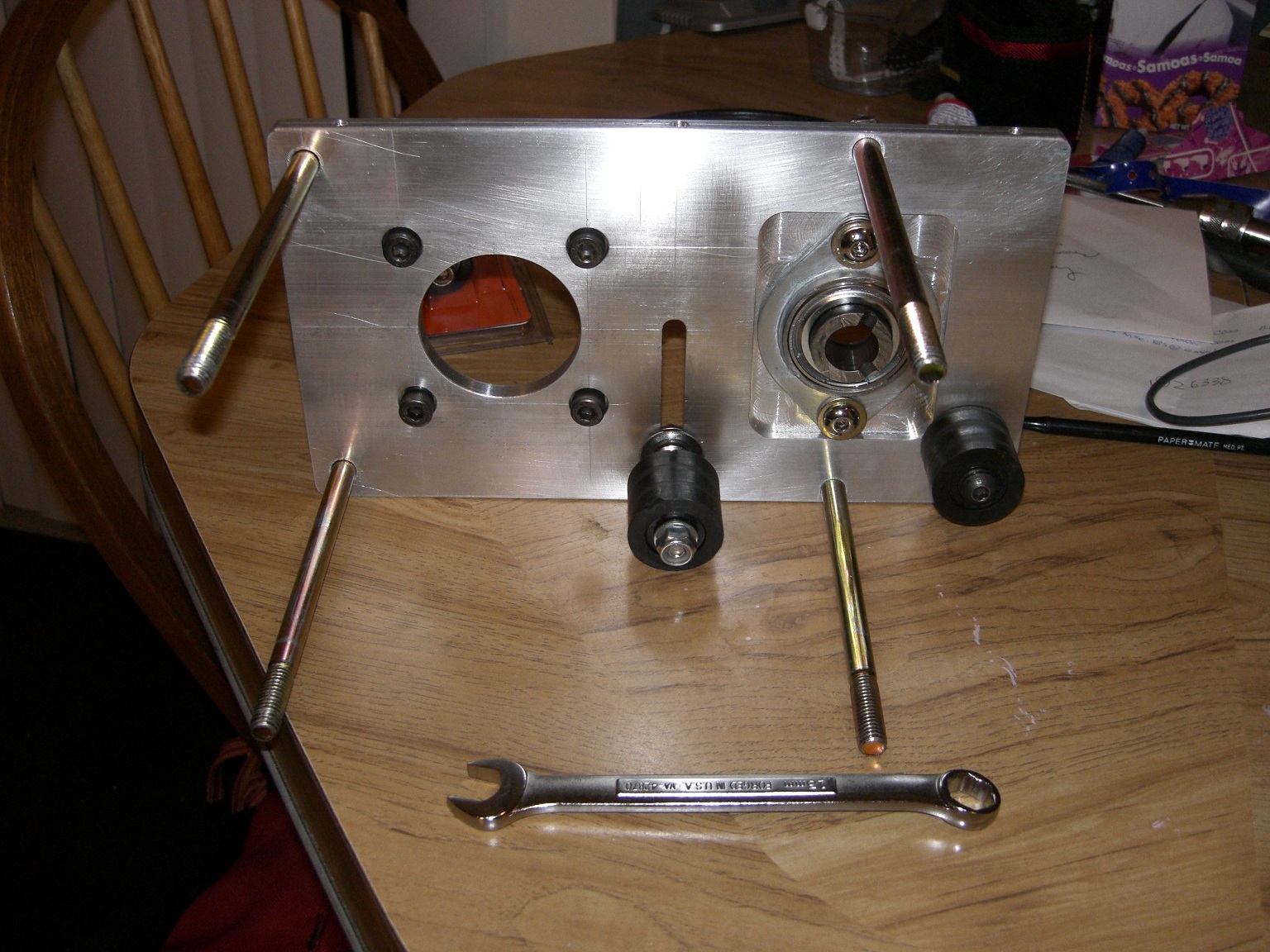

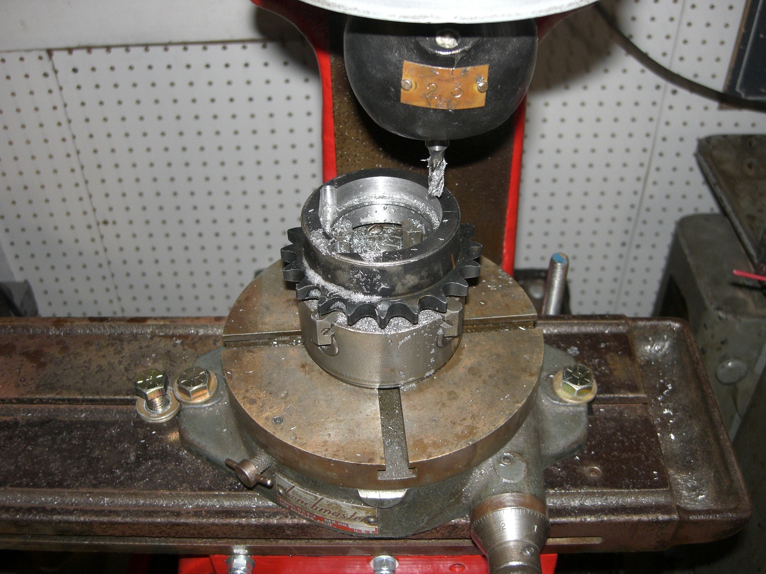

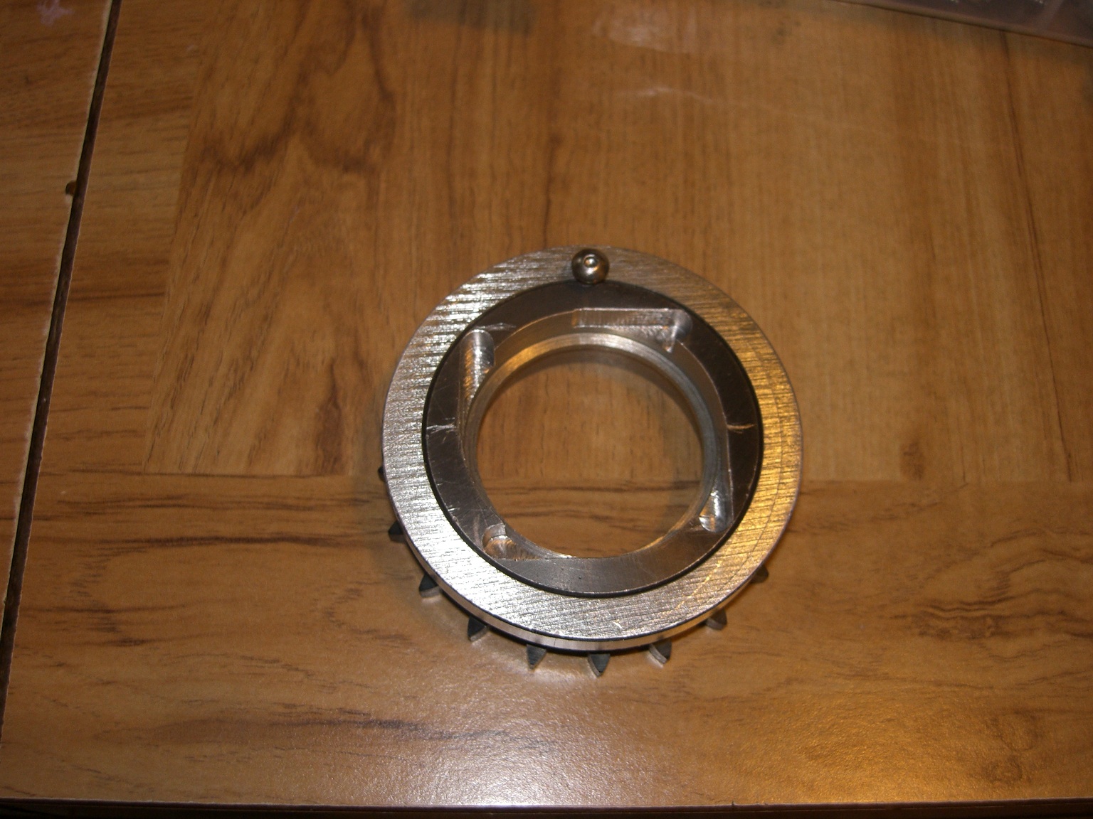

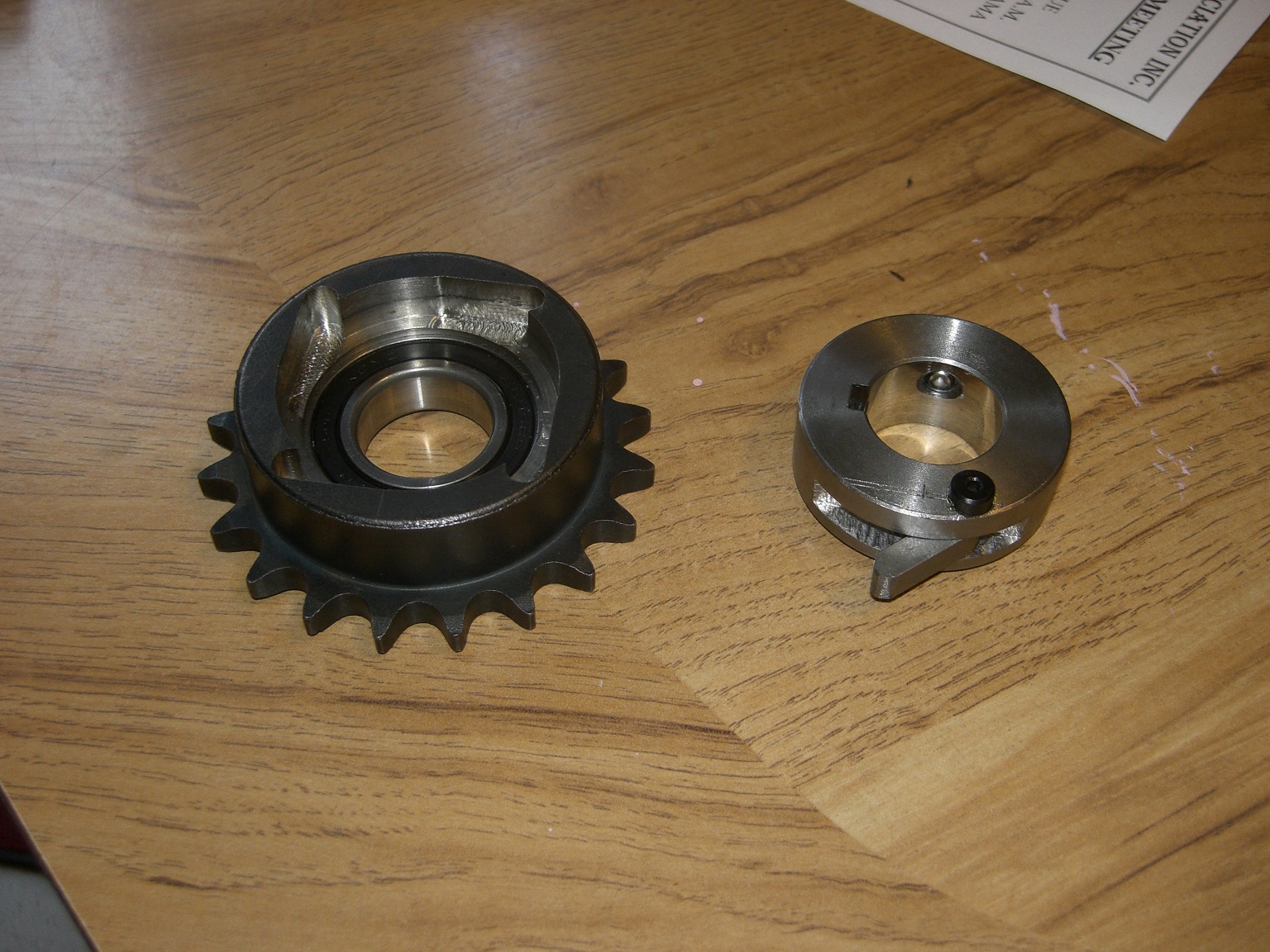

I finally have a chance to sit down and cover the last few months of updates. After blowing the second sprag sprocket design, I made a new one using a sprocket made of hardened tool steel, with a pressed-on ring to reinforce it.
This design still had a major flaw. The ratchet pawl had a habit of flattening out and mushrooming at the tip, which would prevent it from seating and cause it to break and lock the ratchet. I solved that by filing large chamfers on the sides of the contact edge, and oil hardening the parts, but this still needed to be rebuilt every 20-30 miles or so. This was good enough for racing, but I wanted to eventually use the bike on the road.
The final design uses four ball bearings that sit in ramps on the inner collar that is locked to the shaft. The sprocket has a series of shallow notches machined into its inner surface, and when it spins in the direction of the ramps, the balls roll into the notches and lock the parts together. So far, this design has lasted for over 100 miles without fault.
The last major change I made was to replace the ANSI Type 40 roller chain with SAE Type 420 O-ring chain. This is compatible with ANSI 41 sprockets, so I remachined the sprockets to the correct width. The regular chain was throwing off the grease too quickly and then seizing links, and O-ring chain will last longer.
I've also completed a full set of blueprints, the associated documentation, and a full costed out parts-list for this transmission design. If anyone is interested in making a copy of this design, or having parts manufactured by me for their project, you can PM me at John.W.Petsche@gmail.com. Cheers!
