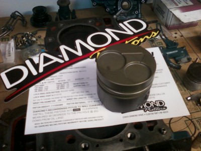

Building another 3cyl bike. Extensive engine work, going in a rigid frame bobber style bike. It will be 1000cc, turbocharged, around 100hp, turn 6000rpm, and blow the tire off.
Thats all the hints for now. Stay tuned.

This is a build for absolute performance, fuel consumption being a non issue. The injection pump will be delivering 3 times what was max fuel possible from the factory pump. Reground cam will make alot of power at 5000-6000rpm and designed for turbocharging. There is alot of work going into the engine to try and keep it together, and not turn the pistons into molten metal.

Here are a few more pics.
Injection pump with alot of internal modifications to flow a crazy amount of fuel. Injectors opened up to flow more fuel.
