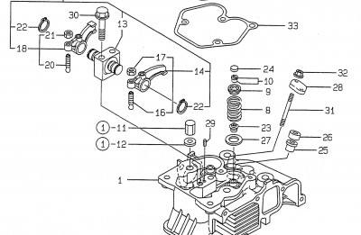

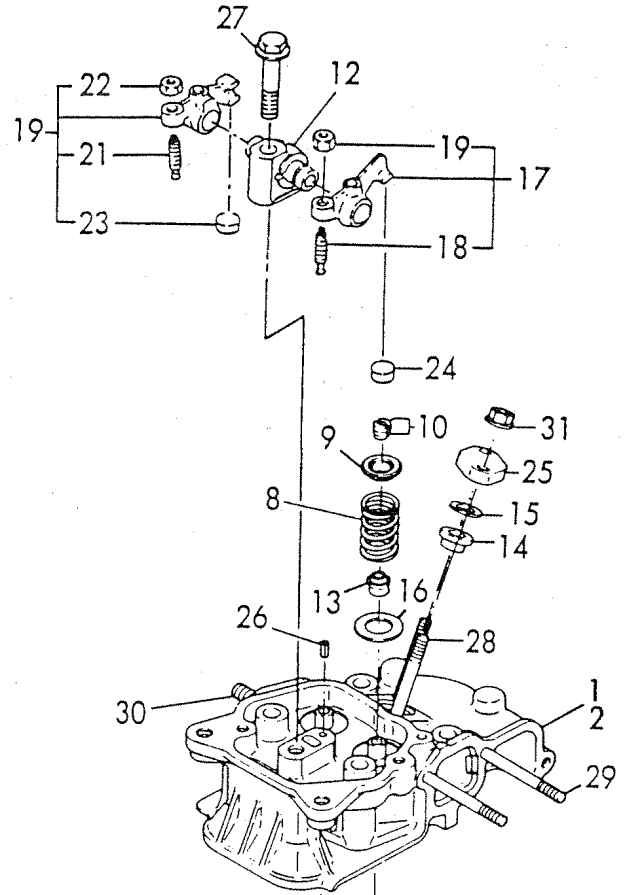

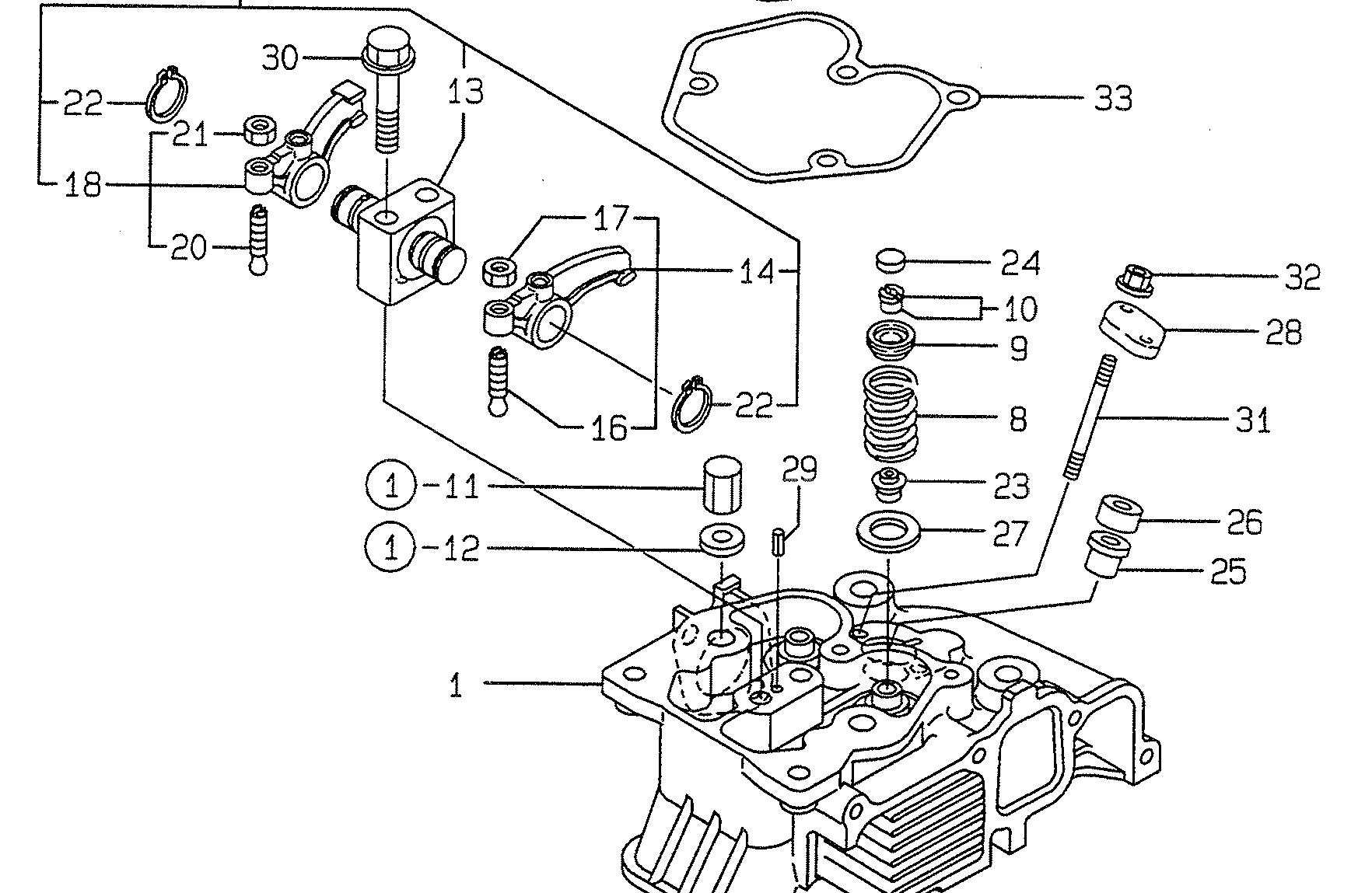

Instead of answering the specific question it appears I was only adding to our fund of knowledge (and perhaps confusion) regarding the Yanclones. Let's try this instead. From the official Yanmar manual come the 2 references below. The first is of the early LA series which clearly has the single bolt rocker restraint and the rocker shaft without circlips - evidence that your design indeed originates from Yanmar engineering. Clicking on the enlarged pic makes it a bit clearer.
The second is of the later EE/V series of the Yanmar L100 with the 2 bolt restraint and accompanying circlips. How the Chinese juggled those 2 designs in their subsequent manfacturing is anybody's guess.
