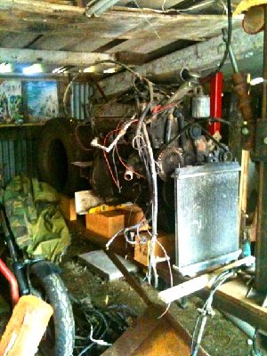

That barrel is a great heat exchanger!

What engine is it using?
Re: Whisker's New Build
It's from a large Merc van (as seen in BSH). Can't remember exactly what type tho. But I knew it would tickle your fancy there Mouse :wink:

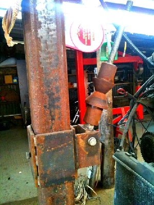

Another update. The workshop floor is finished and work has started on the bike now. The wheels you see are only for show - bike wheels will be used to finish it. Alternator has been moved and various bits moved or removed such as power steering pump etc. Also wooden dowls made to help align bevel box before the real thing was made.

The bevel box. There will be no gears.

Merc 2.3 Diesel lump.

Chris, the bevel box is from a saw mill. Because of that they reckon it will be able to take some abuse. If I were that bevel box sitting behind that engine I'd be trembling tho. It may well be tested to destruction :!:

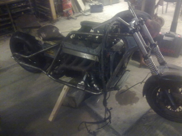

Here's the latest shots sent to me last night :D
The bike from the other side.
Whisker's on the bike.
Nice, whiskers has to be damn happy with that build 8) Like how the frame flows etc, thumbs up for me.
