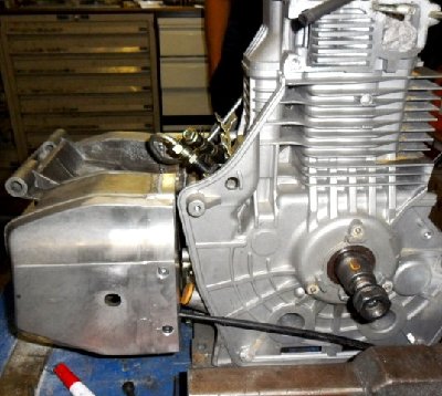

time for some more pics, since we've made some progress;
upper strut, this will add stiffness
front left mount, its welded all down the back :wink:
and here you can see how the aluminum part was machined;
http://www.youtube.com/watch?v=MgwiNoOPv0Y
later! :)

Hi, i'm inpressed that it fits all in the frame, and wonder what you will do with the flywheel, since the engine needs the weight of it for tickover and balancing out the blows, and wonder if the gearbox can cope with the diesel power.
Would like to see the result for real! maybe Hamm this year or sooner?

Very creative method of attaching the cylinder head to frame, should stiffen the bike up a good amount....you're not going to flex a clone engine. What gearbox are you using?

arnaud wrote:Hi, i'm inpressed that it fits all in the frame, and wonder what you will do with the flywheel, since the engine needs the weight of it for tickover and balancing out the blows, and wonder if the gearbox can cope with the diesel power.
hmm.... good point. completely missed that he no longer has a flywheel. hmmmm.....

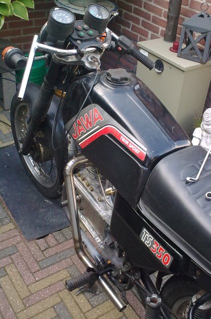

More important, the exhaust is nearing completion;

Your flying now mate, loving this build, the flywheel may be lighter but you've also added more flywheel weight in the transmission chain, clutch basket & plates ect so I think it should all balance out nicely, looks like a top quality job on that exhaust too ! :) MORE MORE :)

powerpack, quick 'jawa' shifting :wink:
its not as heavy as it looks.
and with the cover;
plan is to sandblast&''glasspearl'' (?) all the custom aluminium work

Looks like your nearly ready for the maiden voyage mate :) your right about the flywheel to, it looks like a lot of hours have gone into it.
