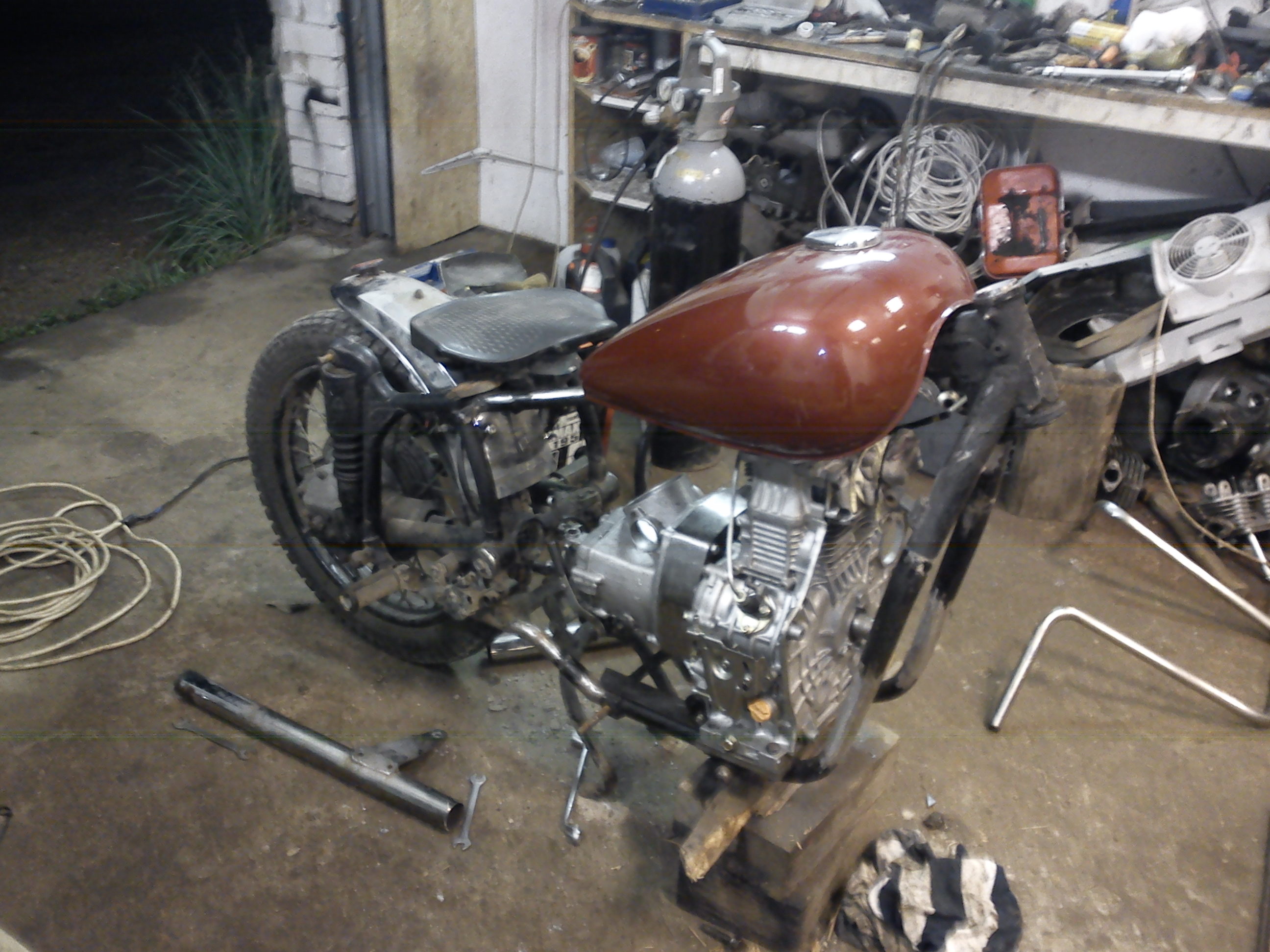

fittings to hold the Vulcan front fork:

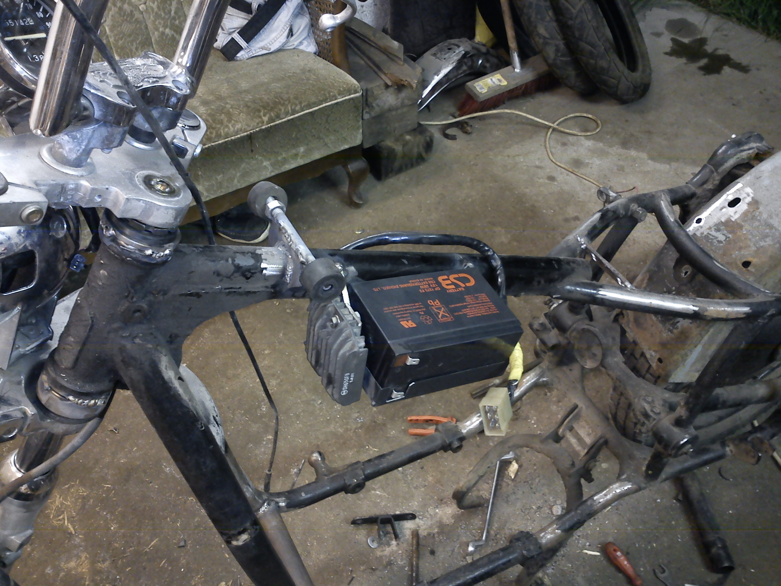

Lots of space under the gas tank to fit 7Ah battery and regulator/rectifier:
Accu box and regulator:

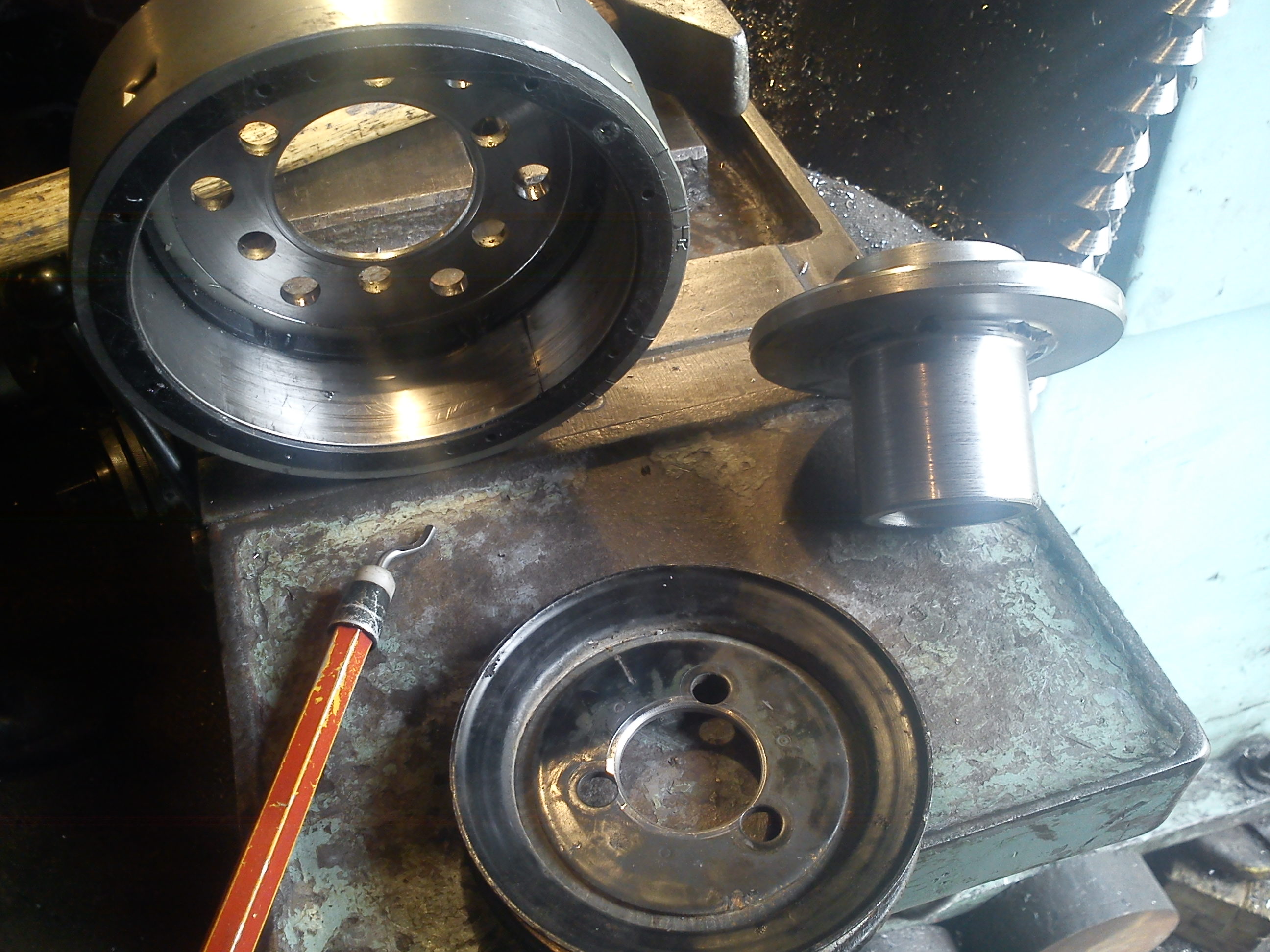

Parts for the Vulcan generator rotor:

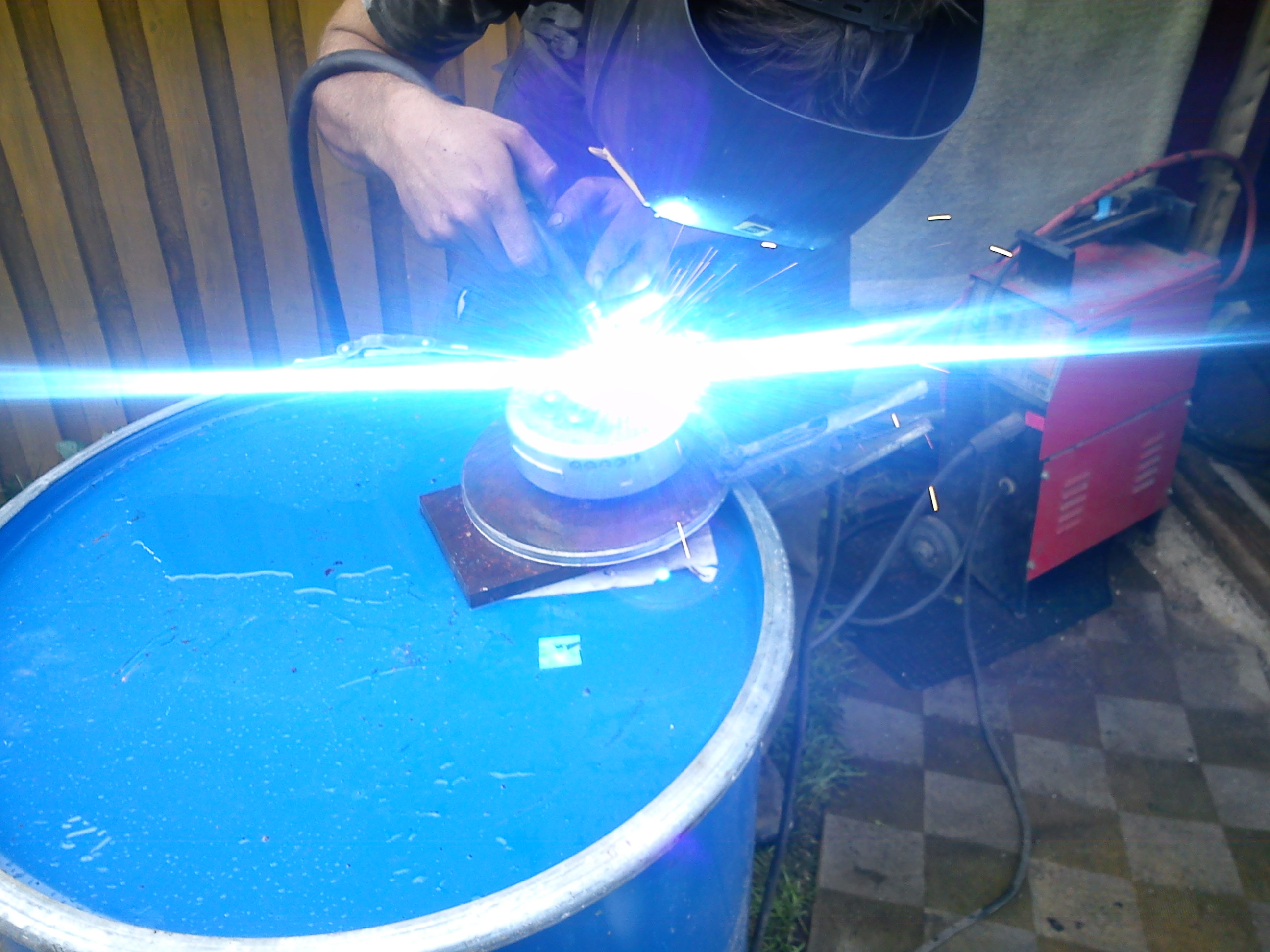

Friend welding all the parts together:

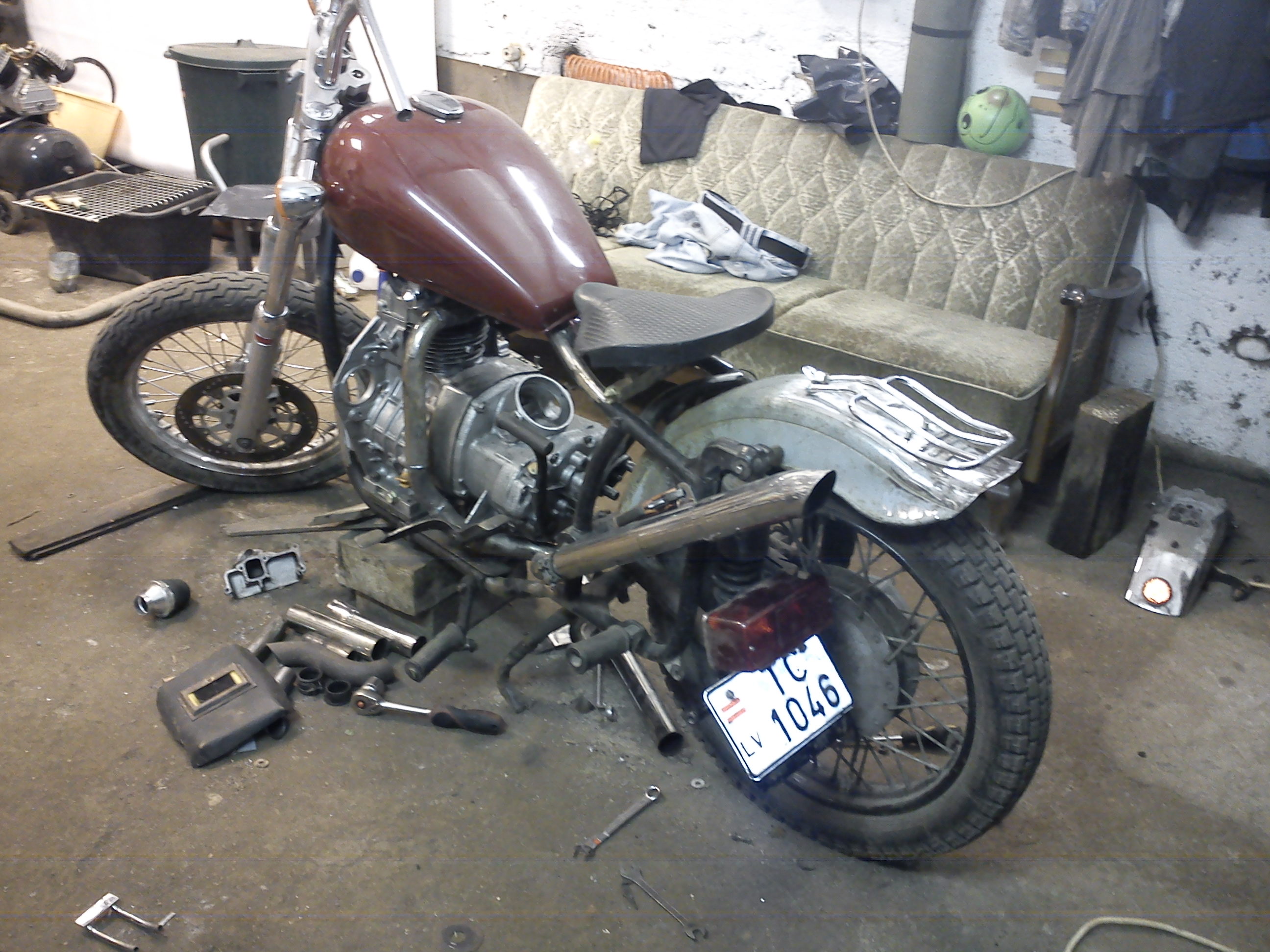

And the pics of semi completed bike, there is still some things to be done - but it's on the finish lino now!!!! :shock: :D :) :) :) :)

The frame, seat, gearbox and rear wheel is frm 1974 russian Dnepr.
The front fork, wheel, fender and brakes are from 1988 Kawasaki Vulcan 1500.
Handlebars are harley aftermarket, rear fender is from russian bike called IZ Jupiter (pic: http://static1.fotoalbum.ee/fotoalbum/1 ... 1eb0e3.jpg)
The Russian bikes and particularly Dneprs are really cheap here in Latvia, one can get running bike for 200$ :)
