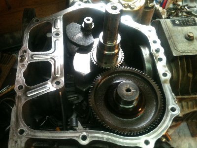

Have recently had problems regarding lack of slow tickover, and as it suddenly developed a hard knock i decided to dismantle the engine to try to find the culprit.

Thats all for now, remarkably simple and ruggedly built engine

These pictures are really interesting - thanks for posting skoleskibe

Any time, comments and / or questions are welcome. Changing fuelpump fixed the missing slow tickover, and enhanced the starting quite a lot.

Thanks for posting the photo's up skoleskibe, it will help many who have these engines when the time comes to pull them down.

Thank you skoleskibe i had never got see internals of this diesel so close. infact i used to wonder why the crankcase was longy to need a chassis bodgery to fit enfields.
you got any pic of governer linking to pump

Have a look at the pictures, the one called "fuelpump governor leaver", u can see the linkage through the oil pump mounting hole the little forked thingy, is the linkage.
