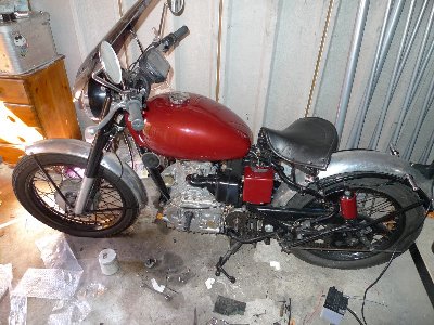

Here's Snoopy's bike:
snoopy
- Posts: 107
- Joined: Wed Jul 07, 2010 8:25 pm
- Location: NCL
Re: Enfield Diesel conversion partlist
Fecking hell how perfect is that!!!
So it's for smoke under load right! I'd better hope I can gauge the load then.
RTW on a diesel Enfield. Starts mid 2012. http://www.andrewcharnley.com/
