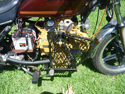

I have installed a Perkins series 40c 500cc twin cyl water cooled diesel engine on a 400cc 1979 Honda. I have had good results with a top speed of 55 to 60 mph. Runs like a watch. Am having a small problem after it comes to full operating temp. and it idles for too long it is slow getting to full rpm. Otherwise runs fine.

Welcome, CatPower! Looks like you did a fine job of that install too!
