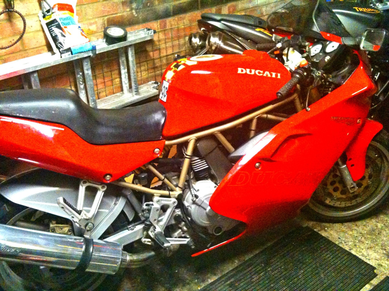

Been a bit occupied with my new toy of late so please excuse. Just need to get the fork seals done and then it's an MOT test for the road. Nice to experience the desmo engine even if it is a '97 one.

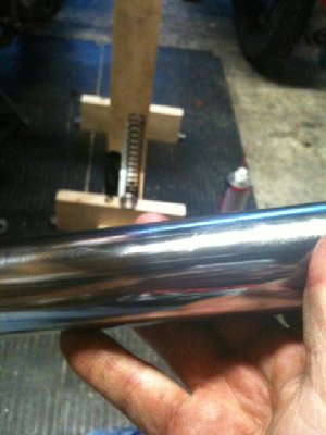

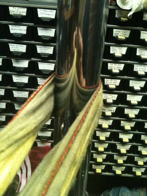

I ended up having to do the fork seals myself today after the mechanic got ill. Good thing really - saved a few quid
Done them both but only one side was leaking. Tube was scored a bit. I managed to polish the grooves out, just. Phew!
Homemade stand works well
