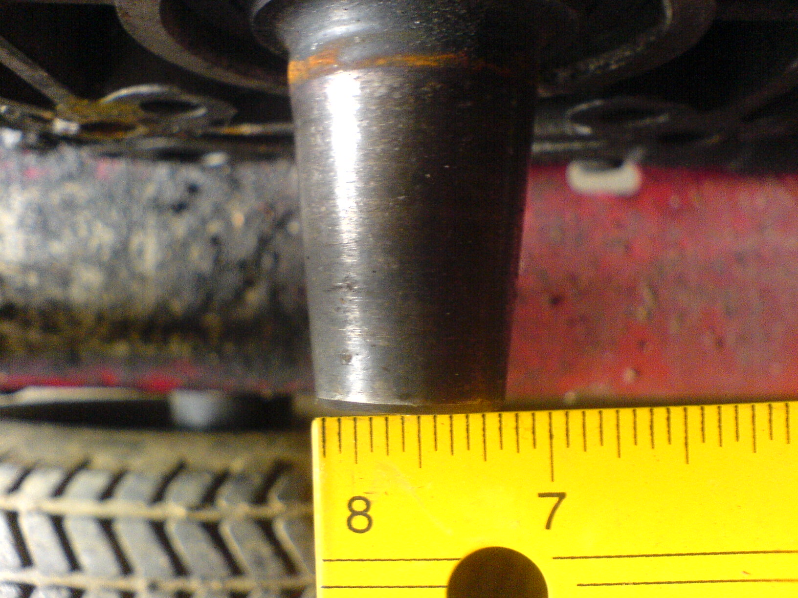

some pics of what i got,
don't know if i got enough to cut to 1 inch.
think there might be a clutch to fit a 3/4"?

getting bit too anxious. ...

Oops!! I'm afraid I assumed you had a tapered crank like several of mine. The ones I have are tapered on the end but have about 1 1/2" of straight shaft before the taper, which is the 26MM portion I referenced. Several chaps have machined a tapered hub to accommodate a taper such as yours. Also, check the various suppliers to see whether they offer in a drive pulley for a 3/4" shaft, should you turn yours down. A 3/4" crank might be pushing it with respect to torque loads. Perhaps someone else can speak to that.

I like the idea of making a taper to fit your crank. With a taper attachment lathe setup (or the cross slide on a larger lathe) it is not hard to bore either a tapered bushing to adapt to a straight bore CVT or to make a flange with a tapered ID to fit a larger CVT drive pulley. I would machine the crank for a half-moon key just to make sure that everything stays together, not a hard thing to do and with a little creativity can be done without pulling the crank. If you still have whatever was connected to your engine you could turn whatever it was down into an adapter bushing pretty easily.
