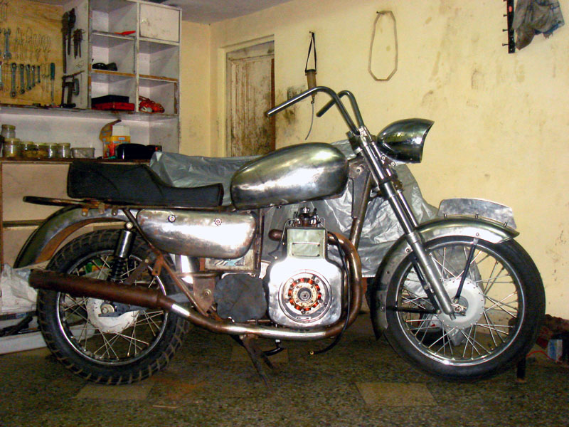

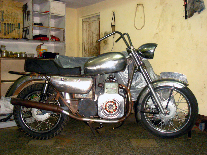

I personally own a 1992 Sooraj and have fitted a 500cc Greaves to it. The bike is in a process of evolution shall we say. When I bought it, it had a 325cc with 5 speed gears and electric start, on my first ride home with the bike heading up to Shimla in Himachal Pradesh the bike began to rattle to bits, a bolt had come loose on the gear box causing me to literally run out of gears. It was running on 100% virgin soy bean oil. I found the 325 to be under powered so am hoping the the 500 will feel better. I have fitted a 20 tooth front sprocket to increase the top end a little and am thinking of using mustard oil as the fuel as it is higher octane, hoping that the crank will handle it okay. May mix 15% diesel in though would prefer running it pure if I could.
This picture is just showing its general look, the tool boxes have been made a little bigger than the original and the tank is more boxy than the usual Enfield style used on them. I am still playing with the pipes, it has twin pipes but the shaping of the inlet was pretty bad going under the brake lever and foot pegs, so I am trying to work out an alternative, maybe just a Harley style pancake air filter will look okay with the styling. There is space under the tool box for the pipes so maybe a high line pipe maybe the go. It will stay as polished metal and gunmetal grey frame to set off the chrome. The rear tyre will be a 140/17" with wide and swing arm and the front about 110/19" with front disc brake. I am mulling over converting it to a mono shock, I have recently done this with my Thunderbird that is also going through a major transition. It will extend the length by 10cm and tends to kick the front angle out a little giving it a nicer line.
So great to have workshops, engine room and mechanics about to just play as you feel like in between building other peoples bikes. The point of doing this is, as it was a little strange to begin with and I thought that trying to give it a leaner look may create a great deal of interest in diesels here, though the regulations are a bit tough on them now so it all maybe short lived.
