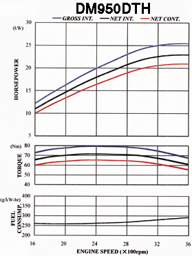

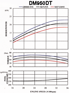

- LocomotiveBreath
- Posts: 250
Re: Engine Options
Are you looking for this? One is the 31hp and the other for the 34hp Diahatsu Briggs 3LC, I don't know why Briggs & Stratton pulled these graphs, I have them saved in my files.Privateer187 wrote:The thread says that the 34HP should go about 100, best case scenario. That is acceptable, because I figure that with reasonably tall gearing my top end won't drop below my desired 80mph, and might even exceed that. I've searched, and I haven't found any fuel consumption figures for the B&S 34HP diesel motors. Can you direct me to a thread or website that would so that I can calculate estimated fuel economy?
P.S. Thankls for the help. I guess I really don't want to use a car engine for this application. The B&S sounds good, even if it is a little on the pricey side. Any cheaper options that perform about the same?

TedV
- Posts: 123
- Location: Knoxville,TN, USA
Re: Engine Options
Thanks, I know I was. I have the power graphs but not the fuel. Would you sat the DM950DTH is the current model DM954DT?? All the motors in this range seem to have about the same fuel consumption per KwHr.LocomotiveBreath wrote:Are you looking for this? One is the 31hp and the other for the 34hp Diahatsu Briggs 3LC, I don't know why Briggs & Stratton pulled these graphs, I have them saved in my files.
