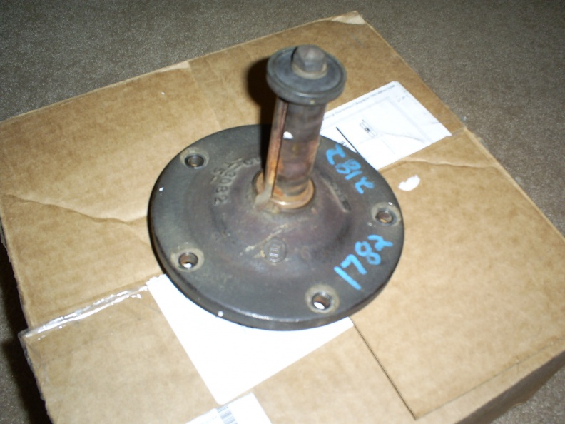

I suspect the fact that Kubota offers a stub shaft for this engine is confimation they have little concern over side loads.

Do you happen to know a part number for that shaft?pietenpol2002 wrote:I suspect the fact that Kubota offers a stub shaft for this engine is confimation they have little concern over side loads.
