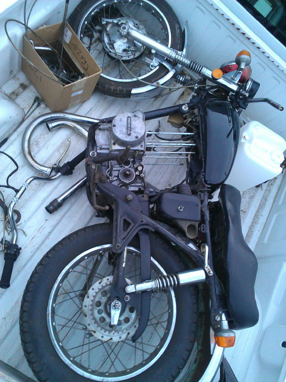

Hello everyone,
I am a college student here in the U.S. who does not like paying for gas. This will (hopefully) be my solution to that.
I'm building a low and stretched bobber type motorcycle based off of this 418cc knock off. The engine is manufactured by Wuxi Engines in China. They make some big stuff... hopefully that translates to quality. The engine I got looks good overall. Much better than some of the clones I've snatched off eBay or Harbor Freight in the past.
Anyway, the plan is to make this thing CVT driven and turbocharged. The donor bike is a rough 1969 Honda CL450 that I got from a guy across my state.
Progress Pics Below.

Donor Bike
Donor Bike
