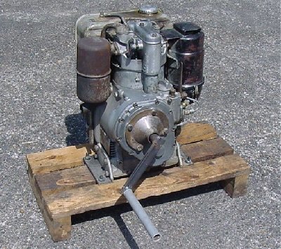

I've seen a thread on swapping intakes for exhaust here before (maybe a couple of years ago), but couldn't find it. Any opinions on my crazy idea? I'm sure it's been done before, and the only drawback I can see is the compression release working on the intake. Here's a pic of a similar engine (scoffed off the 'net), notice the valve arrangement and single pushrod tube feeding the rocker arms under the funny-shaped rocker cover:

Smokey,
I don't know, think I'd leave it alone and let the exhaust exit in the rear. There are many good looking diesel bikes built by the experts in Europe that have figured a way to get the exhaust out. Look at the bright side, you can put a velocity stack on the front of the engine and get some ram induction

Re: Swapping Intake and Exhaust -Opinions???
So have you tried swapping the intake/ exhaust?
Be an interesting experiment to try.

I'd try it. Course I'l try almost anything as long as I thought it was worth the trouble.
Post up some pictures if you havn't given up on it yet.
Smokey,
On the other hand from what I said before, having the exhaust on the front of the bike would allow for better cooling. Thing about the valve diameter is intakes are usually larger as it takes more to suck in fresh air than it takes to exhaust inert hot gas that is under pressure. So try it both ways and see which way the engine runs better
