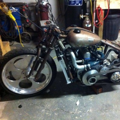

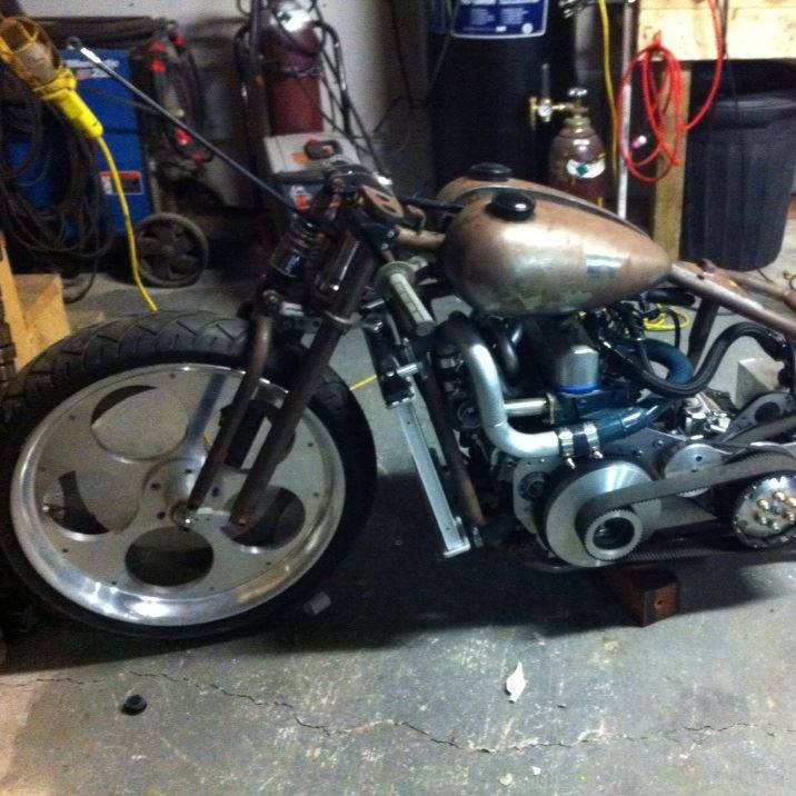

Small update. I have been busy with moving and lots of work taking my time but I did manage to get the bike running and have it almost done. I have 3 other diesel bikes being built and they are priority. I have to build a fender/seat, hook up alternator, mount battery, build controls and plumb brakes.
This thing sounds mean, and revs very fast. So far so good. Spring is here so I better hurry up.

YOOO.. noooo you can't just leave it like that. THREE OTHER DIESEL BIKE BUILDS!!! You give no details about them? You must be flogged immediatelydethmachinefab wrote:.... I have 3 other diesel bikes being built and they are priority. ....

One is a c1.1 powered softail. Mostly complete. The next is a d1105 powered softail with some really nice work going into it. The third is a sportster frame with a twin cyl c.5 and cvt trans. A few others are in the quote/ idea stage. So I am populating the country with diesel bikes! I will try to get some pics. With all this it's hard to update a thread consistently.
