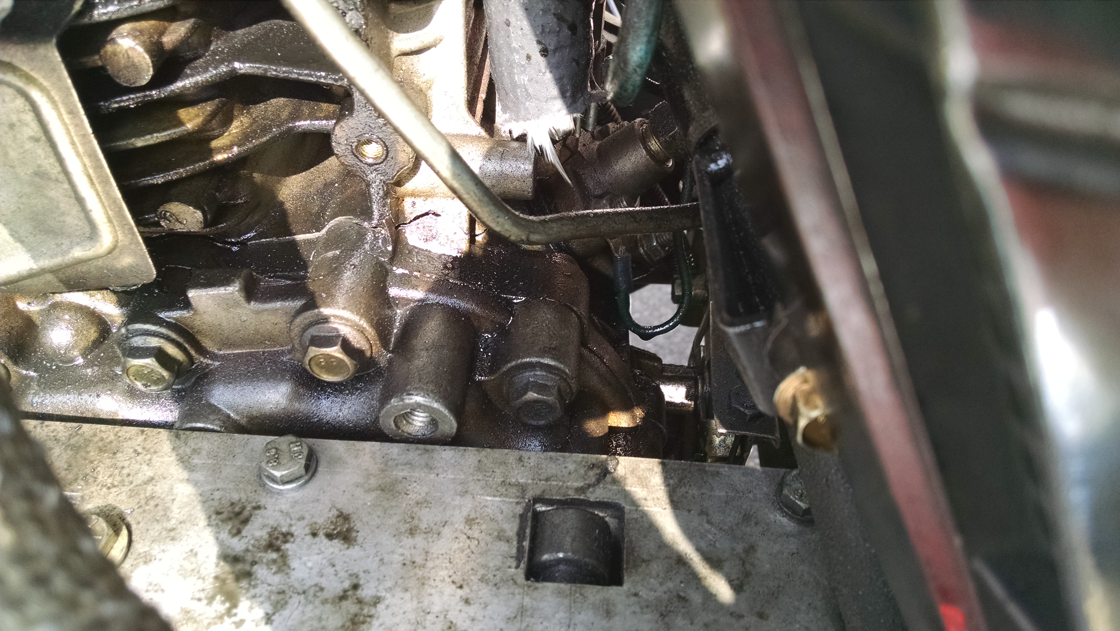

...the crankcase split in half directly below the cylinder, nearly blowing the top end clear off...
RIP to the first engine, and time to start looking for a new Yanmar L70 clone. Onward and upward!

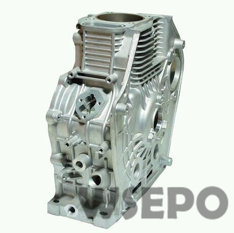

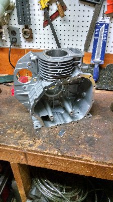

After careful examination, I am confident that the guts of the engine are fine, and the damage was limited to the crankcase. So, rather than simply swap engines, I've decided to purchase a replacement crankcase and transplant as much as possible out of the blown motor
(yes I'm aware this is the more difficult option, but I'm stubborn
I registered an account with AliExpress, and hopefully I will be in possession of a fresh crankcase within the month

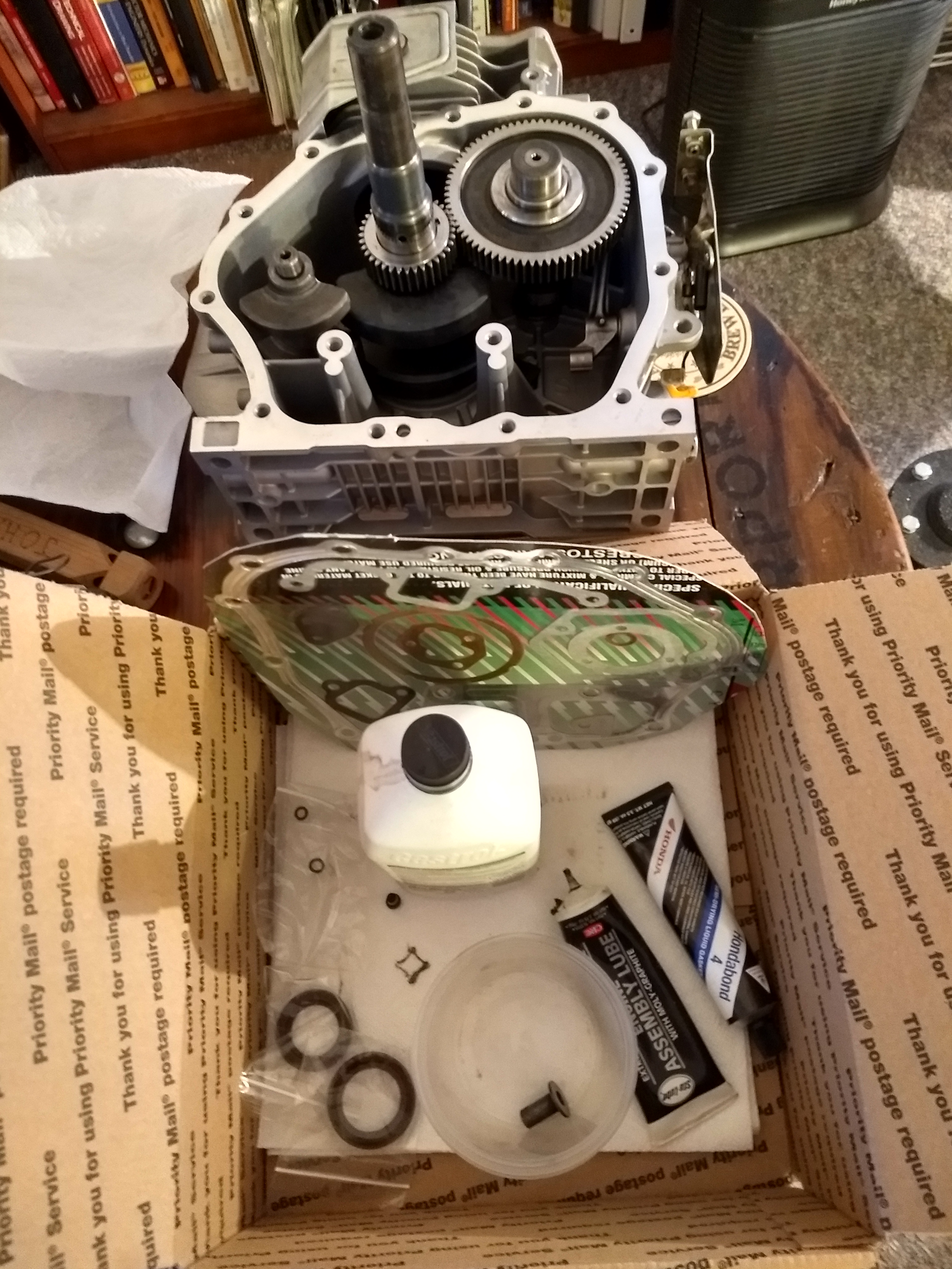

It has arrived

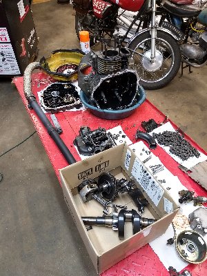

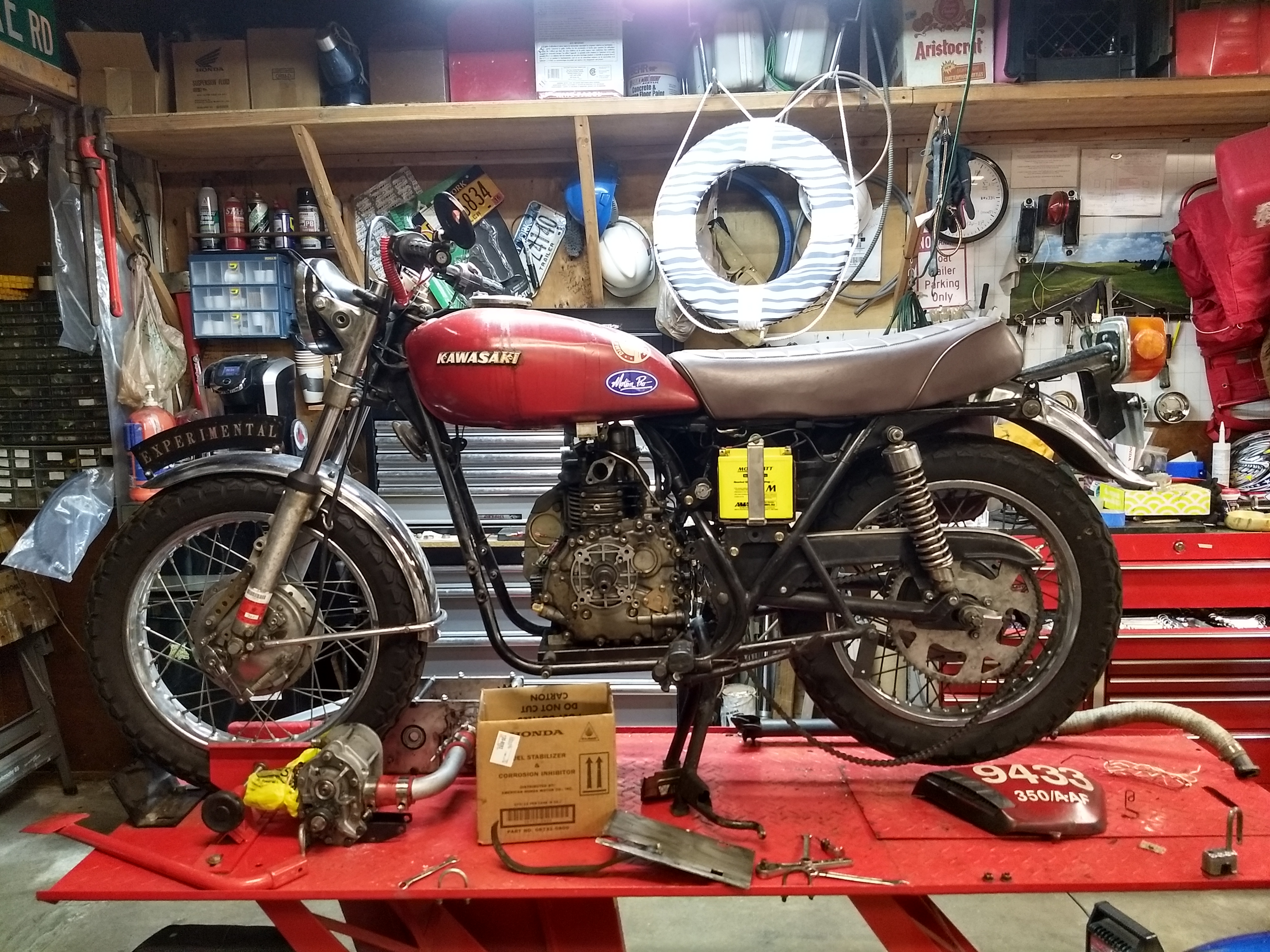

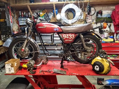

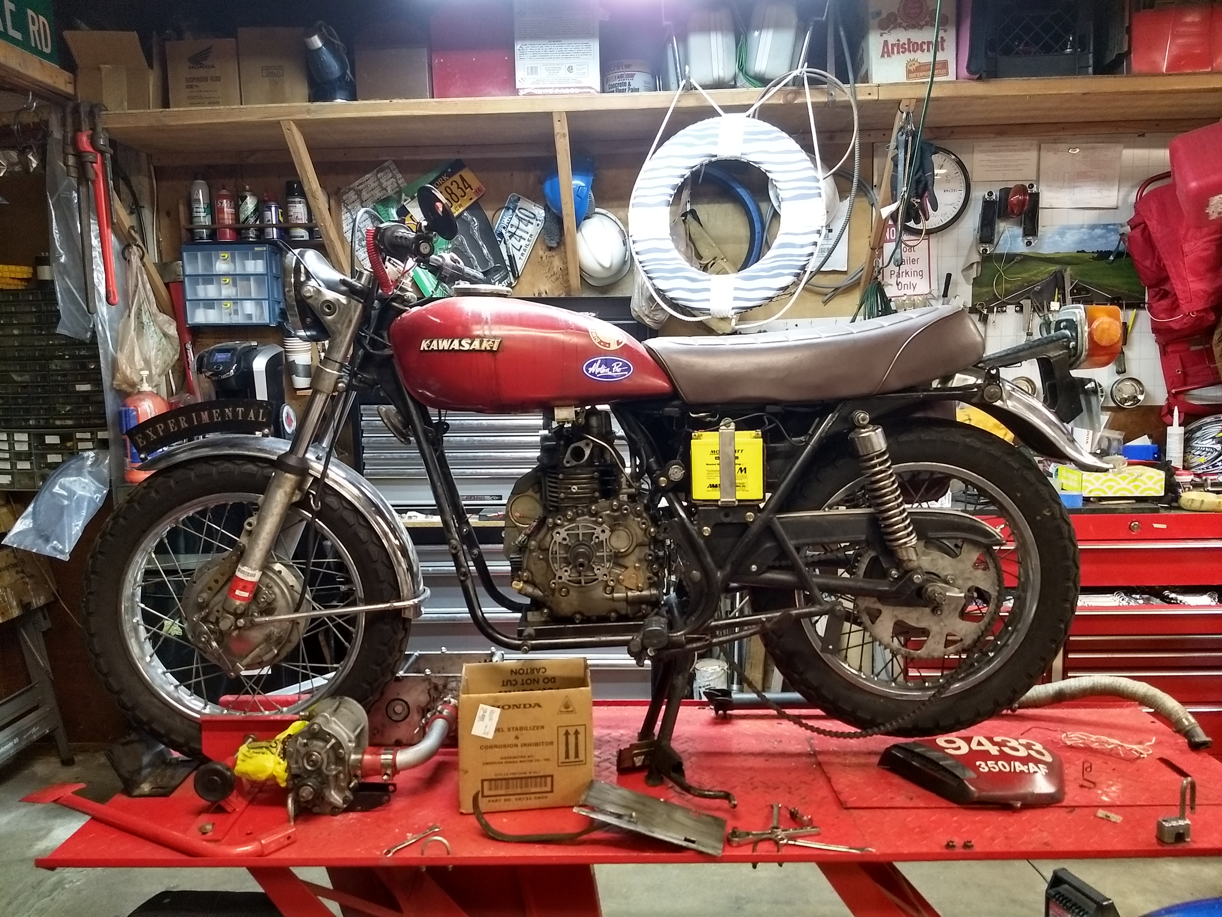

I finally worked through my backlog of other projects, and the KZ400 diesel is now back on the bench for a rebuild. The first step was to disassemble the drivetrain, clean the frame, and improve some of the mounting hardware and wiring.

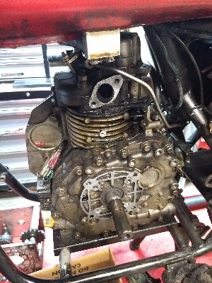

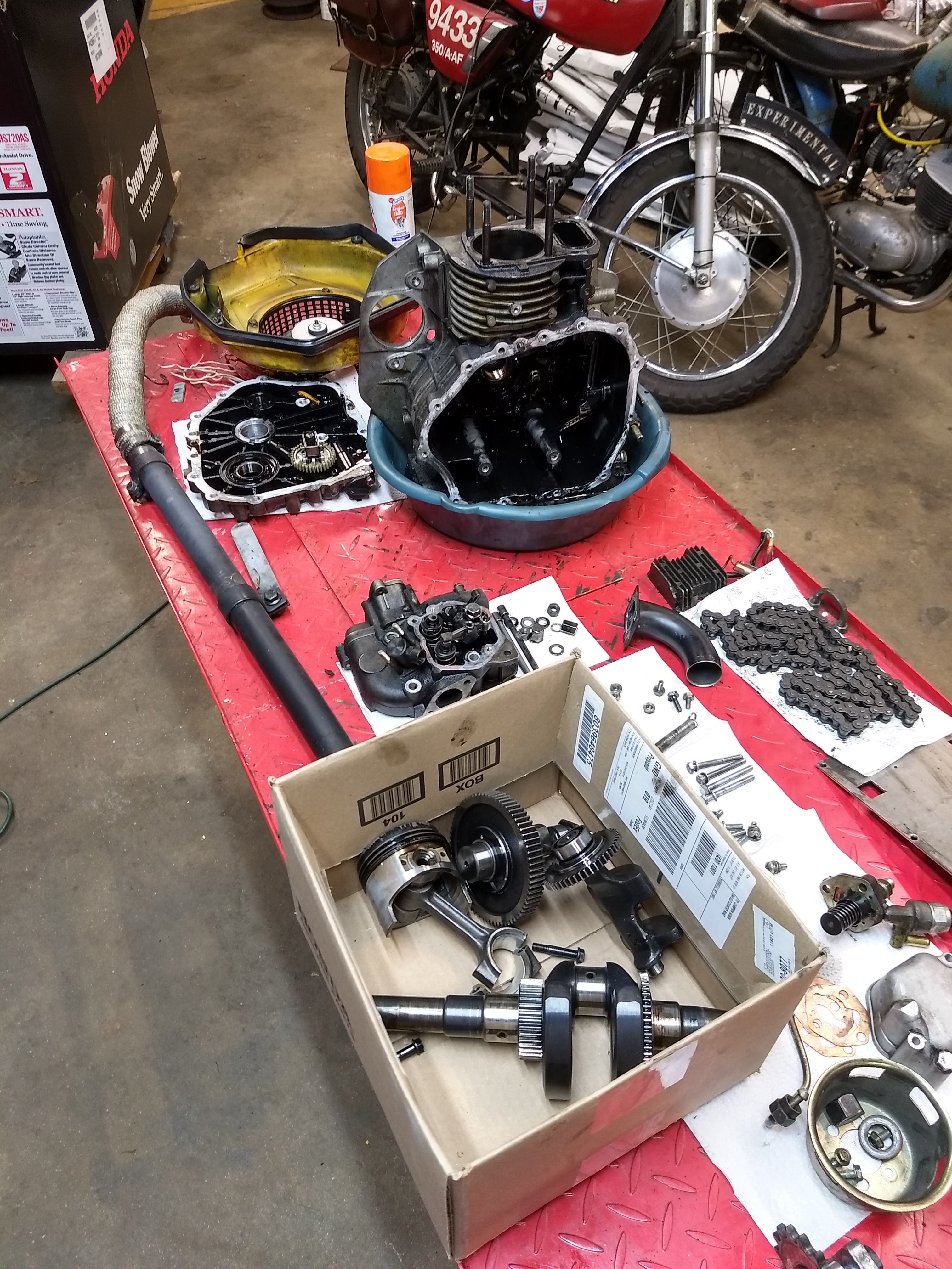

I finished stripping the engine, and was able to examine the inner assembly for the first time. Overall, the components are in excellent condition, the only major issues being excessive carbon buildup in the combustion chamber, and wear on the output-side plain bearing.
I also inspected the camshaft, and found no evidence that the stronger valve springs had caused any damage to the lobes.

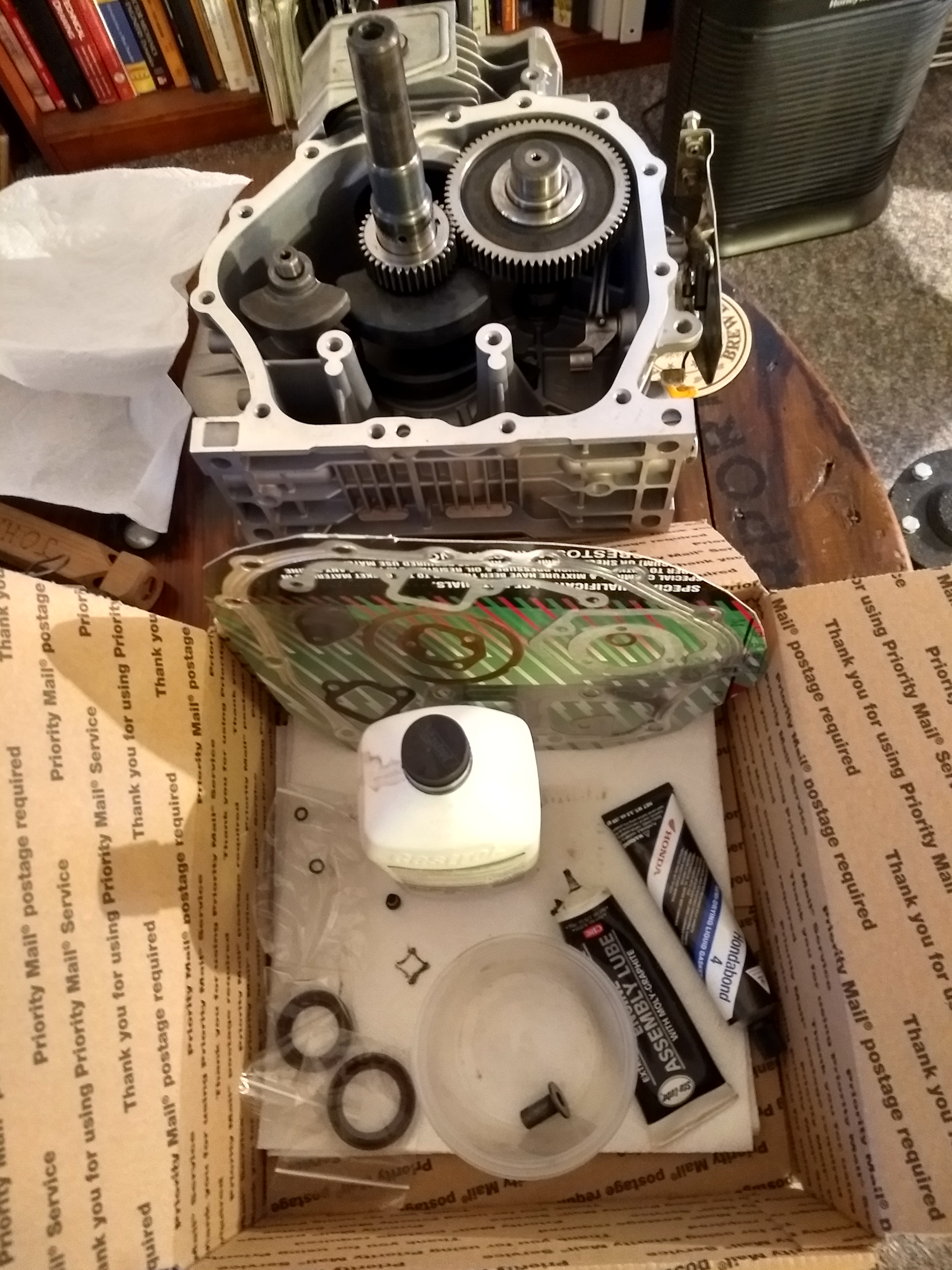

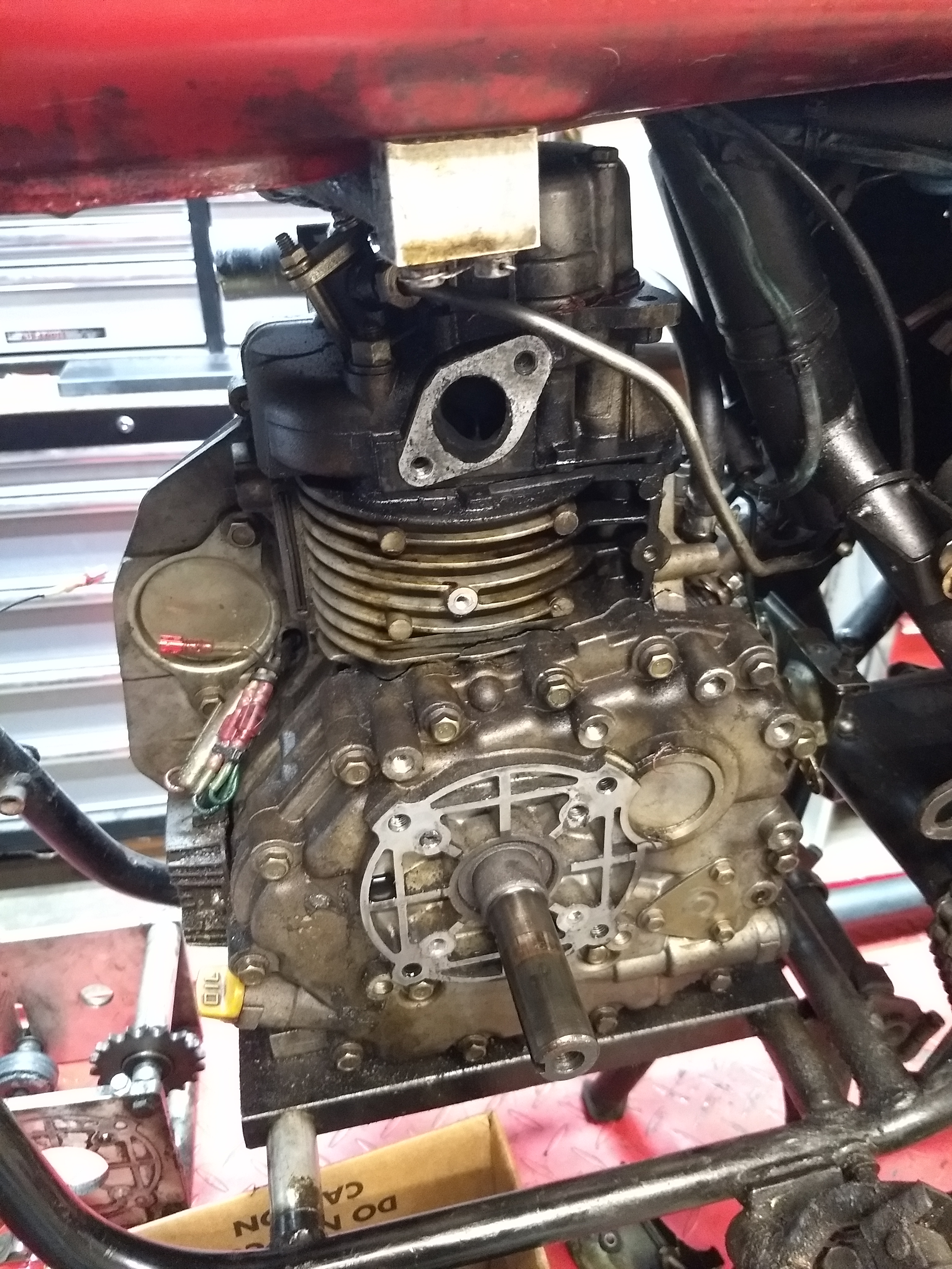

Progress! I've refurbished the original engine internals, deburred the new crankcase, and installed everything with fresh bearings and seals.

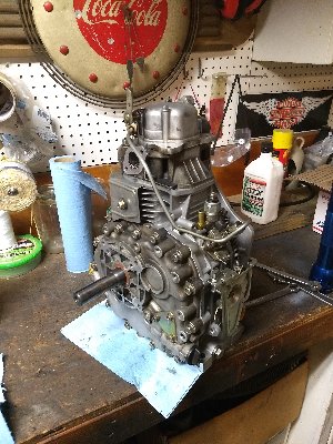

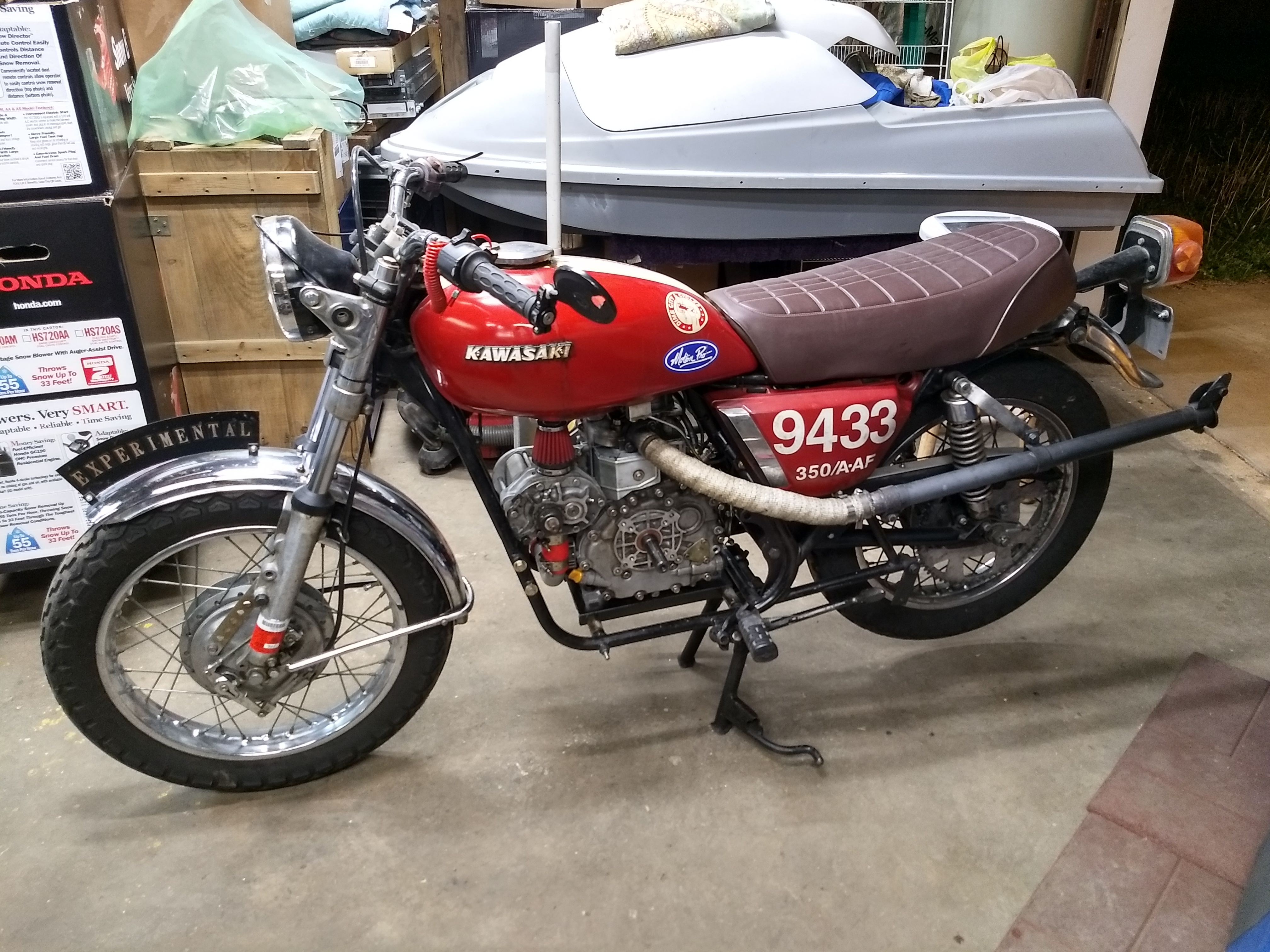

Engine reassembled and tuned!

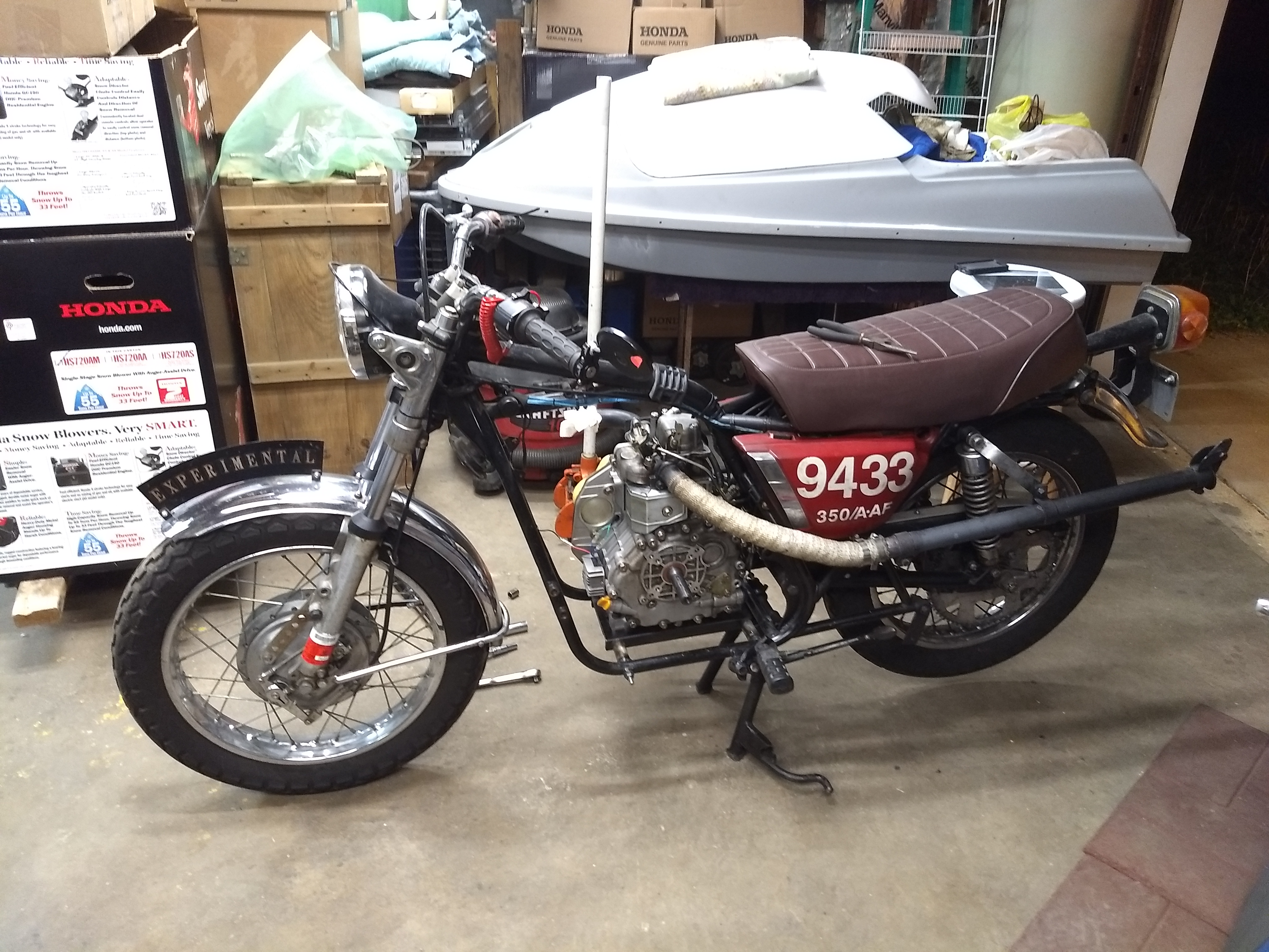

I brewed up some caffeine and locked myself in the garage for a marathon reassembly session last night
HondaJohn
- Posts: 136
- Joined: Fri Jul 16, 2010 2:21 pm
- Location: Upstate New York

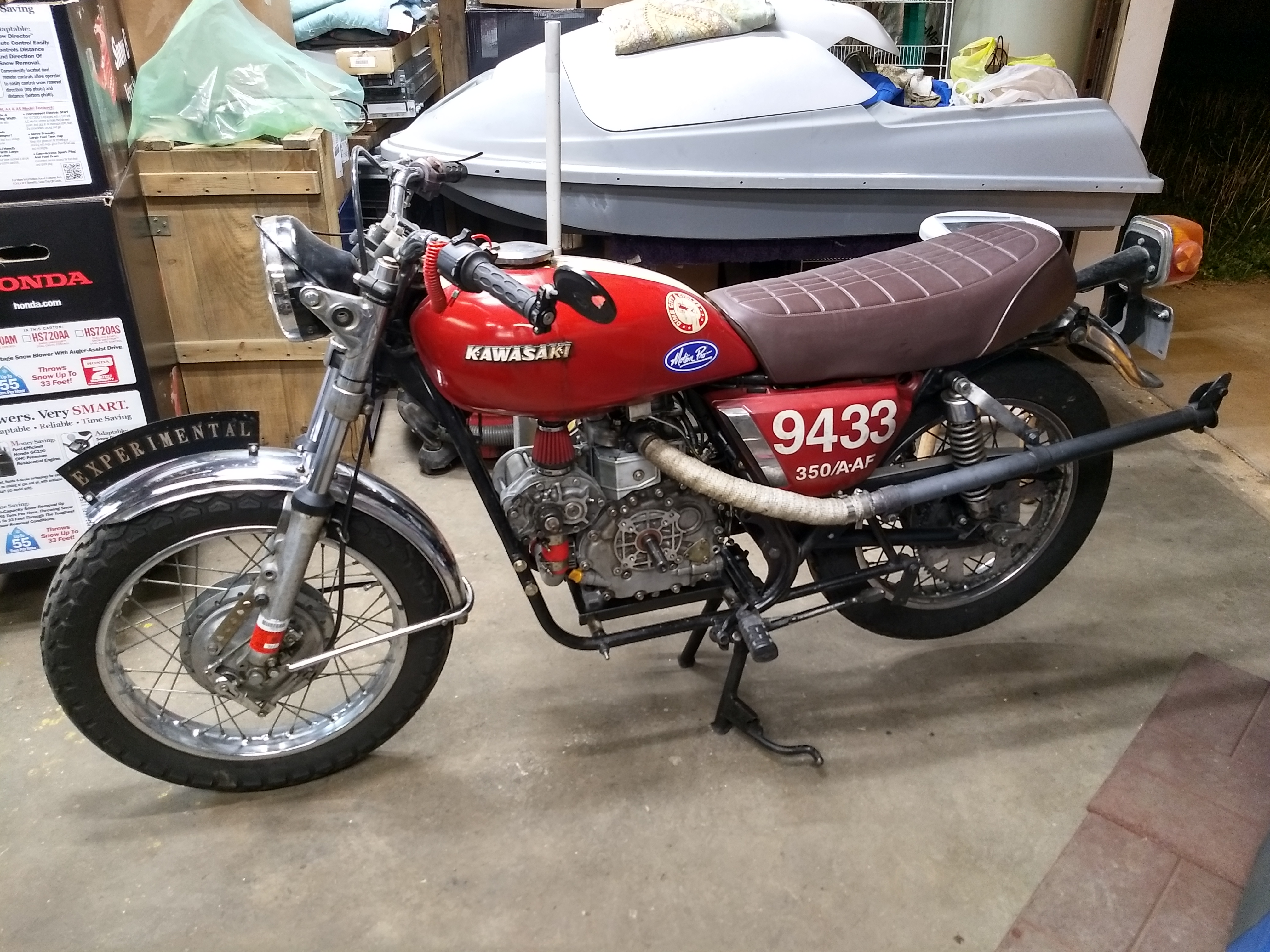

Re: Land Speed Racing
Finished reassembly and received a fresh NYS inspection. Finally ready to ride again!
