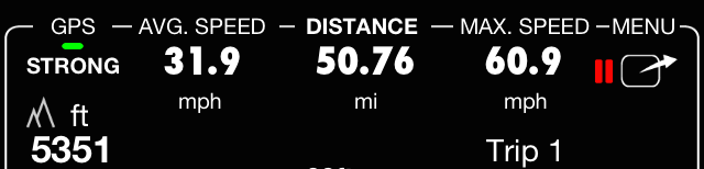

First fuel fill: 6.1 hours, 105miles, 1.343gallons, 77.96mpg (all US measurements)
About 15mpg better than the stock Rebel gas engine. There is still room for improvement as the engine breaks in, I learn how to control it and the CVT more efficiently, and the turbo is installed.
Installed the windshield. Vibration broke a horn bracket and I lost it under the back tire.
3 of the 4 jackshaft setscrews also vibrated out. I used blue loctite the first time but I will use red this round.
Got the replacement EarthX battery. Still need to find/make a proper hold-down. The battery only weighs 1.3lbs so it doesn't add significant mass to the swing arm assembly. (The stock lead-acid battery was mounted to the swing arm a little further forward in the center)

The odometer is accurate according to my iPhone's GPS, but the speedo needle lags considerable behind actual speed. Cruising it catches up to actual speed but, for example, stopping from 45mph it will still be slowly coming down from 25mph by the time I am at rest.

Did a 145 mile run today, 1.51 gallons, 96.24mpgUS.
Need to figure out how to adjust the driven clutch to hold RPM longer. It accelerates great at 3600rpm up to exactly 45mph then the clutch upshifts the belt 1/2", the engine lugs down below 3000rpm and I can't make it downshift to keep RPMs up and accelerate.
I will make a post in the CVT section.

Changed the front sprocket to 13 tooth. I can now maintain 40mph on hills and top out at 50mph on flat road. With any amount of road decline I can hit the 60mph gear limit easily, whereas before with the 14 tooth I couldn't hit the 65mph gear limit even with long declines. I may switch to a 12 tooth after a while.
Diesels on the mountain went well.
27.165 @ 45.69mph with intake silencer and exhaust baffle
26.343 @ 47.31mph with cone filter and open exhaust pipe.
