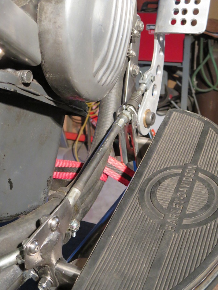

For the record, below is this evening's results. Exactly 5 hours to produce 2 simple brackets for the brake cable. And life is good.
http://forums.tdiclub.com/showthread.php?t=20401

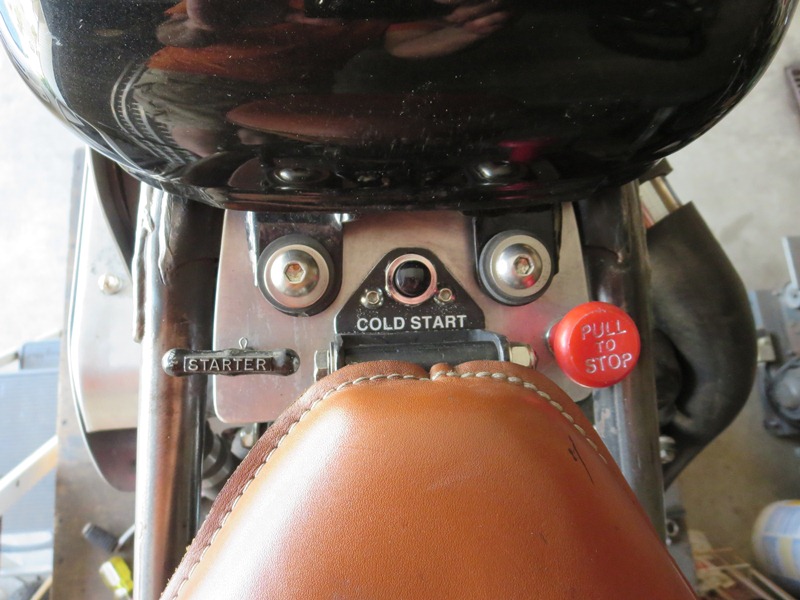

Today's result. And Freud would be pleased with the placement of those power controls.
Left to right as follows.
1. Starter pull handle from Pratt & Whitney aircraft engine
2. Glow plugs fired by 60 amp starter button from 1937 Cadillac
3. Stop cable from Ford diesel tractor
Re: Honda 750 with Kubota Z482
Love your selection of practical Gizmo's with an almost steampunk attitude.
Looks great! Make sure you tie the stop lever to the "Throttle" and not the decompression lever.
Fortunately, the Kubota has a dedicated shut-down lever on the pump to couple the pull cable to. But no decompression lever. We'll see how kick starting goes.Make sure you tie the stop lever to the "Throttle" and not the decompression lever.
