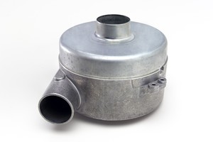

Okey dokey. Following that link, then hitting the 1984 Turbo link, then scrolling down and going to the "Advanced Turbo Page" brings you to a few flow characteristics for the compressors http://www.thedodgegarage.com/turbo_advanced.html .
When you say "fairly large diesel engine" in your earlier posts you could mean a fair few things, but taking say, a 1.8L 4 cylinder, revving to say 5krpm as an example:
1.8L * 5000/60 * 0.5 = 75L/s of air = 0.075m^3 per second. Air density is around 1.225Kg/m^3, so that's about 0.09Kg/s. The boost pressure will increase its density so maybe it'll actually flow about 0.15Kg/s if you've got plenty of pressure.
0.15Kg/s = 20lb/s air flow.
Reading from the characteristic for the T3, on that webpage, 20lb/min is pretty much halfway along the bottom axis.
If you want 7psi boost, that's a pressure ratio of about 1.5, so reading across to the curved line, you'll need about 96000rpm. With a crank speed of 5k, that's a 20:1 gear ratio.
Alternatively, come down to the 78,800rpm line, and maybe accept a bit less flow - 17lb/min, and the pressure ratio is 1.3, so about 4.4psi boost.
Come down to the 56k rpm line and you get 1.2PR (3psi) boost at the surge limit, falling probably to about 0psi boost at 15lb/min flow.
To get something useful at the kind of rpm you're talking about you're going to need a much larger diameter compressor wheel. Something off a dirty great truck engine might work, but I'm not sure how well it'll react to the small flow quantities you'll be demanding.
I wasn't joking about the vacuum cleaner impeller. If you read around on the internet you'll find plenty of people that have made small jet engines out of turbos, and a handful of people that have made their own compressor wheels or use stuff similar to hoover impellers.
Given the low speeds, low pressures and low temperatures you're likely to use, having an aluminium impeller capable of 200krpm (overspeed) in a thick, heavy aluminium housing built to contain much higher pressure seems like lots of extra weight.

I'm not necessarily assuming he's joking. If you look at the specs on the 2 stage Ametek full house vacuum blowers they are capable of over 100 CFM while generating upwards of 6 PSI of boost if mated to one of our little 10 hp Yanclones. Not bad for only weighing a few pounds. I picked up several new ones on "that auction site" for $9.99 each to toy around with before finally settling instead on the Aisins. The biggest challenge is that they produce those kinds of numbers by turning 25,000 RPM. Rather stiff overdrive when you're starting at 3600 RPM. I did ponder driving one from the full diameter of the Yanclone flywheel which would get you the required 25,000 with yet a reasonable size pulley on the blower. Never got beyond the pondering stage. Service life is 500 hrs continuous which works out to somewhere between 25,000 and 30,000 miles. Not bad for 10 bucks. But who knows if it would even work.
