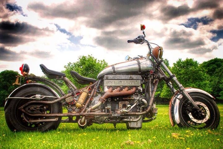

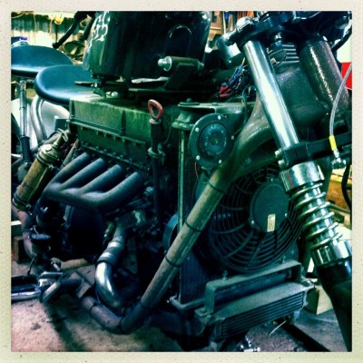

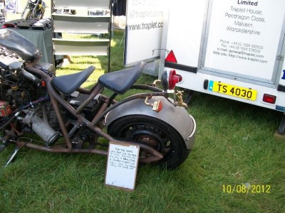

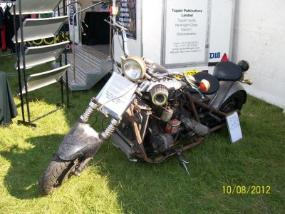

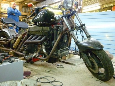

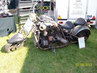

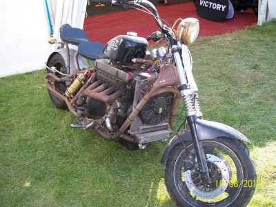

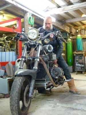

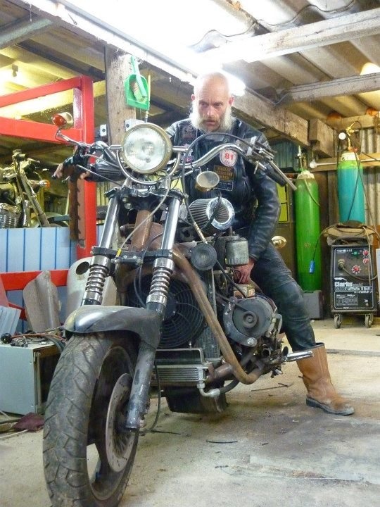

Here are some shots supplied by Ian who made it to the Bulldog Bash. Obviously the bike isn't finished & was just there for the run up the strip. I've no idea if this happened as yet.
Re: Whisker's New Build
what a beast. Guess the rider will need asbestos lined pants on the exhaust leg

The first few pics had me worried because of the size of the tank and all the pics make me wonder about the front end, it looks kinda flimsy for such a big bike?

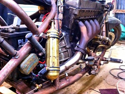

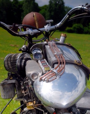

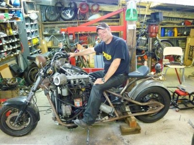

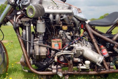

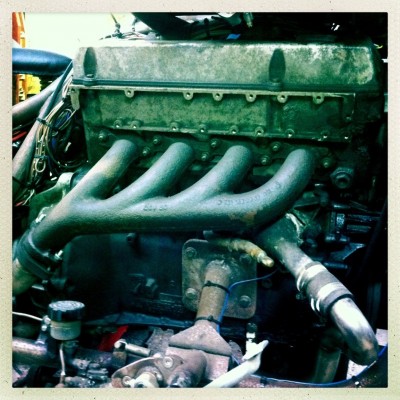

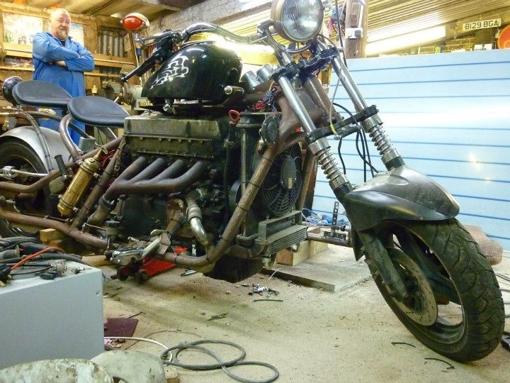

Here's a few more arty shots.
- Posts: 2234

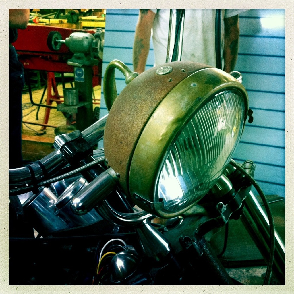

And more....

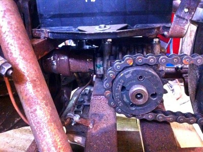

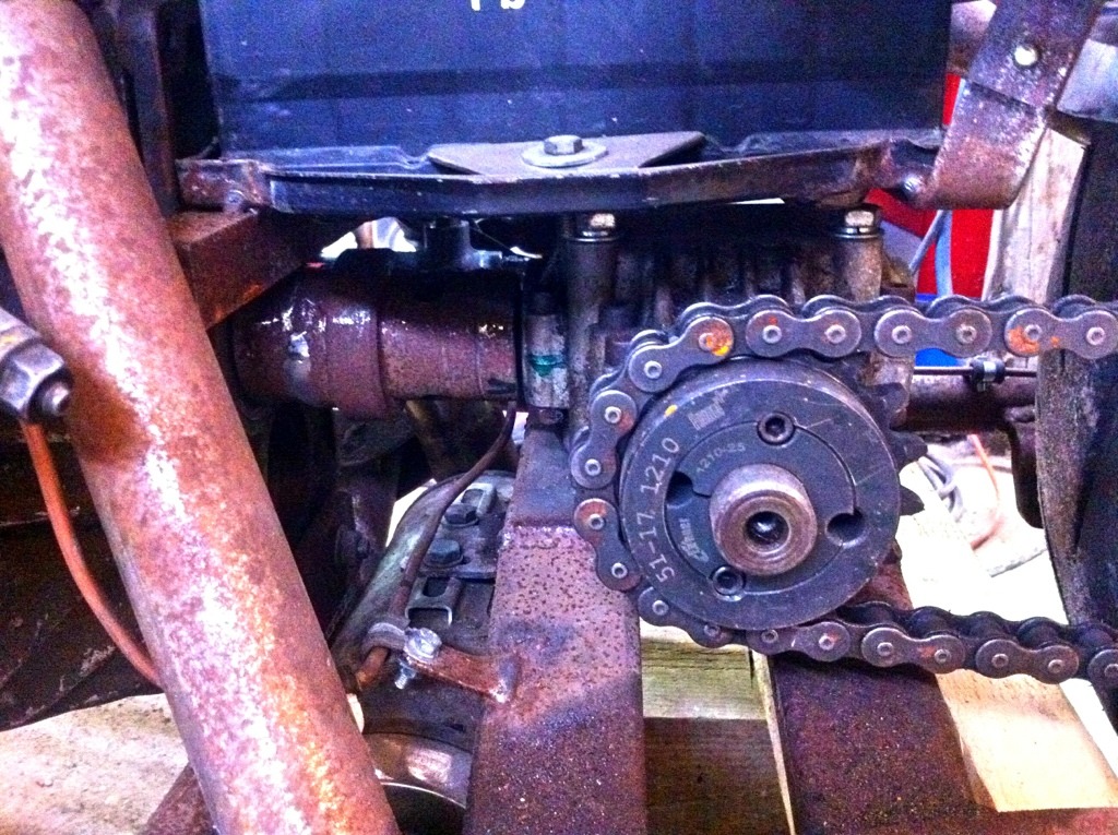

Ohh very nice! How is the drive, via the clutch to a welded diff? Is there no gearbox then
- Posts: 2234
No gearbox just a saw bench bevel box.

Saw Whiskers last night after he came along to a gig my brother was playing at. They are still working on various clutch ideas.
Rather smallish chain to rear wheel was only put on as tempory measure to move it at Bulldog Bash.

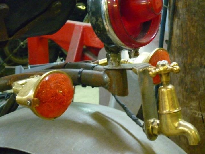

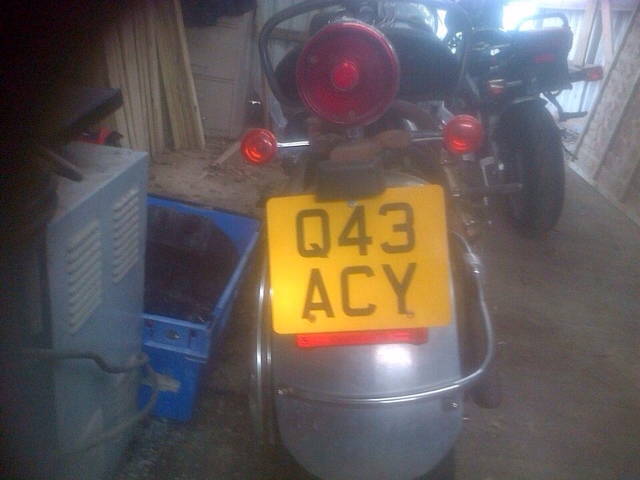

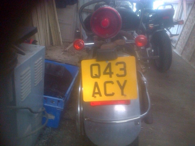

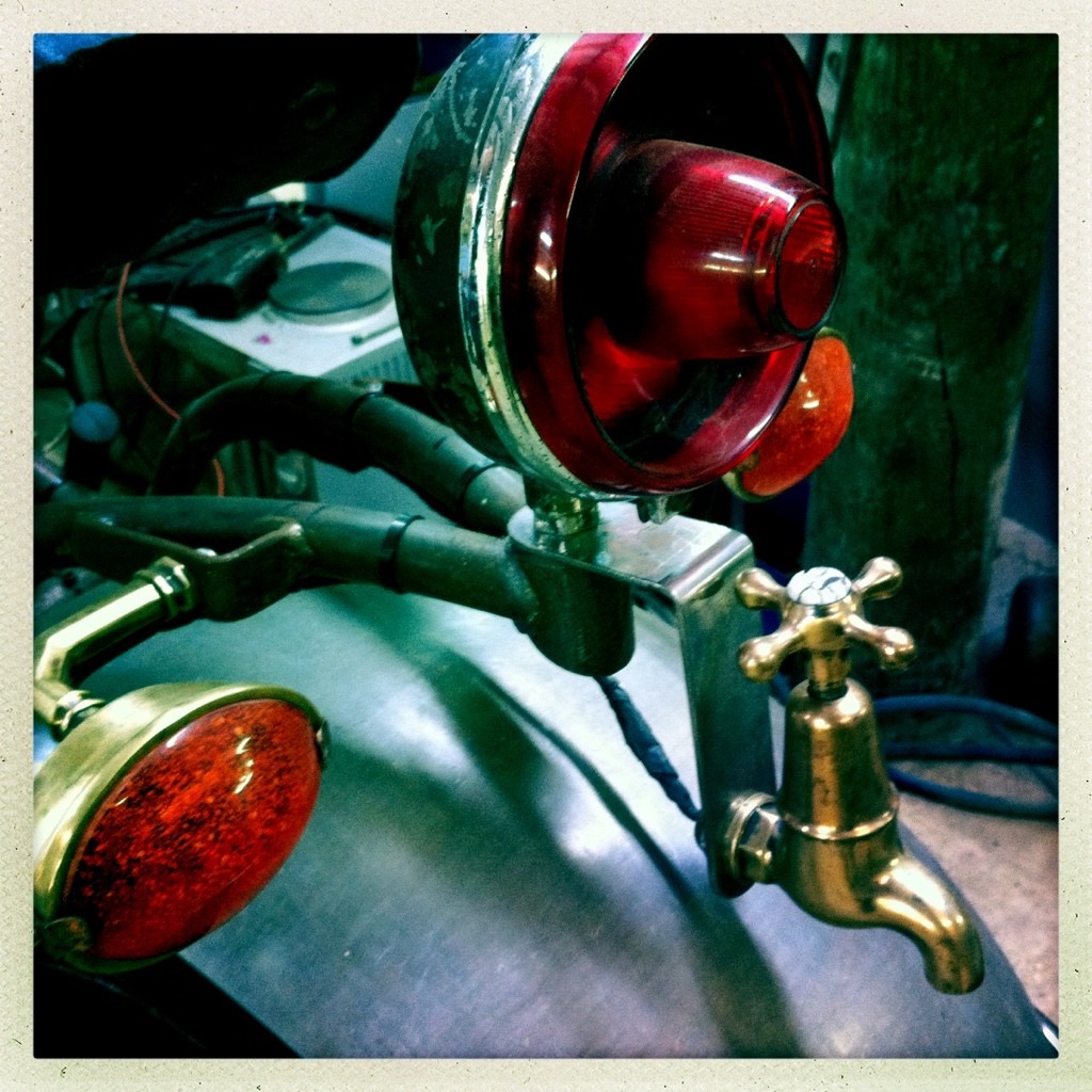

Does that tap on the rear house the license plate light then?
- Posts: 2234
Yes, the bulb is in the body of the tap, not the spout.

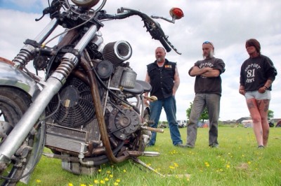

In case you missed them, a few shots from last years rally.

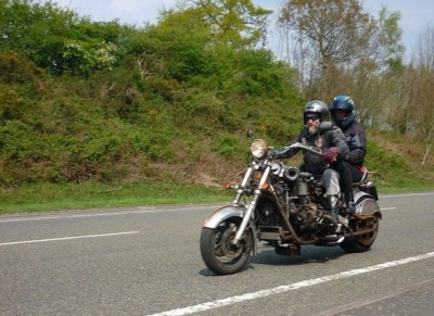

I was out riding with the Sprocket today
