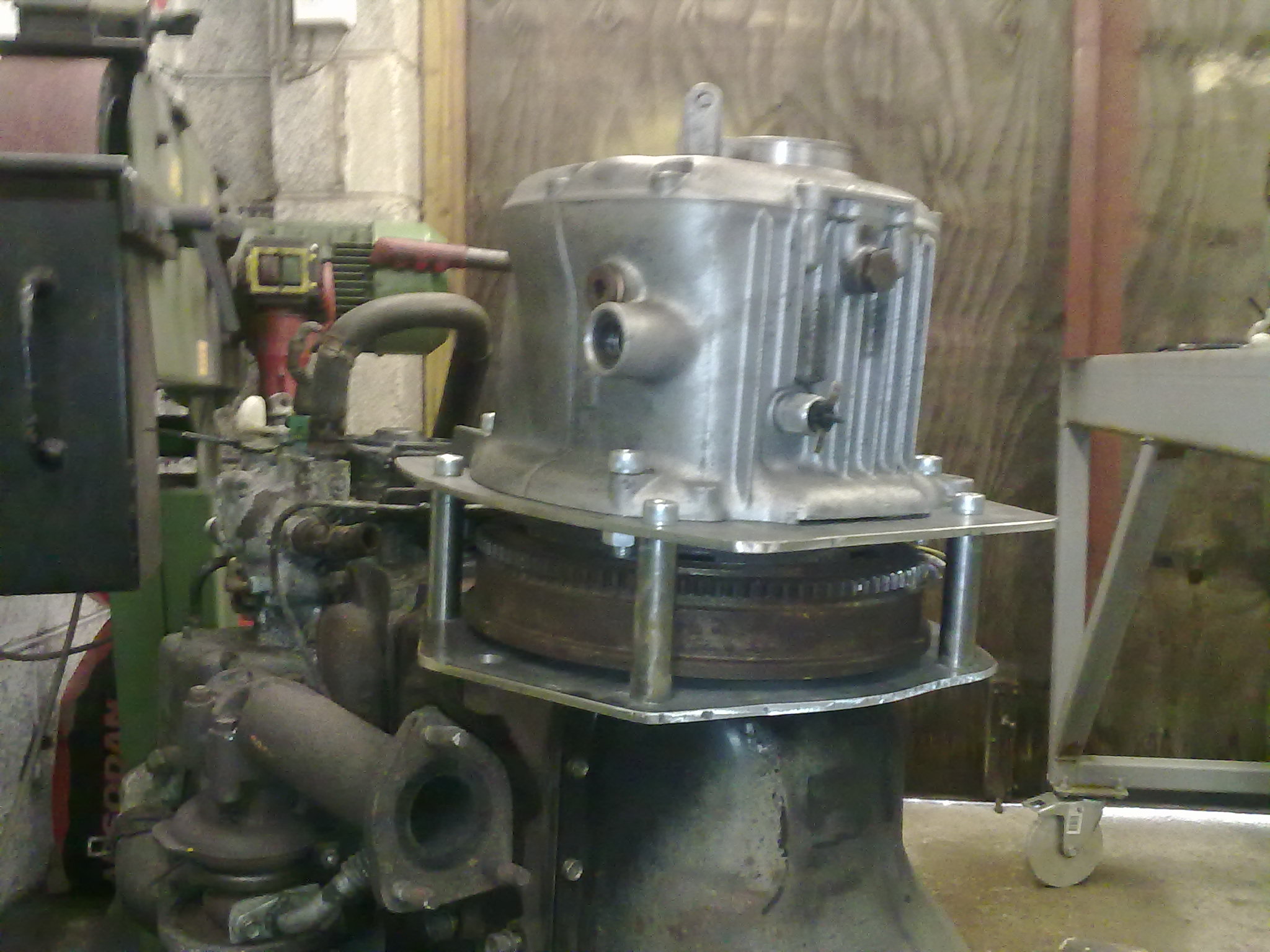

Hi all, got a bit done on my outfit so, hopefully some pictures. The engines laid on its front but thats not how it will be in the bike :lol: That gearbox does look big but its a bmw R65.
buckles
Posts: 84
Re: birdbrained idea continued, but very slowly.
Post by buckles »
mark_in_manchester wrote:I used a Ural flywheel and clutch, which is about 30% lighter than Daihatsu one (I've not attempted to calculate relative moments of inertia based on integrating the mass over the radius, though I did think of using my lathe as a brake and timing how long they both took to slow down on a faceplate when I turned the motor off) - engine ticks over fine even when very cold, and won't stall. I think you'll be fine. If you're suggesting that someone has buggered up your Daihatsu flywheel (starter ring problem etc) and you think that it would be possible to install the BMW clutch you have into said flywheel and avoid this problem, if the job had been approached in a different way, then I may still have a D. flywheel which I didn't use - I can't remember if I weighed it in or not.
cheers
Mark
Hi Mark, flywheel is machined and clutch is mounted, and the way the engine and box fit together there may be no need to make another ring gear. In its original position the starter was in the side of the daihatsu bell house, but it should sit central above the bmw gearbox and mesh onto the ring gear to start the beast. :P
