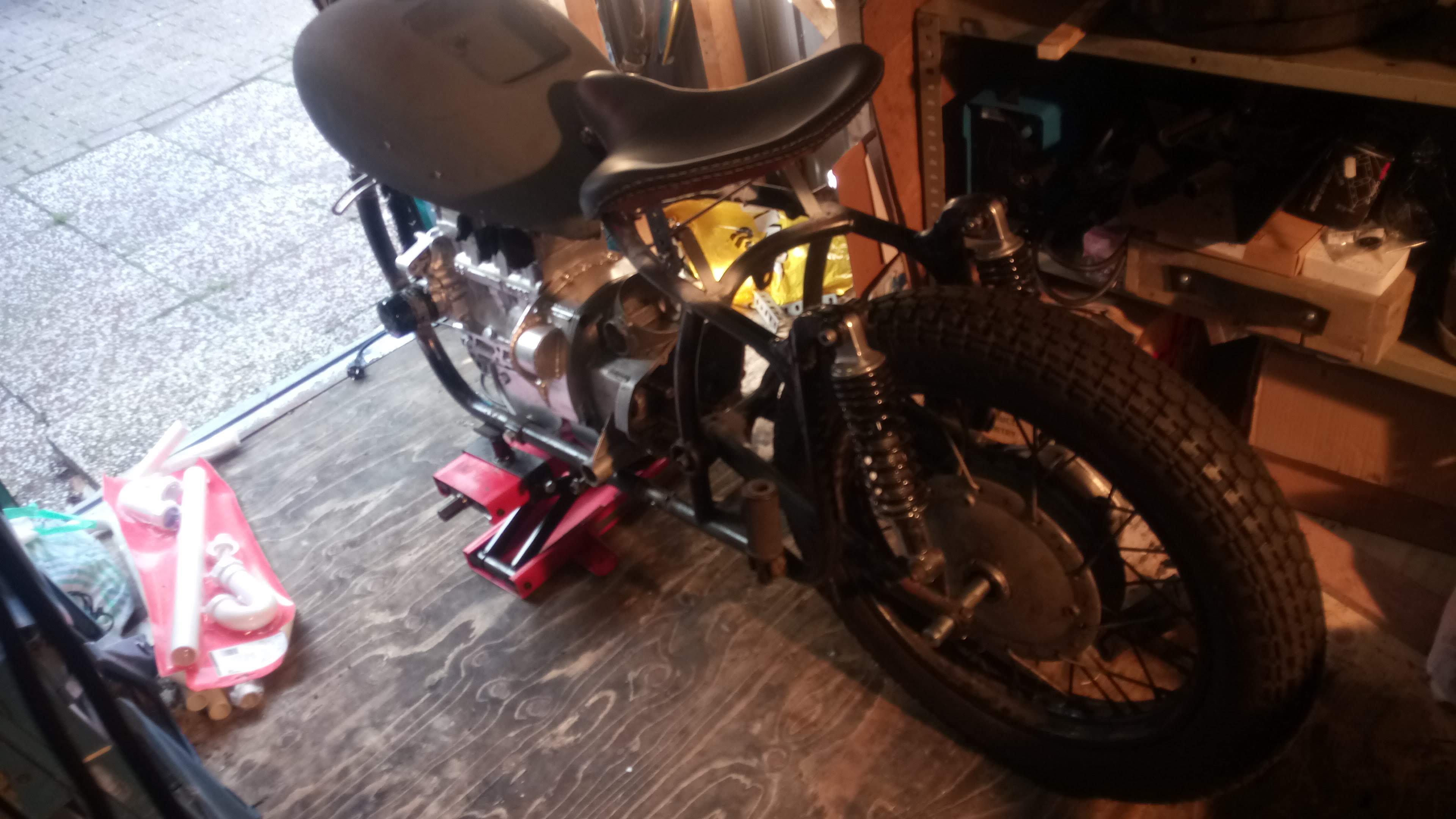

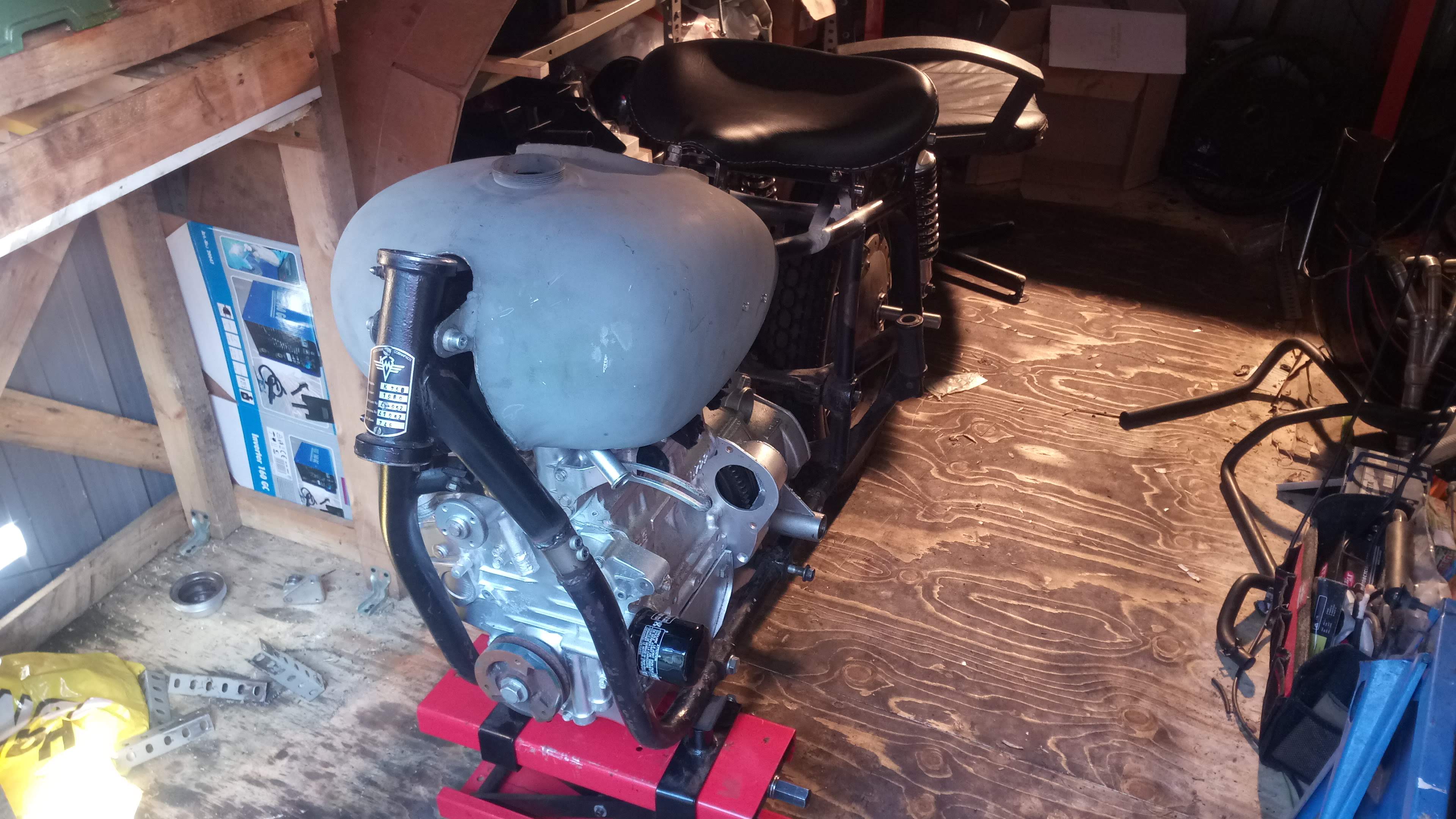

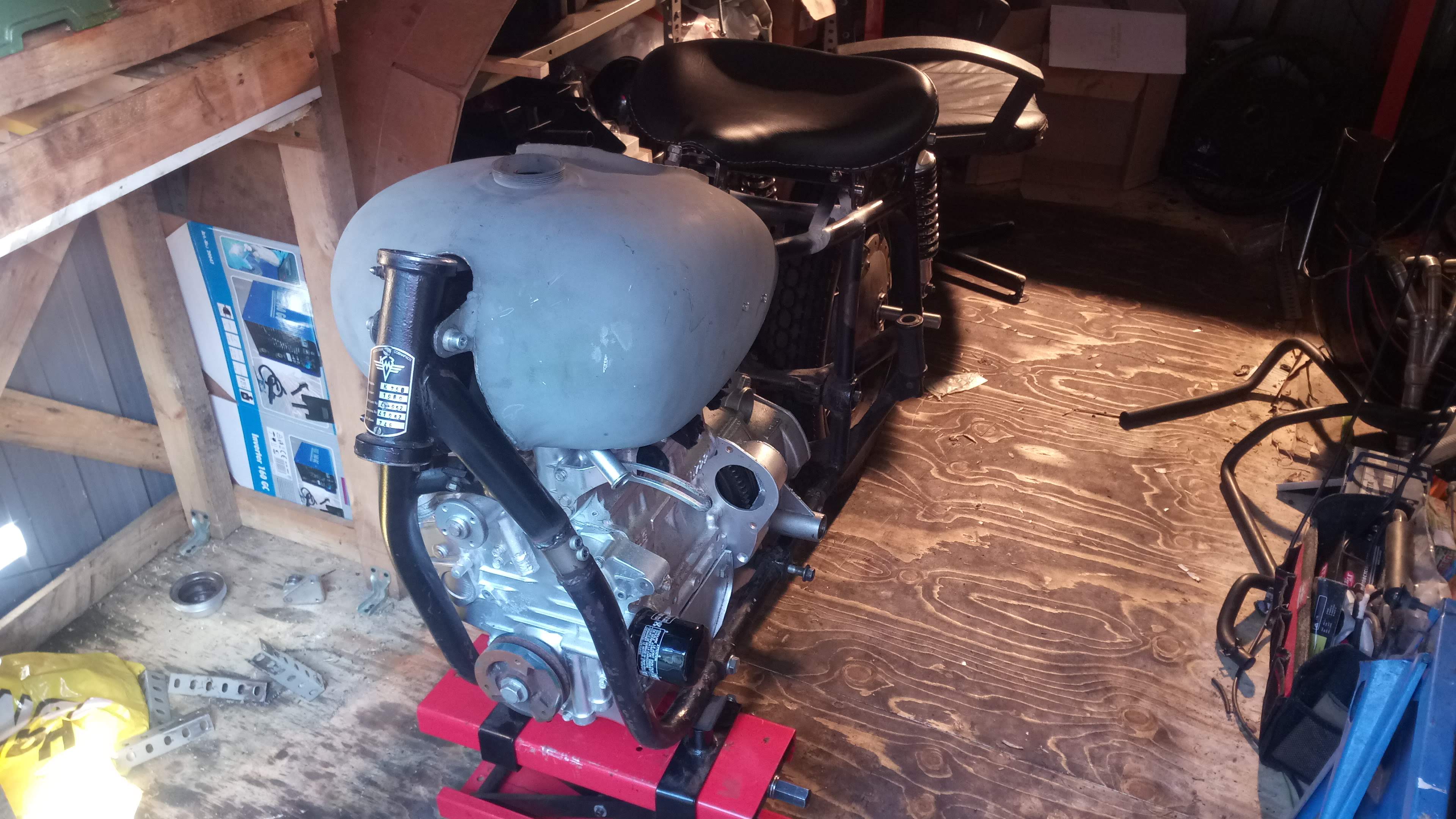

Welcome to the forum Cossack, best of luck with your build and permits.
Good to see another person attempting to build a bike on an Dnepr/Ural base. (I've been at it quite some time, neglecting my forum thread :oops: )
https://www.dieselbikeforum.com/viewtop ... d0ef536b93
