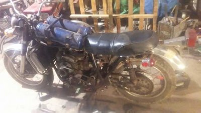

Re: Official "kuzuki" build
https://youtu.be/56RtdQZIgBI
I've made some real progress this month. I found a good set of air tanks that I'll use for fuel. I have the "clutch" set up (pictured is not what I'm using.) it's got all non essential equipment wired. Also My cooling system is only missing a pump. I also need to fabricate a whole new stainless steel exhaust
I drove it yesterday and i need to tweek the ratio. It only goes 45mph/72kph, and that just isn't enough, It's basically a giant minibike.
Although I only had a mile of road to work with and it felt like it had more to give.
