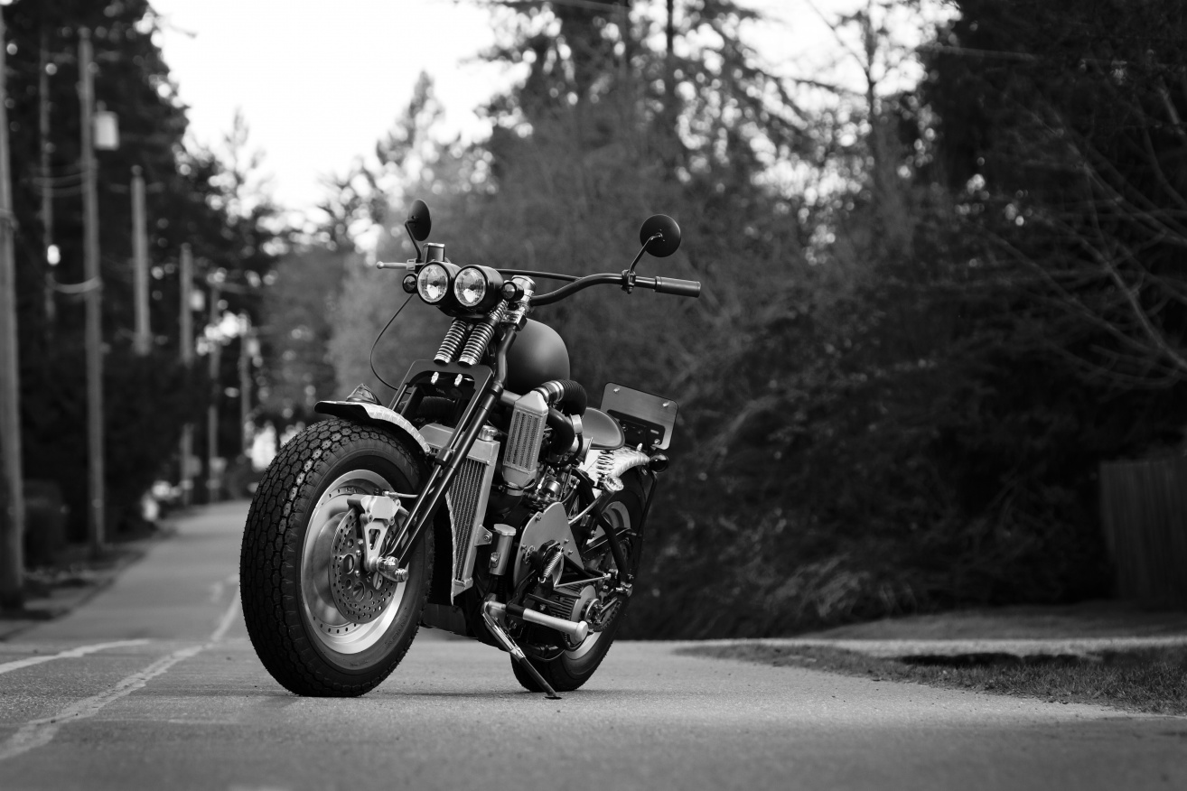

A buddy did some pictures for me

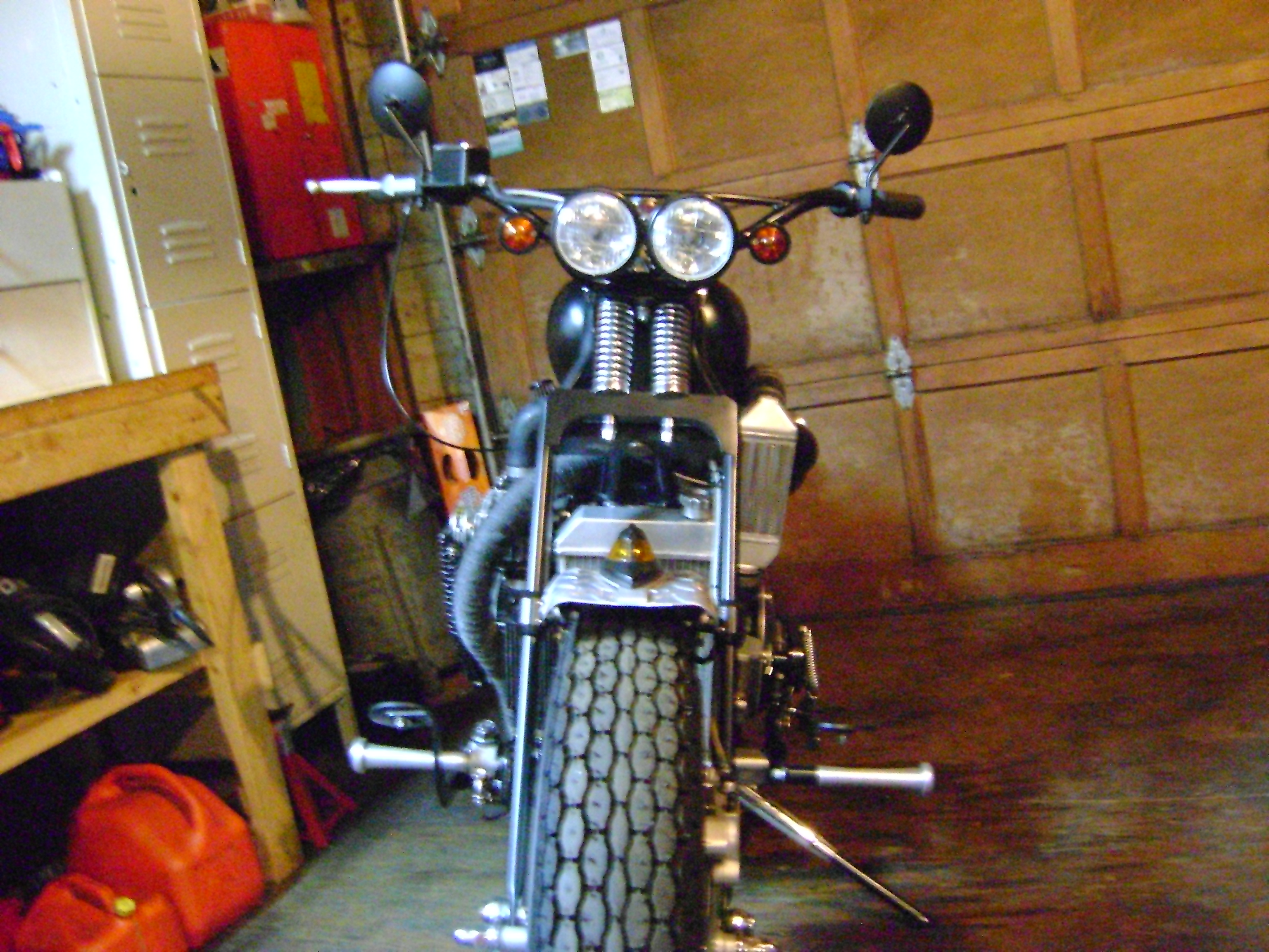

For Bill.
