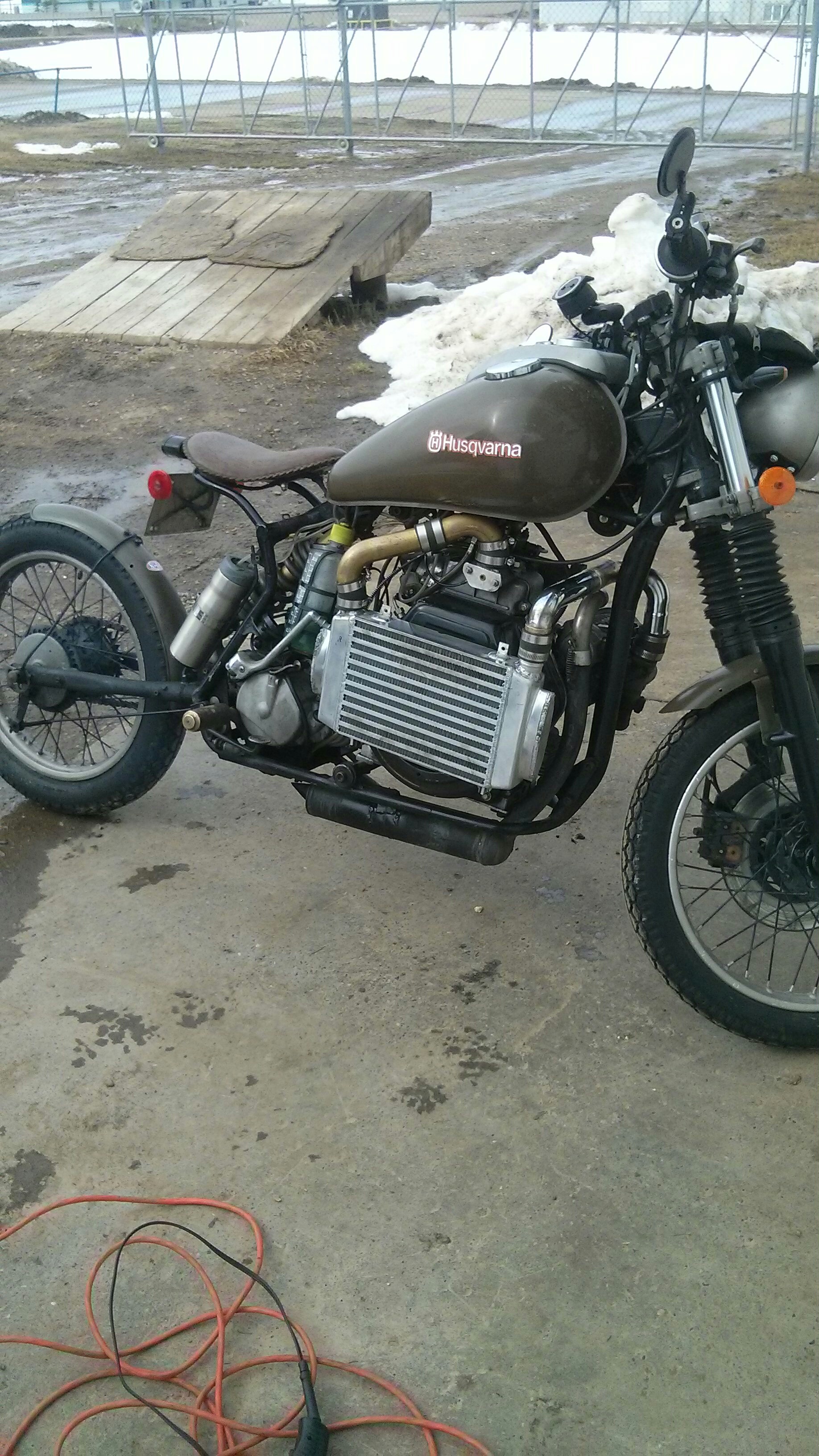

Re: Husqvarna supercharged 418 build
intercooler. works very well. still have to put a scoop over it ,but it sure makes a significant difference in air temp, and power.
here's a couple pictures of our bikes together Treg.
Sorry I never saw these pics earlier, i have been busy with small engine season and holidays etc. I'll post a video soon of the bike riding, it's not bad, just never seem to have or make time to wring it out properly, kinda pathetic I know, all that time and money to finish. I like your intercooler set up, notice a difference?

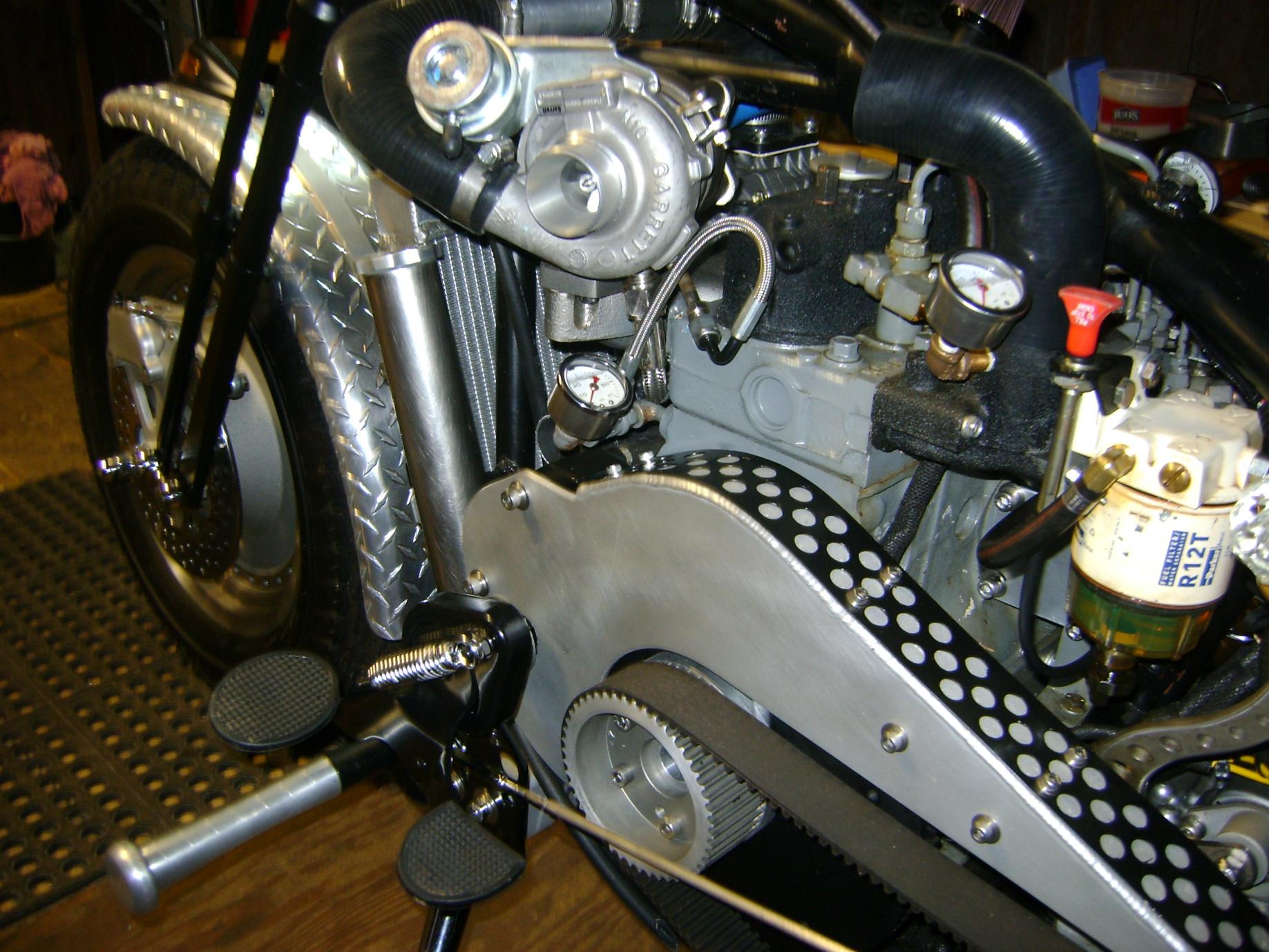

He started with a 418 yanclone but it was bad. He has swapped to something else... looks to be an iron block. Kubota maybe? Z482
We're dealing with 2 different bikes in these pics. The one has a 418 clone and the other a Kubota D950. The earlier 418 fell victim to starting fluid and the strain of turbocharging, but now back in service`Both bikes now sport superchargers and intercoolers.He started with a 418 yanclone but it was bad. He has swapped to something else... looks to be an iron block. Kubota maybe? Z482
I didn't mean to cause any confusion by posting a turbo shot of my bike for BoxerOtto, I didn't know he had a engine failure? Boxer what's the story?coachgeo wrote:He started with a 418 yanclone but it was bad. He has swapped to something else... looks to be an iron block. Kubota maybe? Z482
