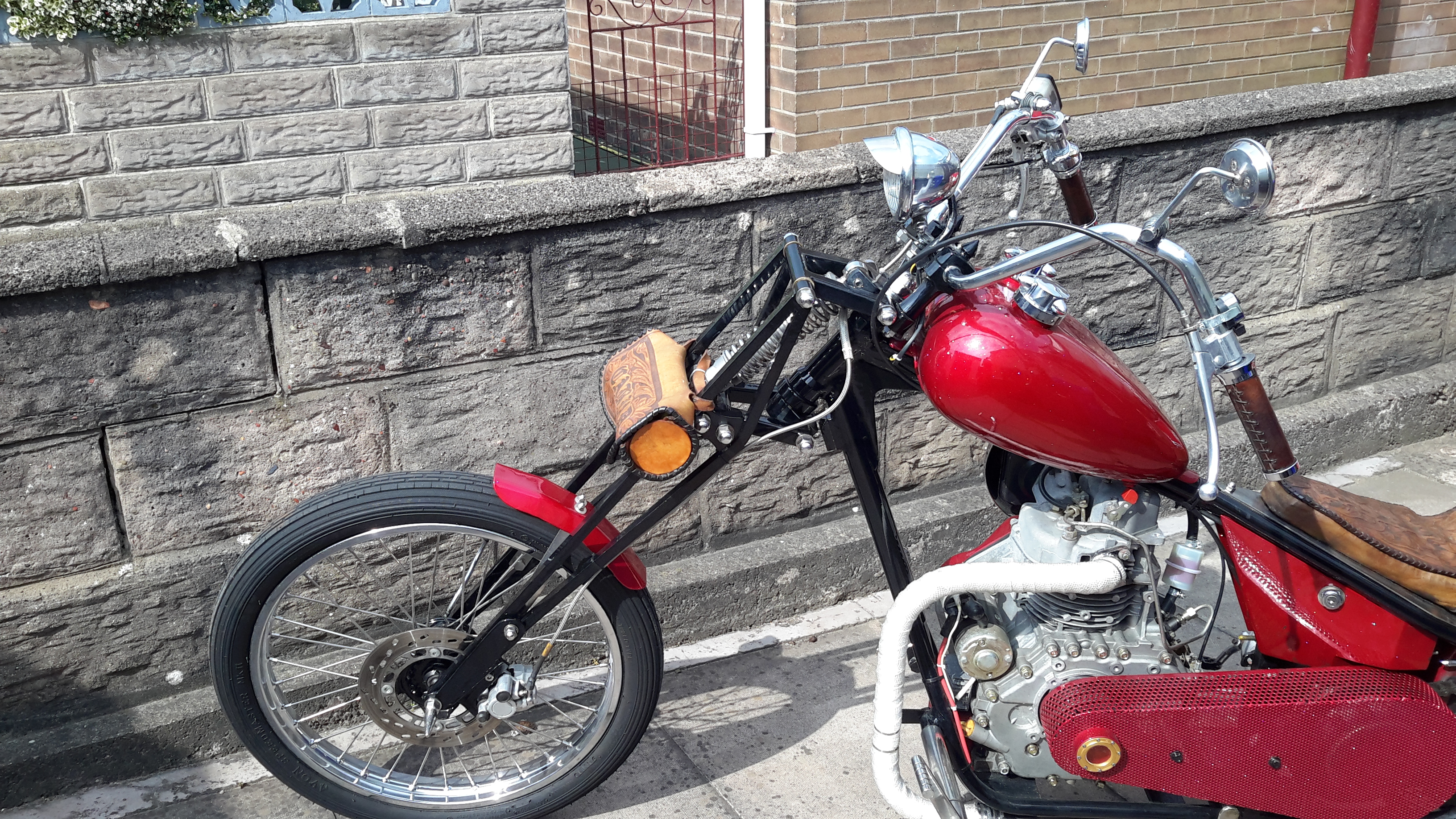

Have not posted for a while just thought I would show a few pics of my new build launtop 418 cc diesel engine be a a16 gearbox belt primary chain final sorry I put it on wrong page before do not know how to knock it of tony g

Cheers Alexanderfoti I noticed a mistake after posting it's a bsa a10 gear box and it's powder coated all over cheers tony g

I'm liking the left side shift. Most of us end up with an odd side right hand shift.
Re: New build
Hi Alexanderfoti the bike was left hand gear change it had a gs 750 engine so had to keep it left side change as the rear brake is on the right so machined two pillar blocks and two half shafts with a middle joint then welded a short lever on each one wich then connects with clevis joints each side works great and is adjustable tony g
