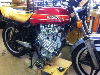

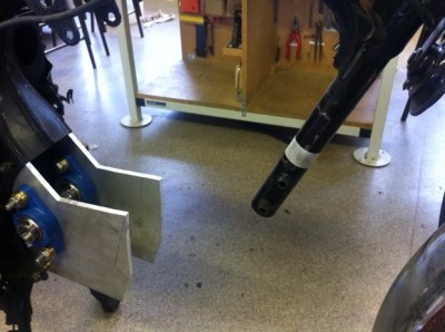

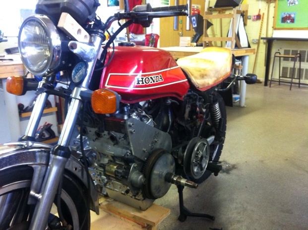

The staring point for me is creating the front engine mount , Similar to the last 3 diesel bikes I have made. This is allows for easy attachment to the front frame down tube with a good provision to adjust the position of the engine in the frame left to right for the belt alignment .
The engine is a D850 Kubota 3 cylinder engine , I purchased from a trailer refrigeration unit . The modification modification include replacing the standard water pump with a remote electric pump . This will reduce the overall width of the engine by around 100 mm.
I have reduced the flywheel diameter and weight by fitting one from a z482 engine this will lighten the flywheel if this will work . I will engineer the build so if necessary I can fit the original .

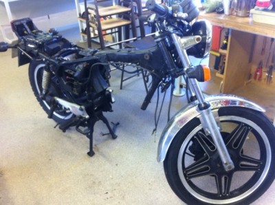

The next stage is to prepare the Superdream frame ready to take the engine . ......... ......to be continued .

I recon you right about the changing the flywheel , I have fitted a 2 cylinder Kubota flywheel which does also have 3 holes but I recon the are in a different position by about 15 degrees . I will proceed with caution and run trials to see the effect and if the vibration is unmanageable .
I was worried about clearance between the front wheel and starter hence using a smaller diameter to increase the gap .

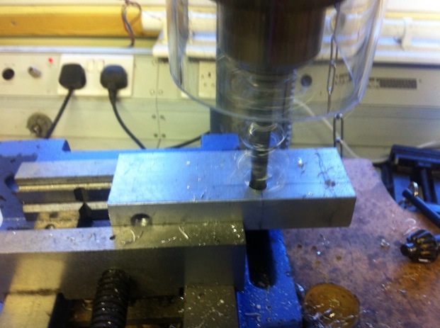

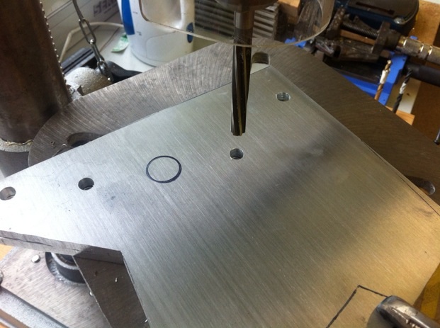

This is a simple operation as the 122 tooth m8 20 mm with pulley in the taper lock option is an exact fit over the sprocket boss on the rear wheel , it doesn't often happen like that ! The machining is only needed to lighten the pulley by about 1 1/2kgs by thinning it to around 4 mm thick and cutting sufficient clearance for the 4 attachment bolts that hold it on the rear hub. Using a 112 tooth and 22 tooth front pulley a 1695mm belt is a perfect fit not requiring modification to the swinging arm or the need a belt tensioner. The Center to Center belt calculator from the belt manufacture tells lies , it caused problems for me previously so check the length needed with a piece of string before ordering the belt,
The next job on the jack shaft will be to cut the 5mm keys lot with slot milling cutter .
The jack shaft bearings are for a 25mm shaft but the 2 flange holes for the bolts are 16mm diameter so I make a bronze bush to reduce them to 12 mm and then fit a 12mm shoulder bolt with a m10 thread. I will then ream the 10 mm hole in the engine plates to make them a snug fit .

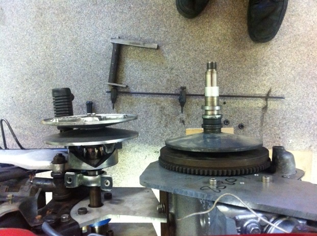

The top gauge is used to set the position of the end of the crank in relation to the CVT unit
The large tremal is to check the distance centre to centre of the crankshaft and jack shaft @ 320mm .
This is V important or the CVT will not function correctly . The additional bearing on the shaft is there as I may need to put in additional shaft support as the length of the shaft may create too higher loading on the inner bearing and shaft . Subject to testing I may not have to fit it . I think is going to be quite wide but I think it has the potential to look Ok . I may need to mount the alternator higher and move it closer to the centre of the engine to clear the rear brake . I now need to stew over it to tweak the position to ensure things like the oil filler can be accessed, weight distribution is reasonably balanced and the CVT will fit.

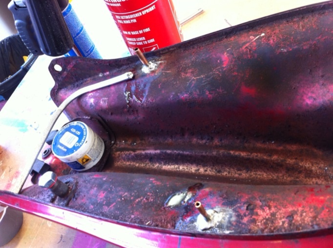

I am waiting for parts so to days efforts were on the fiddly bits such as the throttle and stop control .

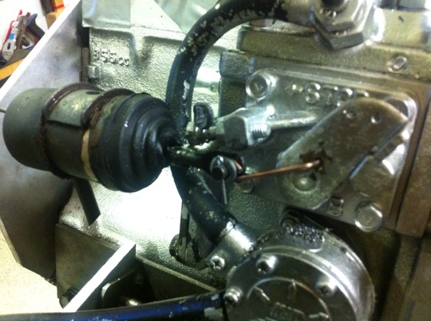

Why did you remove the water pump? Does it not stick out no more/less than the crank pulley you put the alternator on?Tim wrote:.....
download/file.php?id=1981&t=1
Re: Honda Kubota MK5
Hi there
The thinking being the bowl shaped pulley they use effectively adds around 80mm to the width of the engine at a point that stcks out visually . In addition I didn't want the shape of the belt run ie crank , alternator and pump triangle to dominate the looks of the engine . I have added a purely for looks alloy plate to enhance the pump area to match the cam cover shape . So being honest aesthetics is the main factor . However if The electrical pump has problems or can't keep up I guess the pulley one will magical reappear !
