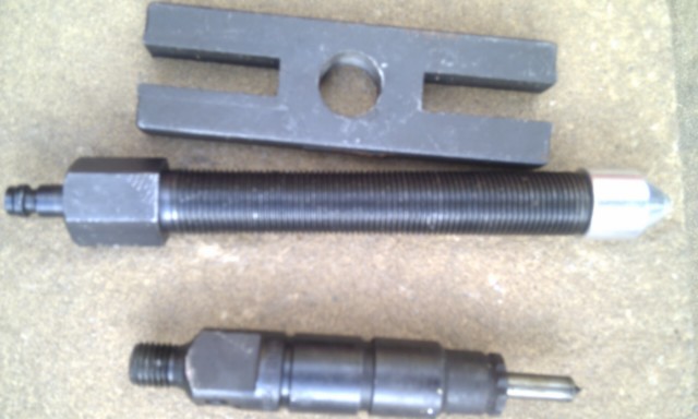

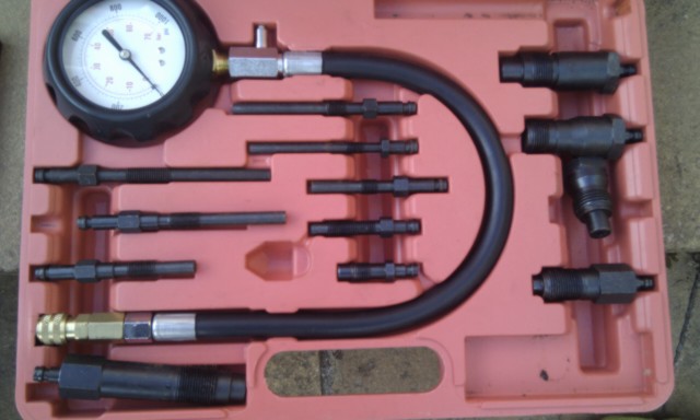

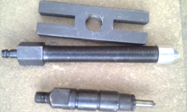

Academic now, as you've already diagnosed it. but for future ref, Last year I bought a comp. tester kit off of evilbay which came with adapters, I used it to test my Rugger MD150 with this adapter which replaces the injector. Not sure which injectors your RD uses, but here's the numbers off one of mine. C91 CKLL66P 12170. I've added a pic of the kit and the adapter next to the injector. Can't recall exactly, but I only paid about £35 for the whole kit!

Redkite wrote:Hi Ian, Amazing it still performs so well on one (and a half) pot?!
Bob.
I once got what appears to be an identical set from Harbor Freight.
