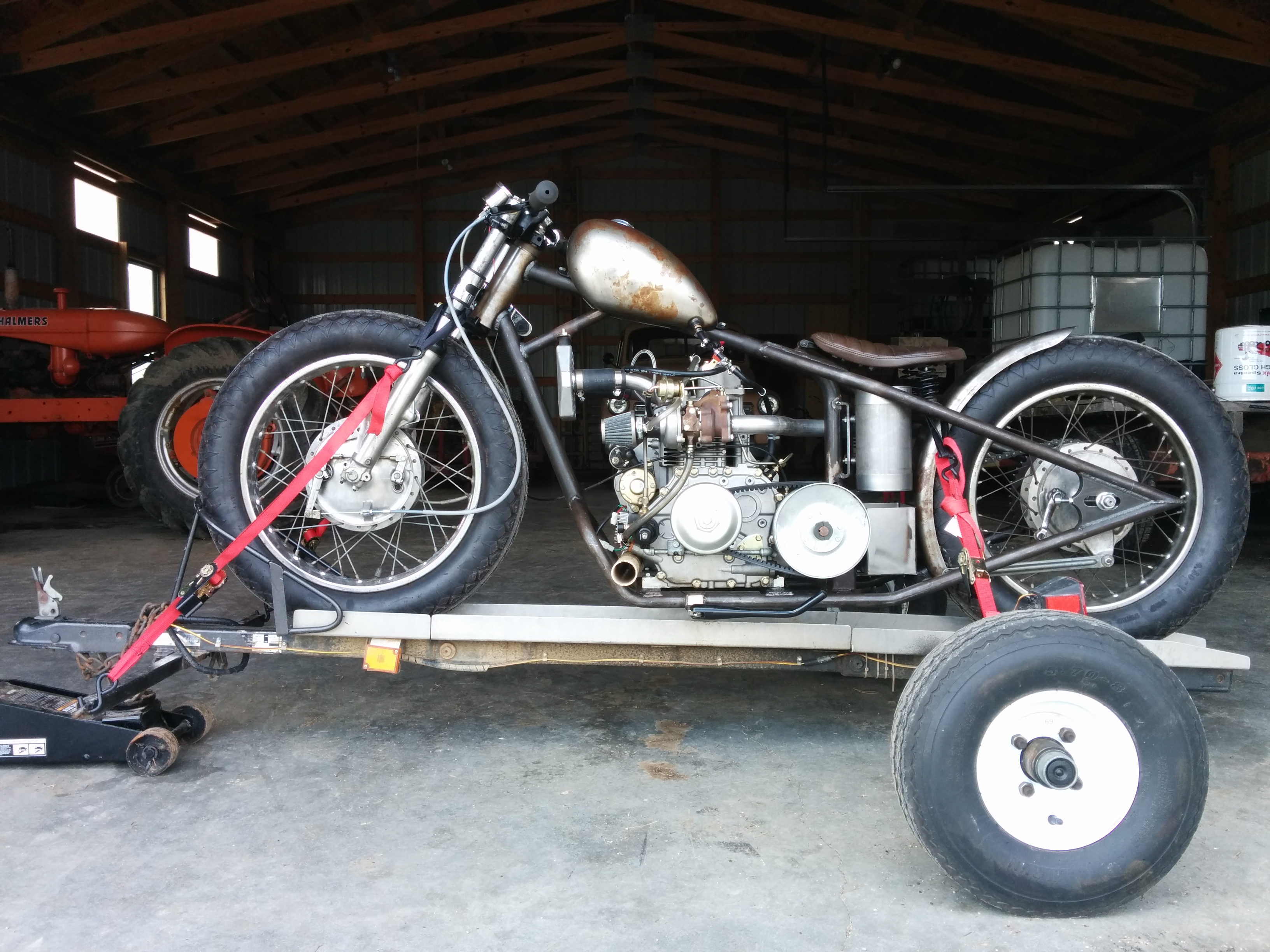

Looks good so far. Its amazing how much these little turbos whip up the oil. If you can use a piece of copper tube or something like it on your turbo return it will help dump some heat out of the return oil
radicalnegative1 wrote:Latest development:
http://www.youtube.com/watch?v=Fwfe4LhJDqY
Does everything look ok?

Re: Diesel Single Bobber Build
Once I get a driver/driven combo I'll cobble up a more permanent oil return line.
I also did the PCV valve modification described by some guy on YouTube. Pretty straightforward, actually. Everything came out great.
Next is the plenum chamber.

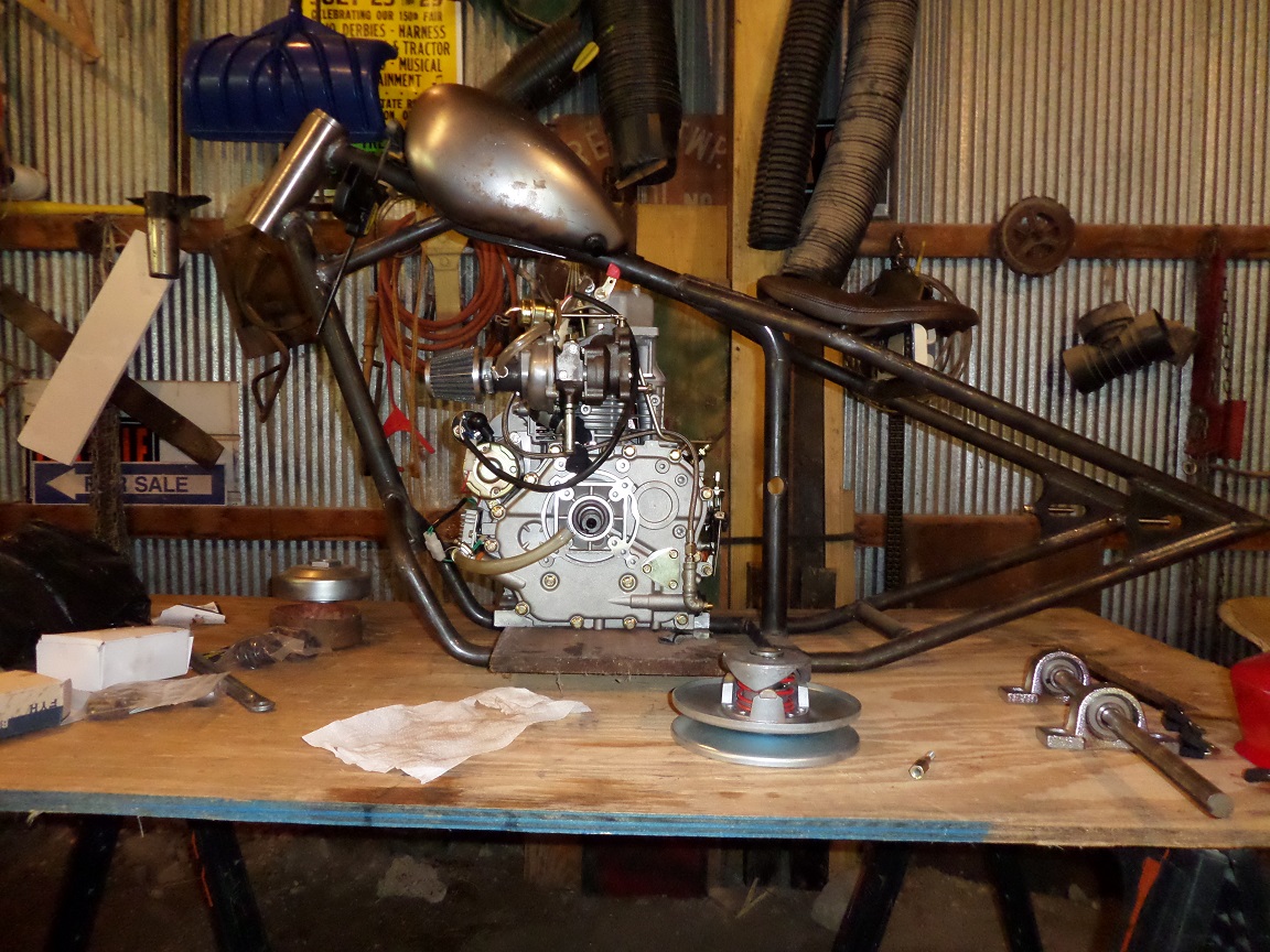

Here we go - some updates finally.
I can't weld well. I'm working on it, but I don't trust my 'skills' at all. So I've been saving up money and went with a custom frame builder, Cycle One Manufacturing, to build me a frame.

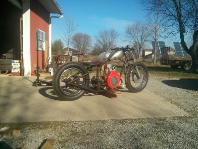

Just a shot of a rideable mockup I did over thanksgiving. So much more work needs to be done, but progress is being made.
