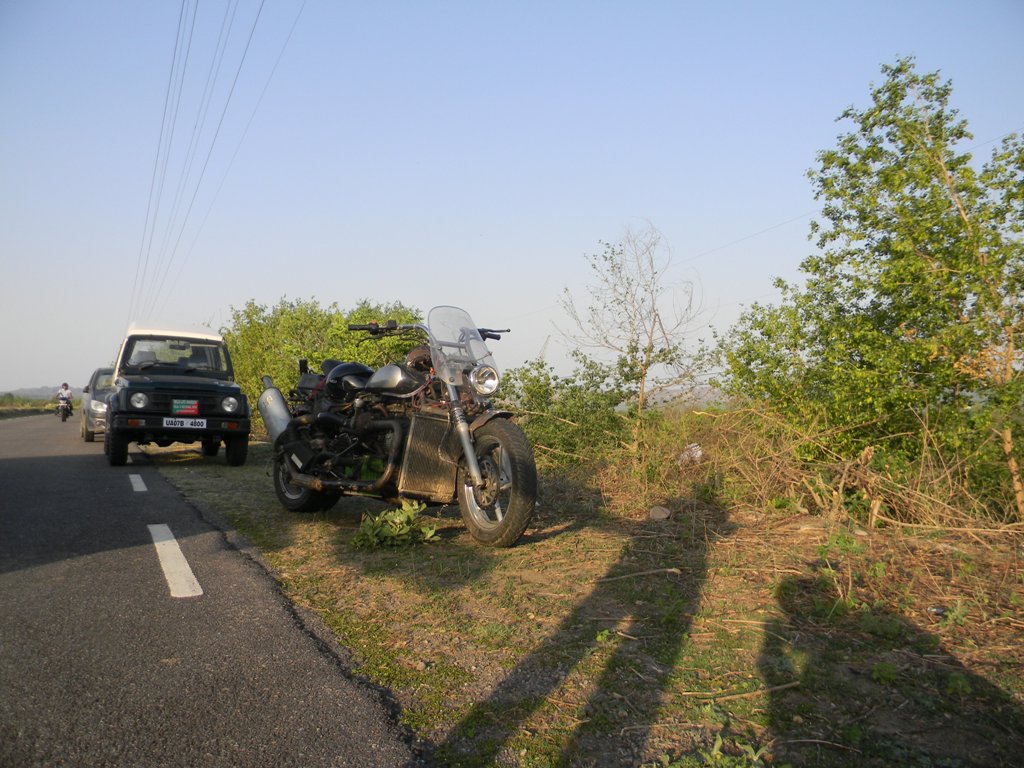

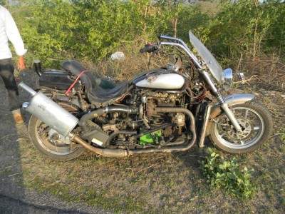

old pic, few more updates have been done. shame that i had to move out of my hometown for a job . lot of finishing jobs still remains .

some pics from a test run a last month

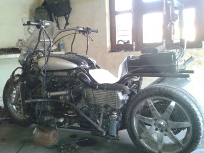

Neway whatever money has been spent on this bike has gone into gearbox and nothing else
No, bike would not look like the one in the pic. That pic can only give you some idea of wheelbase and seat height. Its build to test the drive train , I frequently need to open up the gearbox /drive shaft so dint bother to make the other bit just yet.
