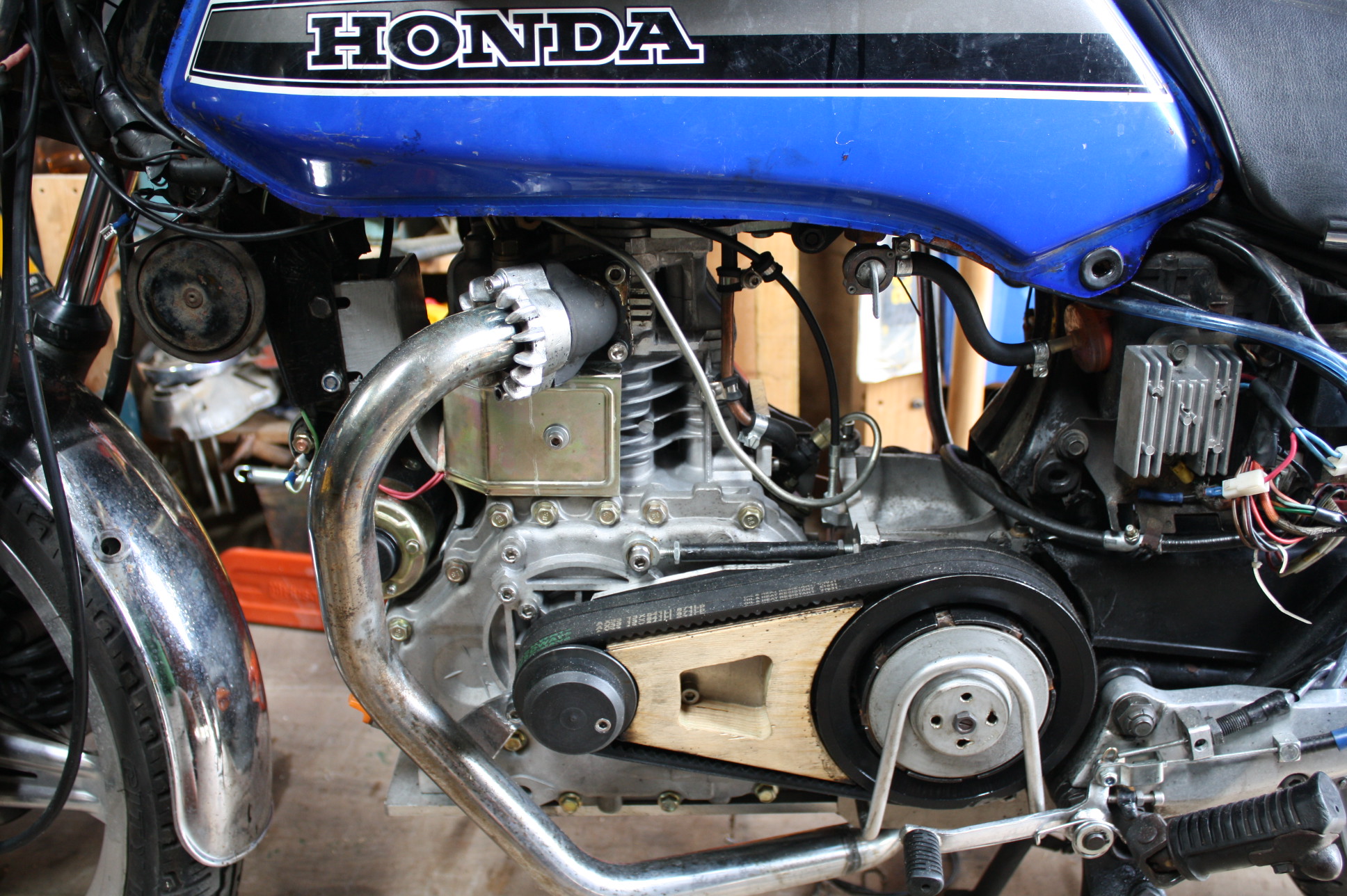

For the bike I have just completed I have used a villiers 2T / 4T 4 speed gearbox.I like the box as it is compact and easy to mount onto the Yanmar type engines as the front of the box is a flat surface and is a. The clutch is readily convertible to a dry belt drive of the "V" type rather than a timing type belt as it is more forgiving and cheaper + larger range of belt sizes available
The mainsaft length means the engine need to be mounted slightly off-center in the frame by about 20mm
All parts of the gear box are available from http://www.villiers.info/ site and are reasonably priced
Good bits
The drive is based on "A" section (With of the belt) and is a friction type drive so absorbs shock loading from the engine at low speed / RPM giving a smooth ride even down to idle speed
I based the system on low cost Fenner type taperlock pulleys available from Bearingboys http://www.bearingboys.co.uk the taper lock system doesn’t require a keyway on the engine shaft so taper type engine can be readily used
Good alignment is desirable however the belt can work with as much as 5mm misalignment
Only basic machining is needed to convert the wet clutch to dry clutch
Very low noise compared with chain drive

Mounting Plates
As the Honda Superdream frame is a spine type frame . I chose to create a aluminium L plate to mount under the engine on the existing bolts and mount the gearbox. I used 12mm Aluminium plate and chose to use shoulder bolts to join the two pieces but they could be welded. The gearbox has a flat front face making the job simple and aluminium can be ready cut using a wood work type bandsaw.
The engine holes are slotted to allow belt tension adjustment (15mm) and at the top of the gearbox a rose joint to help support the box and assist in tensioning the belts.

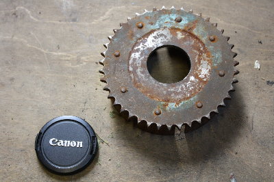

The Clutch
The clutch basket and sprocket are riveted together I drilled these out and machined the pulley to fit over the existing sprocket , care taken to ensure the middle of the 3 belt groves is in line with the middle of the old sprocket to ensure no undue stress loading is placed on the centre bearing . the assembly can then be re-riveted together.
This is a wet type clutch, the plates perform better dry however the original supporting rollers in the centre don’t! the 47mm sealed bearing is fits in to the centre of the original clutch drum but you need to make up a new centre to fit the bearing (See Photo)
The centre support hub that mounts the drum onto the mainshaft and is the inner bearing surface for the rollers is need to be machined down to fit inside the sealed bearing. Being tempered steel unless you have access to grinder this is difficult. As this is not splined I machined a new centre up from a sacrificial sprocket.
I was concerned that the small 47mm bearing may struggle to support the drum and belts so I used 3mm PTFE plastic sheet to make a circular shim one for each side if the drum to prevent any lateral loading to the bearing and support the drum alignment. This also sorted out the difference in the new bearing being wider than the old rollers . I did drill and fit a grease nipple that is accessed between the final drive sprocket and the new centre.
How well does this all work?
My concerns over belt tension Vs slippage Vs overloading the bearing were unfounded and I currently run the belts very lightly tensioned and there is no indication of slippage or pulleys running excessively hot.
Tensioning the belts only requires fraction of a mm movement and haven’t need to adjust them since fitting (Currently 200 miles)
Will the slip in torrential rain? Unknown but I am a fair weather biker so I will never know , I guess you could easily make up a shield to keep the worst off.
Noise is virtually silent
Clutch performance, I used clutch plates that would be long past there service life in wet / oil use and after an initial setting in period they function well giving a light clutch and no slippage / temperature rise on the steepest of hills. There may be issues in heavy / urban use unless the air flow is sufficient to cool the clutch – I will report this when I find out
The best bit is I can glance down and take great pleasure in watching the belts rushing around the pulleys when riding along, how sad is that?
