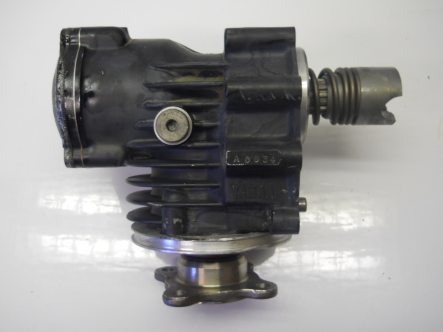

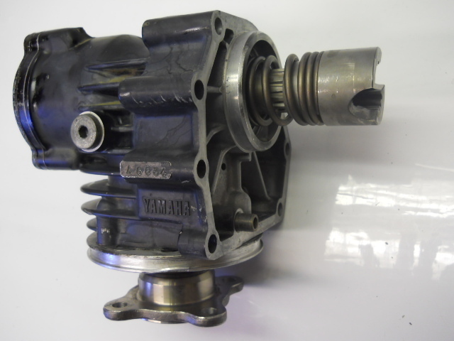

Another option to consider: There are many Japanese made bikes that have transverse engines and are shaft drive. In these bikes there is a bevel gear at the output of the transmission that usually has a ratio of between 1:3 and 1:1.1. These are referred to as the middle drive gear set or middle bevel gears and usually come in a separate housing that is smaller and made of aluminum so much lighter than some of the agricultural alternatives being discussed. Also they are rated for the conastnt acceleration and rotational speeds of motorcycles (industrial boxes can suffer from high drag forces at elevated rpm’s due to the use of heaver seals, and oil levels that run a much as 1/3 of lower portion of the gears through 90w gear oil). They are also designed to run this way for 100K+ miles.
Oh, and on EBay they are cheap. There are many options and good ones are $40 to $100
http://www.ebay.com/itm/Yamaha-XS750-XS ... db&vxp=mtr
Or if you want something even more robust you can use a set from a Kawasaki ZG1400 which is what I’m using on the Bonneville bike (in my own custom housing)
Peter~
coachgeo wrote:below info added by moderater (coachgeo) since the ebay link will be of use only very limited time. Info is from Ebay ad linked above:
Yamaha XS750 XS 750 #2317 Middle Drive / Bevel Gears / Driven Gears (Sold by the Cycle Barn, http://myworld.ebay.com/thecyclebarn1?_ ... 7675.l2559 )
The Cycle Barn wrote:the items for sale are the 1977 Yamaha XS 750 - Middle Drive Gears. They are in good usable condition. They came from a motorcycle that showed just over 25,000 miles on the odometer. Everything shown in the photos is included and in good usable condition. (LJ 12)
