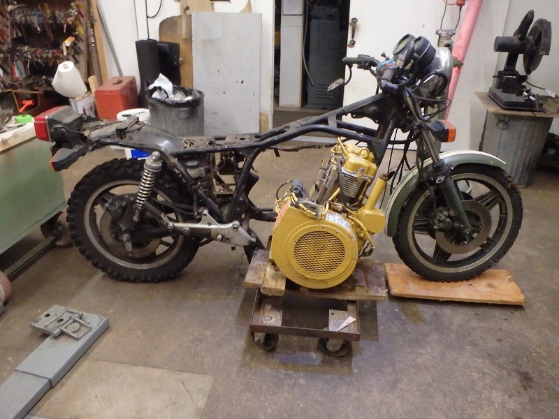

Well, not much more progress to report, but I did get the bike moved in to the shop. Started taking off extraneous pieces (That was a big clunky air intake!), and the hatz is starting to look like a respectable motorcycle engine!
Got the bike propped up a bit, and the motor tilted on its frame, and it almost looks finished!
Seems like there's going to be plenty of room - the subframe is really only going to have to lower the engine an inch or two for everything to fit nicely. Glad I found this donor!

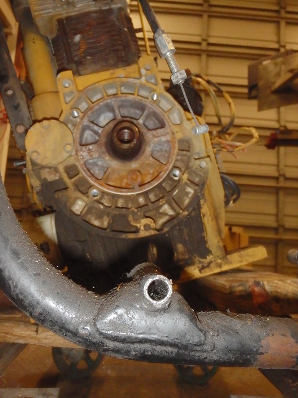

And here's a power-side view. Won't know exactly where this engine is going until I can get my hands on the CVT, but it looks like there'll be plenty of room.

Re: HondaCB+Hatz Scrambler project
Can I give you a word of advice.
Before you mount the engine get your rear pulley mounted and make sure it clears everything in the fully open position.
Include any brackets and footpegs.
The reasoning is that the rear pulley will determine alignment of the engine.
I fitted a cvt to mine and it was only after mounting the engine I found that the rear pulley fouled the stand spring when fully open.
Obviously you'll be using a jackshaft so it can be slid in/out until correct.
The engine is mounted on its feet so all you need is a basic flat plate and the engine can be moved about until you are happy before actually drilling/cutting "hard" mounts.
If you have to cut the front down tubes just make sure that you compress the forks and the front wheel clears the engine/brackets.

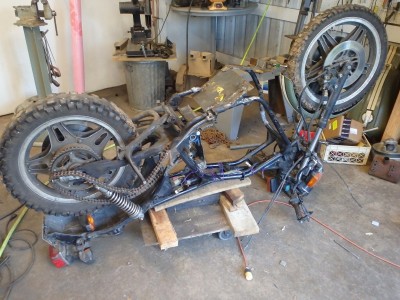

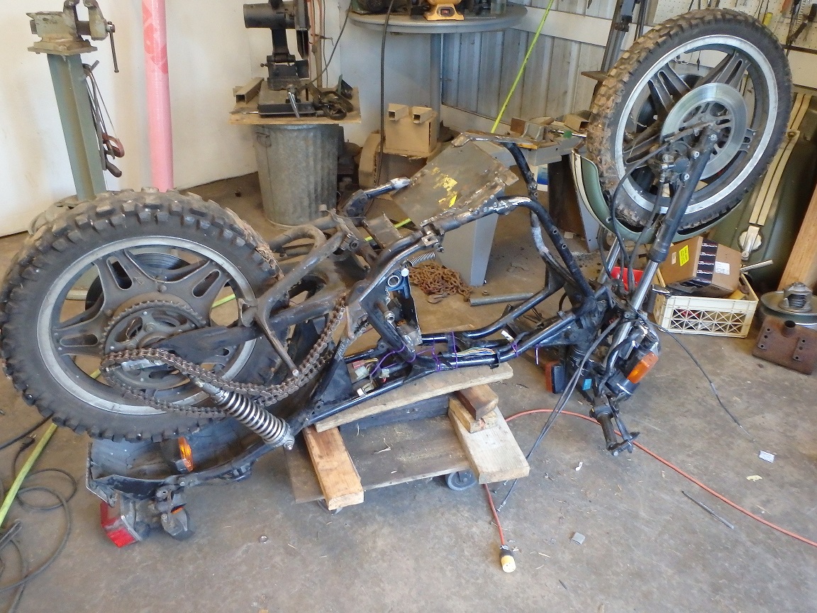

Alright - life has been busy, but I've got a couple hours on the train to update you all on where I'm at. Internet isn't good to upload pics - but those'll come soon. Life got derailed this week with my main ride (BMW f650) busting its radiator. Right after I put on new tires, of course! New radiator is on its way. Sometimes I hate german engineering.
The diesel bike is continuing, slowly but surely. I've got all the jackshaft material here - shaft, pillowblock bearings, shaft collars, so I'm looking forward to installing that - still got some clearance issues to work out there with the CVT driven pulley movement, but there's enough extra material on the frame in that location that I think I've got plenty of room to keep chopping out bits
The engine mounting plate is in location, and leveled. It's just got some tack welds, but it's already feeling pretty solid. I'm really thankful for whatever luck I had when I found the donor bike - the engine's got plenty of room, and I only had to drop it down a couple inches. It's got a nice forward lean too (within specs) - so that'll give it a nice look I think. I've got bolt holes more or less located, although I'm sure i'll have to mess with them a bit to get the engine true to the frame. I'm going to wait on that until I can figure out more about cvt belt length availability so I can judge center-center distances between the pulleys better. I've found a nice equation to calculate center-center distance from a golf-cart modding forum:

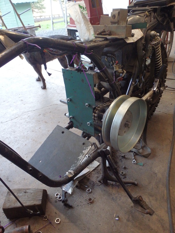

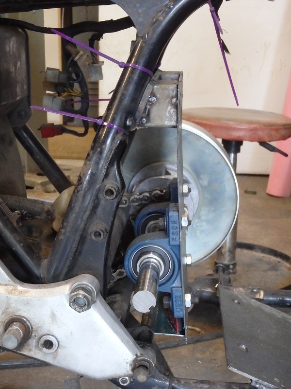

Alright - here's the progress with pics so far!
I got the engine baseplate tacked on before - it still needs some adjusting to get the motor in place and lined up correctly. It's just tacked on for now while I figure that out (currently working on that). You can also see what I did just this past weekend - mounted the jackshaft and secondary CVT pulley. Everything is just tacked together right now - I still need to work on the bottom frame mount of the jackshaft a bit - it's just got a throughbolt through the original engine mounts holding it in place.
Here's a side view of the jackshaft. As you can see, it's not finished, but it's all where it needs to go!

Maybe Im not seeing it...... but how are you adjusting Jack shaft distance from Primary Pulley on engine for purpose of CVT belt remove/replace, along with tension adjustment?sideshow wrote:Alright - here's the progress with pics so far!.... Here's a side view of the jackshaft. As you can see, it's not finished, but it's all where it needs to go!
There is no adjustment for the belt as the distance is fixed.
Don't forget the pulleys are not fixed pulleys so the belt self adjusts as it wears.
What happens is that as it wears it starts to sit lower in the pulley and it also starts to affect the gearing but it doesn't slip.
These larger size CVT/belts do not wear as quickly as the smaller Comet types. The Aixam car belt changes were scheduled at 11000 mls so on a much lighter bike they should go on much longer.
Not sure about this type of system but in the workshop with the proper tools you can split the front pulley to change a belt but in an emergency how do you do it??
You change belts by opening the rear pulley causing the belt to go slack.
On the later CV Tech ones they had a threaded hole on the outer pulley half. You threaded in a bolt and this pushed the inner pulley open.
In practice it is possible to lift the belt on the pulley up to the edge and then twist it off the edge as you turn the engine/pulley by hand.
This has the effect of pulling the rear pulley open as the belt acts as a wedge on the rear pulley.
Think along the lines of tyre replacement or putting a slipped chain back on a cycle.
Many years ago I had a Daf car and it was possible to lie underneath and pull on the bottom run of the belt and rock it back and forward which worked it in to the rear pulley,opening it up,you could then have enough slack to take it off the front or rear pulley.

Your pics reminded me very much of how I mounted mine although I was struggling a bit with the MZ frame room wise lol
One thing I did do was weld the mounting plate on to the upright jackshaft plate in an "L" type configuration as I felt that it would tie the 2 elements together in a sort of old Brit bike unit/pre unit sort of way and be stronger.
If I've any criticism your jackshaft plating looks a little thin? I used 6mm or 1/4" on mine and that was only an 8hp single

Yup! plating seems a bit thin to me as well, but it's what I got lying around the shop. I'm going to get everything in place first, and then add bracing wherever possible. FWIW, the guru who's advising me seems to be totally unworried about it. We'll see what happens!
Just finished up releveling and adding a bit of bracing to the engine mount plate, so I'll be remounting the engine to adjust the hole pattern next! Moving along!
Thanks again for everybody's advice - everything is very much a learning experience for me right now!

Alright. Chugging along!
Had some difficulty with the different duster clutch models, but I finally got that sorted out, and the correct (I hope) adjustable one is in my possession.
Right now I'm working on the jackshaft and engine mount welds, which are somewhat daunting for a newish welder like myself. I'm pretty satisfied with the penetration I'm getting, so I know I'm safe, but there's a long way between safe and pretty for me!
The plates are already constructed and aligned, so we're just solidifying the welds right now.
Here we are with the bike upside down to finish up the welds more easily. Unfortunately about 2 min after I took this picture, the MIG wire spool ran out. Gotta go pick one up tomorrow!
After that it's time to remount the engine and check the CVT placement, so I can order a belt and get the crankshaft adapter made up. The taper at the end of the crankshaft is a large 1:5, so I've got to turn down something to fit into the more regular 1:20 taper on the duster clutch. Not sure, but I'm probably going to farm that out to a local machine shop. Not quite confident in my ability with the lathe to get that spot on, and I'd like to get this thing moving sooner rather than later.

Alright - long delay, but I've been busy. All the major pieces are in place - here's proof!
