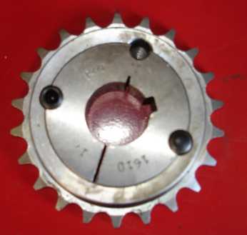

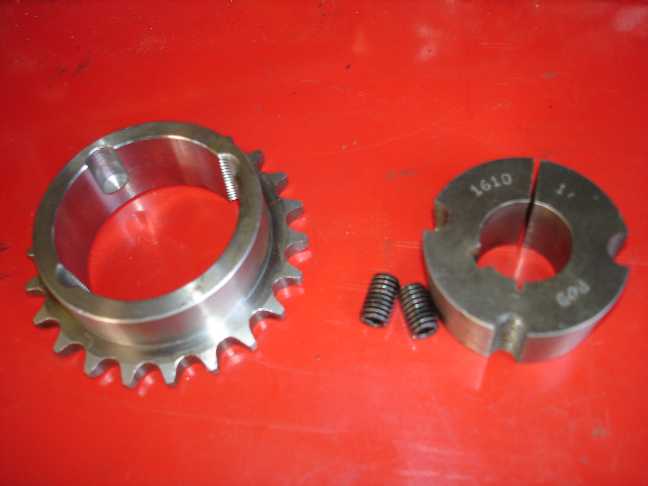

Thought I'd post up a couple of shots of Guzzi Ray's 1" taper lock he's using to start the final drive from his yanmar L70AE engine. It's a keyway shaft and takes various sprockets. These are a good solution if you're stuck for a way to come off the engine.
taper together

taper in bits
taper in bits

I love taperlock. Any size shaft to any size pulley/sprocket (within reason). Still adjustable for alignment after installation. Chop and change ratios. Cool stuff.
Is there info anywhere that would tell me what torque to put the screws up to?
