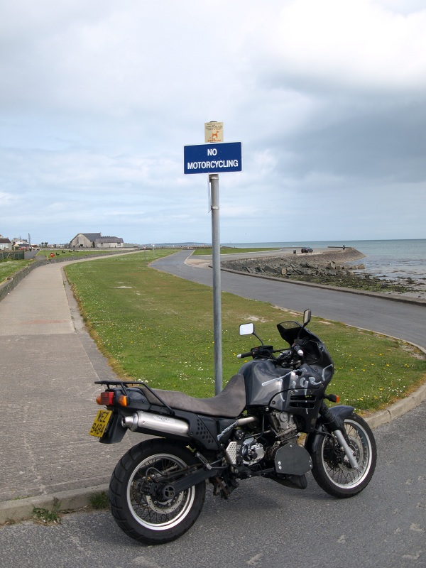

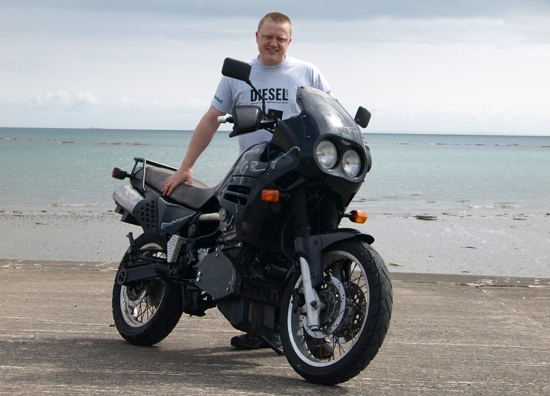

Just a note that my bike is on the road with 400 miles or so far since it went through MOT on Saturday. The guys at the test centre were a little confused but tested it none the less. Attached are a couple of pics. Still to paint the side covers and the other little things, but since it works good now I've not been off it for long enough to do them :)
So I'm taking it to a local show on Saturday. This would be a fair trip away for most of you but I will be at the big knock too (touches wood).
Still figuring out what she'll do fuel and speed wise, but looks promising so far. Hard to measure fuel economy by tank topping since a small measuring difference makes a big difference in the calculation. It really needs a full tank through it to work it out properly. I think the exhaust is quite restrictive so thats the next thing I am looking at. Changing this will probably increase speed and maybe also economy.

Cheers. Didn't even get a dig about the posey pic, must be ok :wink:
Ta for the suggestions on the can. I think I'll try it with the thing completely off. Its fairly simple to unbolt. The standard one is also pretty heavy! She'll be noisey but we'll see what difference it makes. Strangely I think it is noiser with the pipe on (no can) than with it straight out of the turbo with no pipe on! If no can seems to make a difference then I'll hunt for a micron or similar as suggested and keep the other one as it is with baffles since its pretty heavy.
